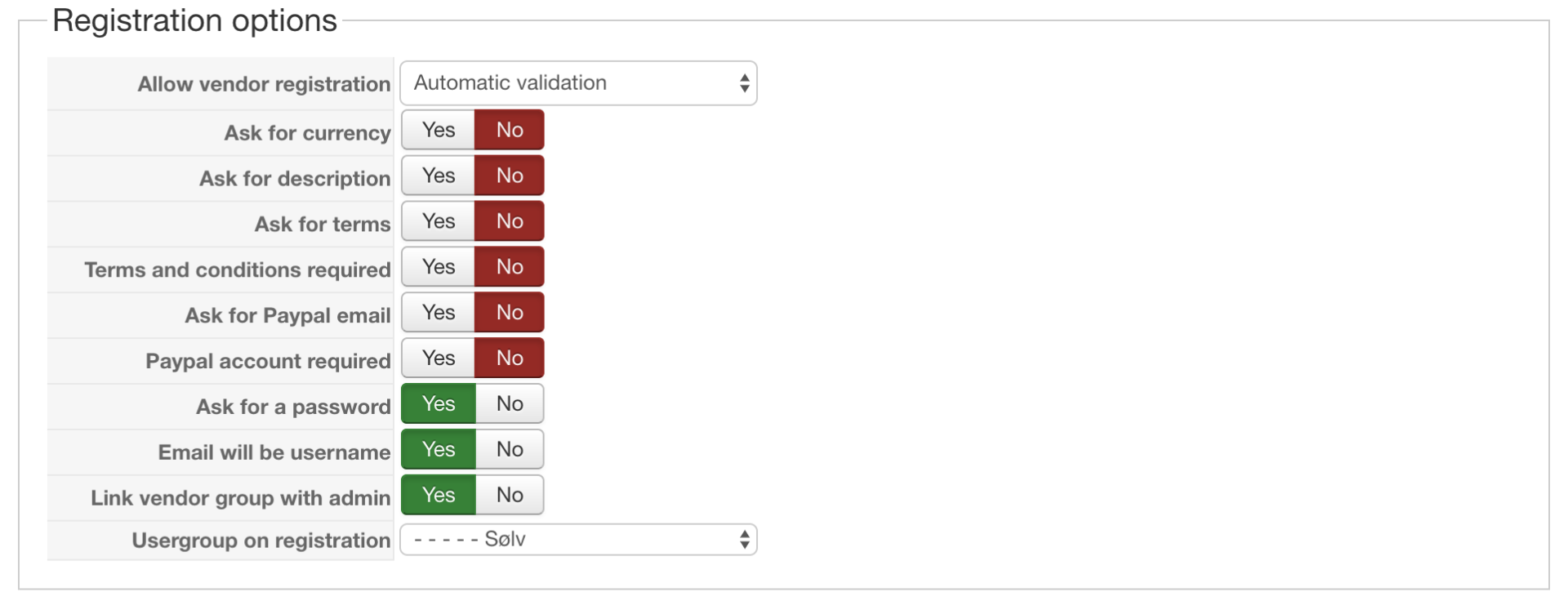

We are facing an issue where newly registered Vendors does not get the correct (any) group assigned.
What happens is the following:
1. Vendor registers

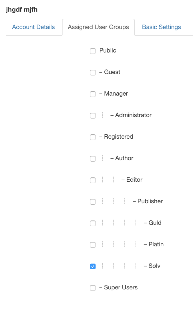

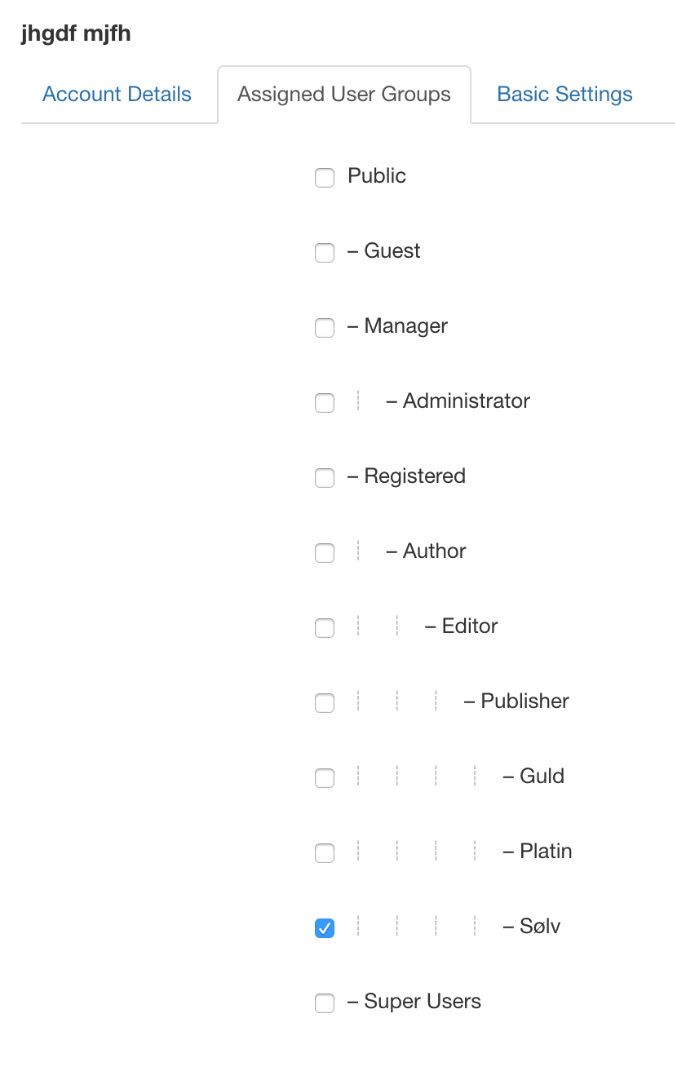

2. Joomla user is correctly created and placed in the User Group: Sølv (Silver)

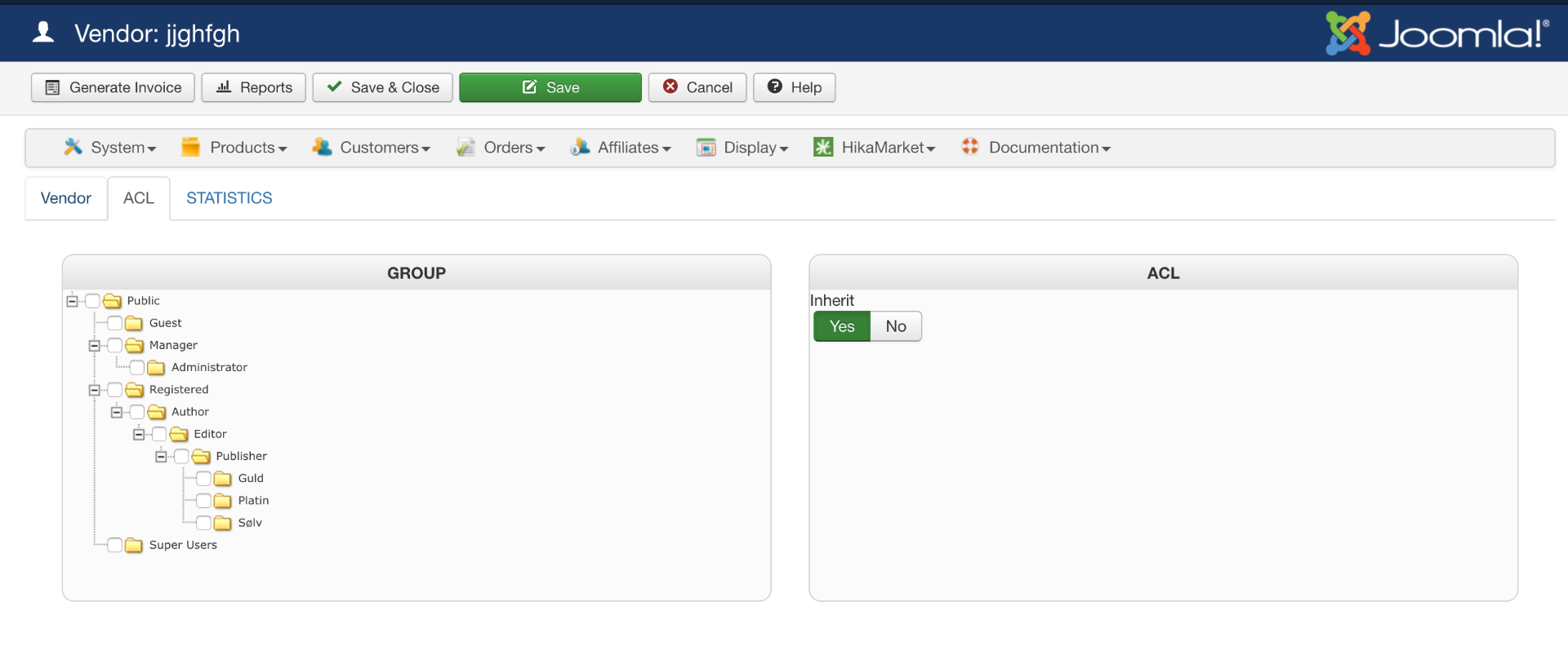

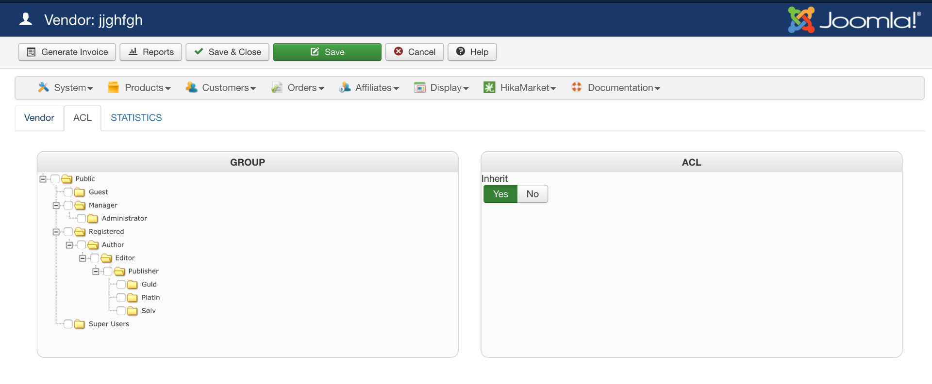

3. HikaMarket vendor user is correctly created but is not assigned any User Group.
If an administrator manually edits the Joomla user of the vendor, then suddenly the User Groups are synchronised.

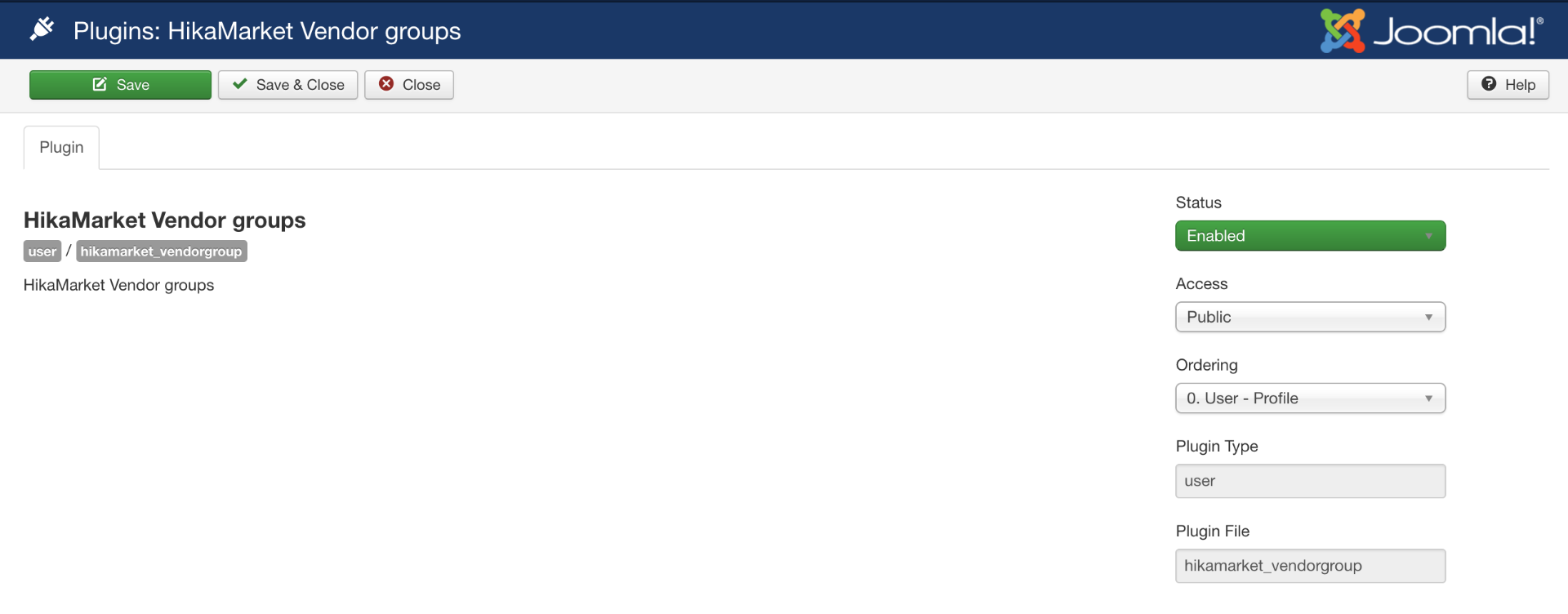

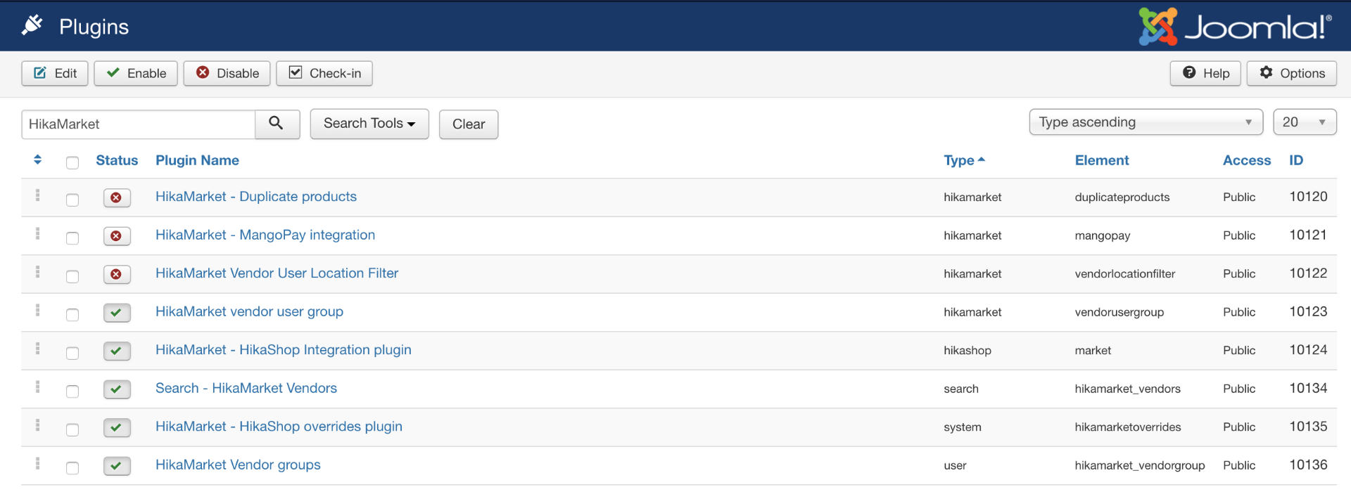

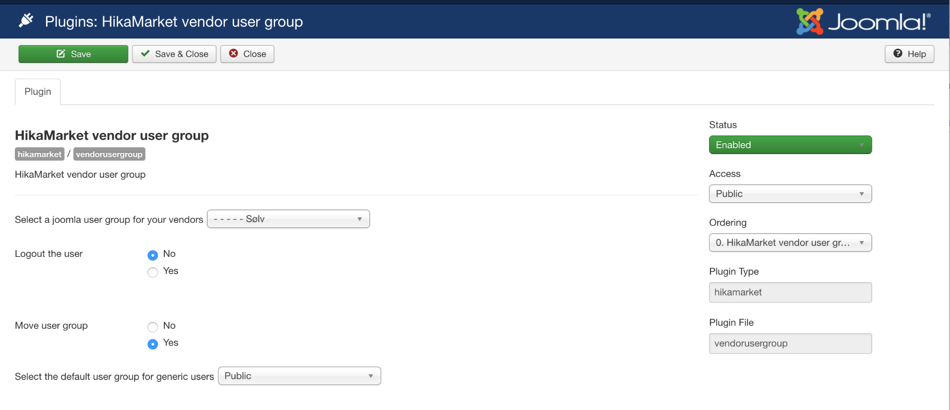

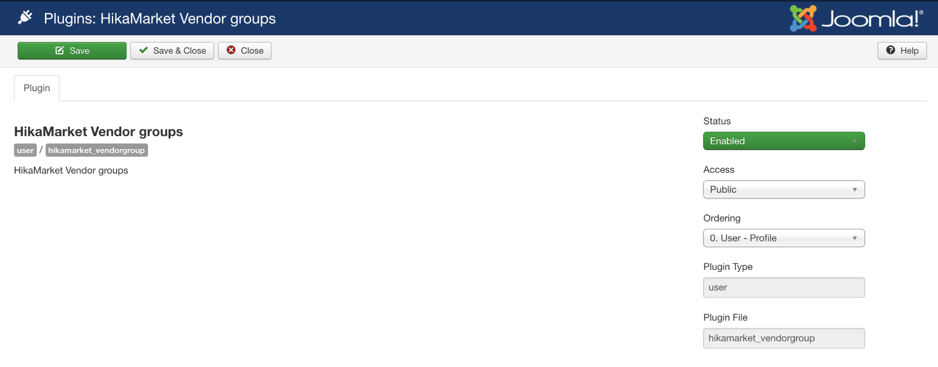

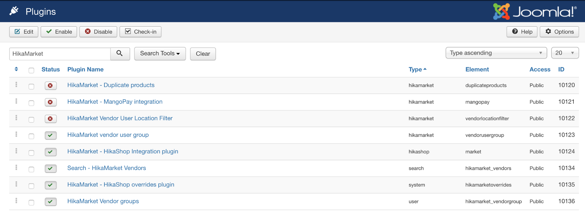

Plugins installed

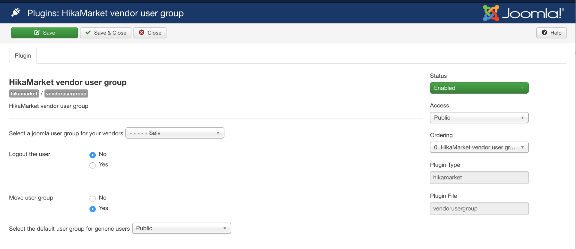

HikaMarket vendor user group
HikaMarket Vendor groups

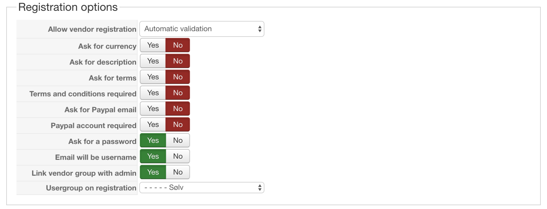

HikaMarket Configuration Registration Options
Joomla User Group
HikaMarket Vendor ACL

When you're using the HikaMarket registration page, the Joomla account is created before the vendor one.
But, the synchronization is made when a user is created or modified ; so the moment when the user is created, before you're in the registration process, the vendor account is not created (and do not exist, yet) so the synchronization cannot be done.
That's also why, when you edit the user afterwards, the sync is made and the vendor account receive the right user groups.
I will add a patch in HikaMarket registration process in order to read the Joomla account groups during the vendor account registration.
