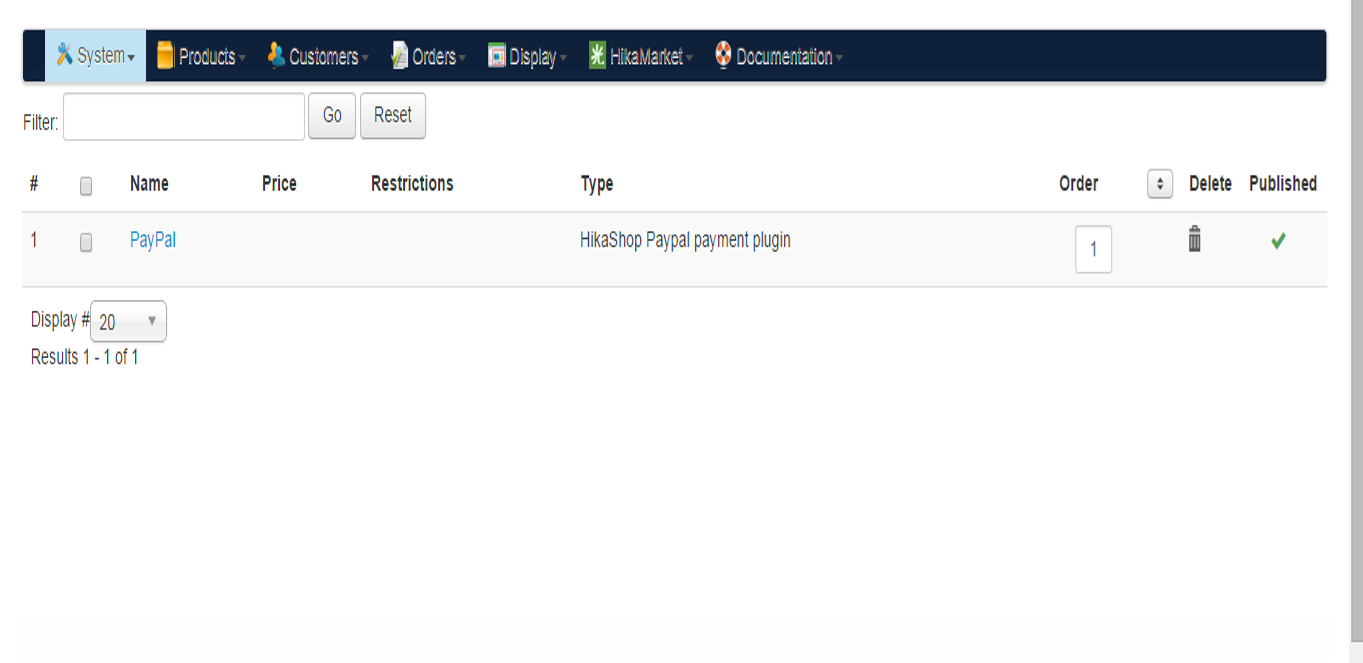

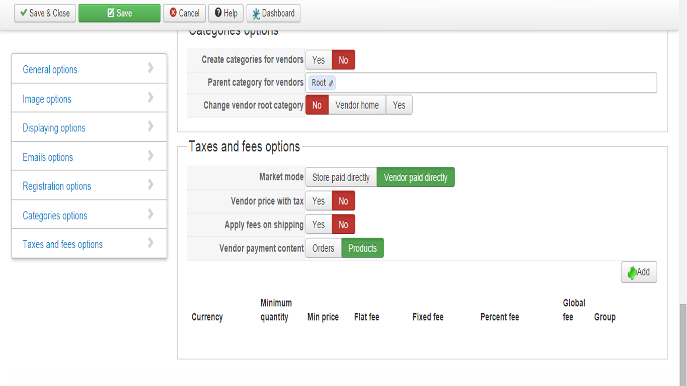

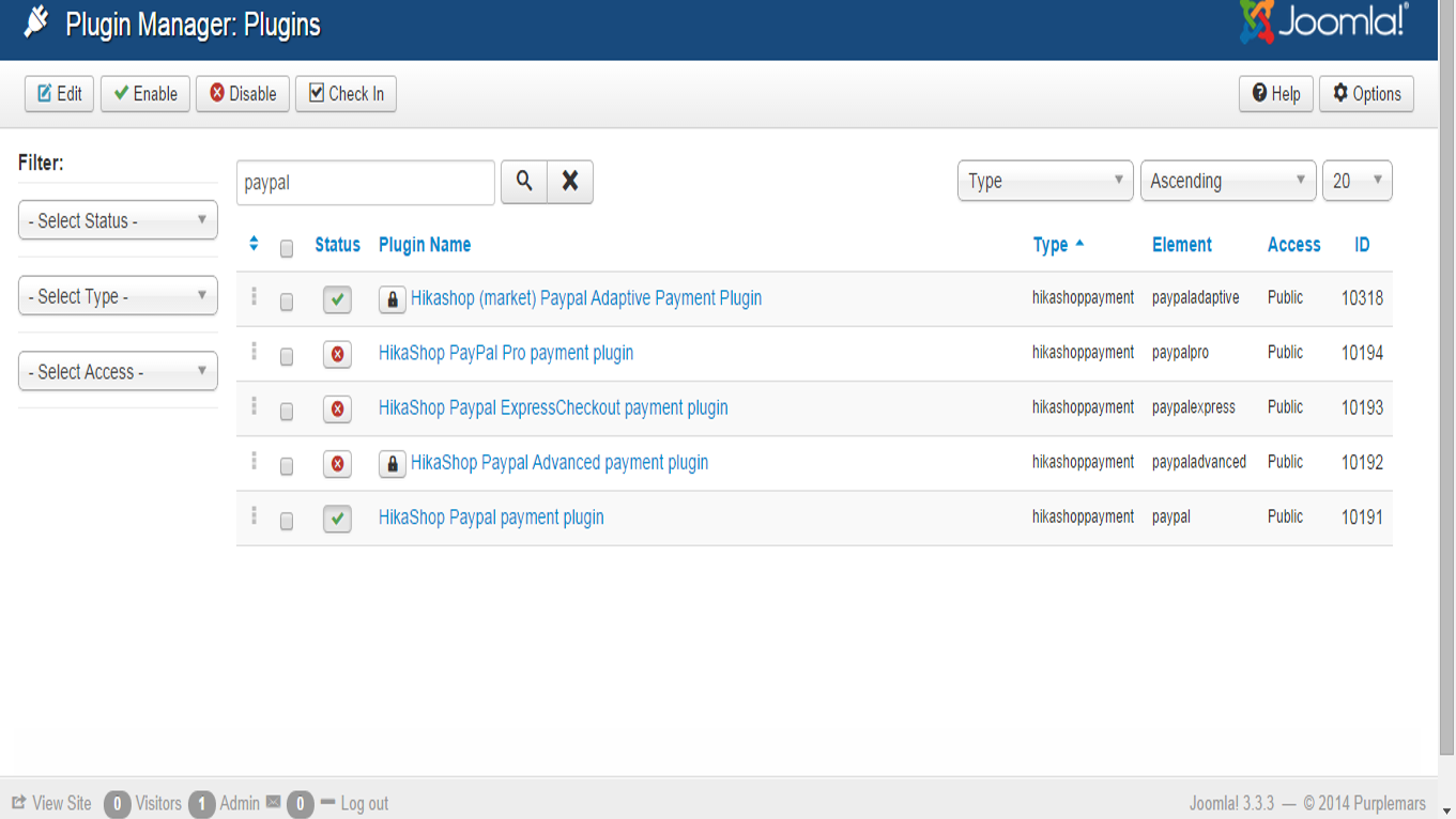

Please provide a screenshot of your paypal plugin configuration (and specify which paypal plugin you're using exactly).
Please provide some screenshot of your HikaMarket configuration (market tab).
  • Posts: 43
11 years 10 months ago #173219
Hi Jerome,
Sorry I made a mistake. Please see correct details below:
Hikashop Version : 2.3.3
HikaMarket Version : 1.4.4
Please see attached screenshots
  • Posts: 26381
11 years 10 months ago #173279
You using the plugin "paypal" and not the plugin "paypal adaptive" ; which means that the money will always be send to your store paypal account and it is not possible that your vendors are paid directly.
It means that between your HikaShop configuration and your HikaMarket configuration, they are in opposite and it won't work.
The best solution will be to use the "paypal adaptive" plugin in classical mode.

  • Posts: 26381
11 years 10 months ago #173328
If you're using the plugin "paypal adaptive" in "classical mode", the custom will pay directly the vendor if the vendor have a valid paypal email configured.
If you are using the plugin "paypal adaptive" in "adaptive mode", the customer will pay you and the vendor in the same time ; but it requires a special "paypal application" account in order to use this special mode.
Otherwise, you can still use the HikaShop "paypal" plugin but you have to change your HikaMarket configuration in order to specify that the "market mode" is "store paid directly" because it will be the case.
