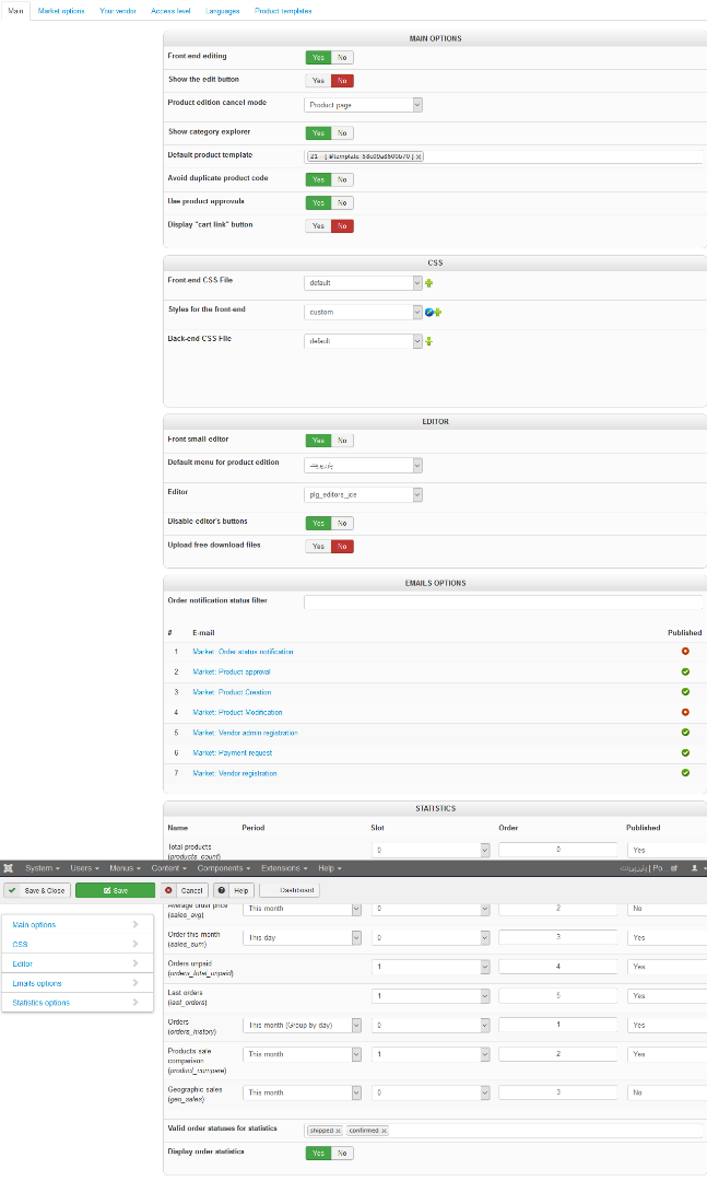

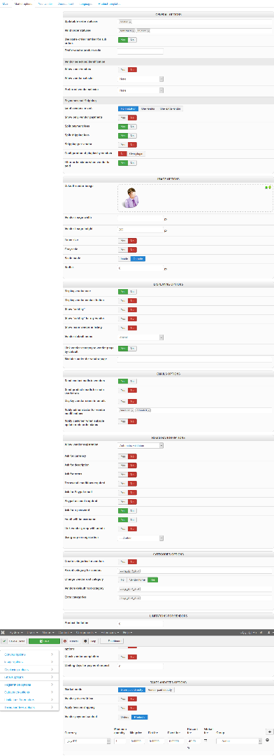

  • Posts: 50
8 years 9 months ago #281755
I attached ScreenShot.
I hope you help me, I need to automatically vendor confirmation.

  • Posts: 50
8 years 9 months ago #281805
I'm sorry, it was only we compression, I zipped the pictures and attached.
just zoom in the pictures it's readable.
Last edit: 8 years 9 months ago by pma.
  • Posts: 26381
8 years 9 months ago #281850
Thanks for the screenshot.
I can see that your configuration is correct.
You wrote that you had 5 registration and one of them was good.
So I suppose that that specific person did something differently than the others. Maybe he registered directly the user+vendor via the HikaMarket registration page ? Or maybe the opposite ?
