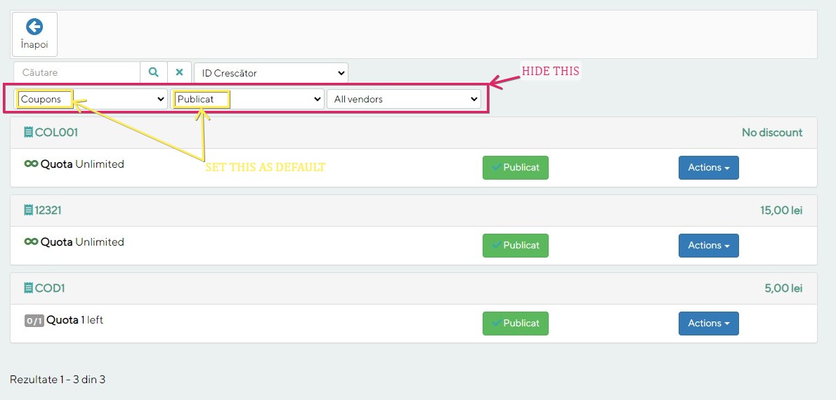

What I try to achieve is to have a menu in the front-end where some specific users (like managers) have access to this menu and they will be able to unpublish coupons only.
I want want to change the front-end like so:
1) To remove / hide the 3 dropdown filters (all discounts, all statuses, all vendors). - I know how to do this, I will edit the view.
2) I want that view to display by default only published coupons - This is wat I don't know how to do it

We can add a trigger if you want to have a custom plugin which would override the default values.
With the current version, the easier would be to edit the "components/com_hikamarket/views/discountmarket/view.html.php" and change the lines
	if(!empty($pageInfo->filter->type) && in_array($pageInfo->filter->type, array('discount', 'coupon'))) {
		$filters['discount_type'] = 'discount.discount_type = ' . $db->Quote($pageInfo->filter->type);
	if($pageInfo->filter->published >= 0) {
		$filters['published'] = 'discount.discount_published = ' . ($pageInfo->filter->published ? '1' : '0');
You can force the values to always load the published coupons.
