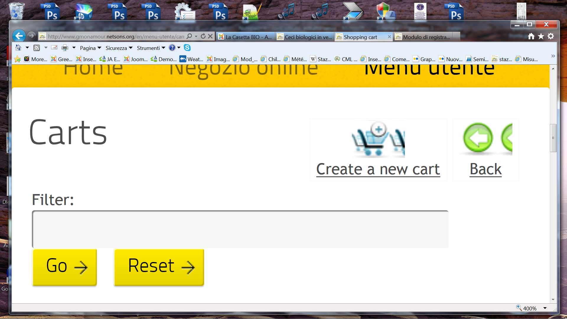

Some Hikashop icones are quite double.
You can see them in my screenshot attached

13 years 4 months ago #98138
You have to edit the frontend css file in "Config > Display > CSS" and edit the class: .icon-32-add_cart to add the property: background-repeat: no-repeat;

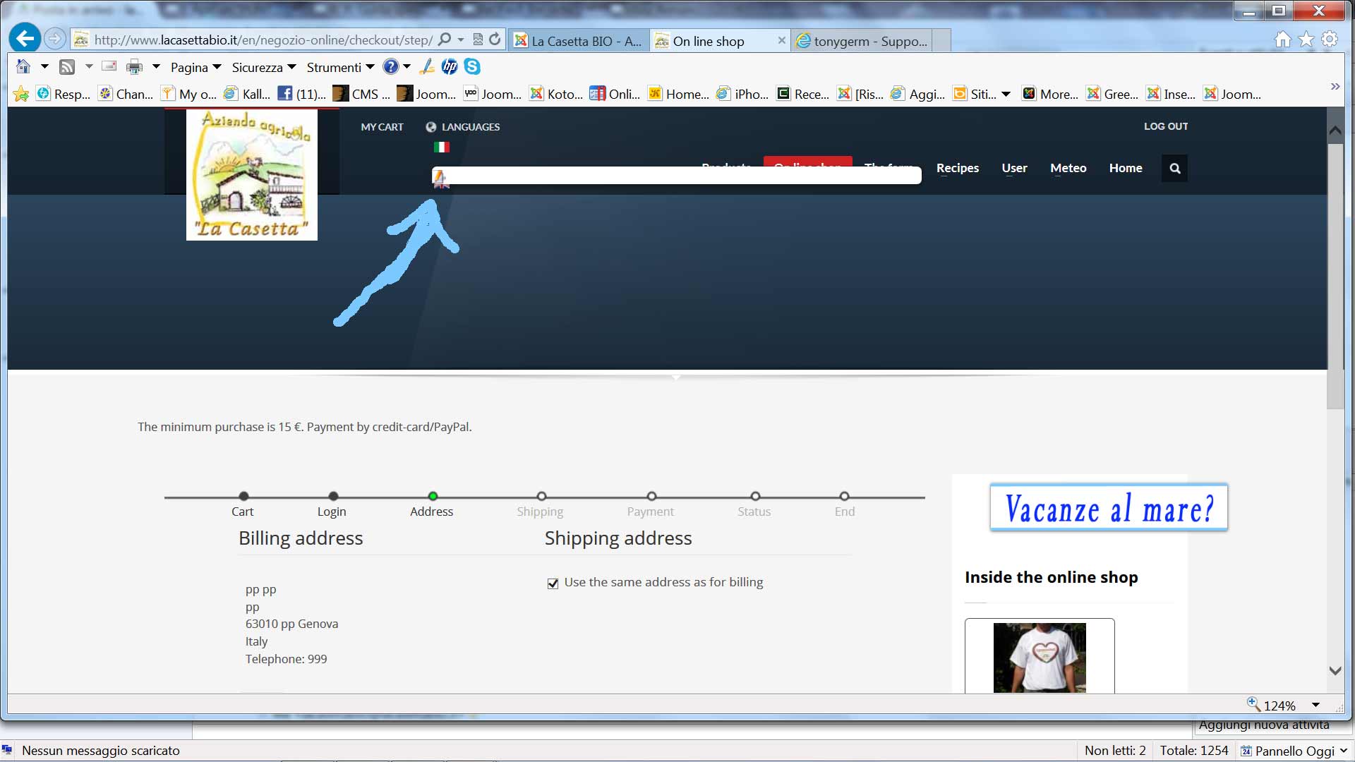

Also on ceckout>adress i have the icon "change" out of its place. You can see it in my screenshot.

13 years 4 months ago #100897
It's a known issue which come from the template.
Some templates have a bad handling of joomla 3 bootstrap rules.
www.hikashop.com/en/forum/4-how-to/80674...floating.html#100190
www.hikashop.com/en/forum/4-how-to/77125...-hover-js.html#84203
www.hikashop.com/en/forum/4-how-to/80474...-checkout.html#99408

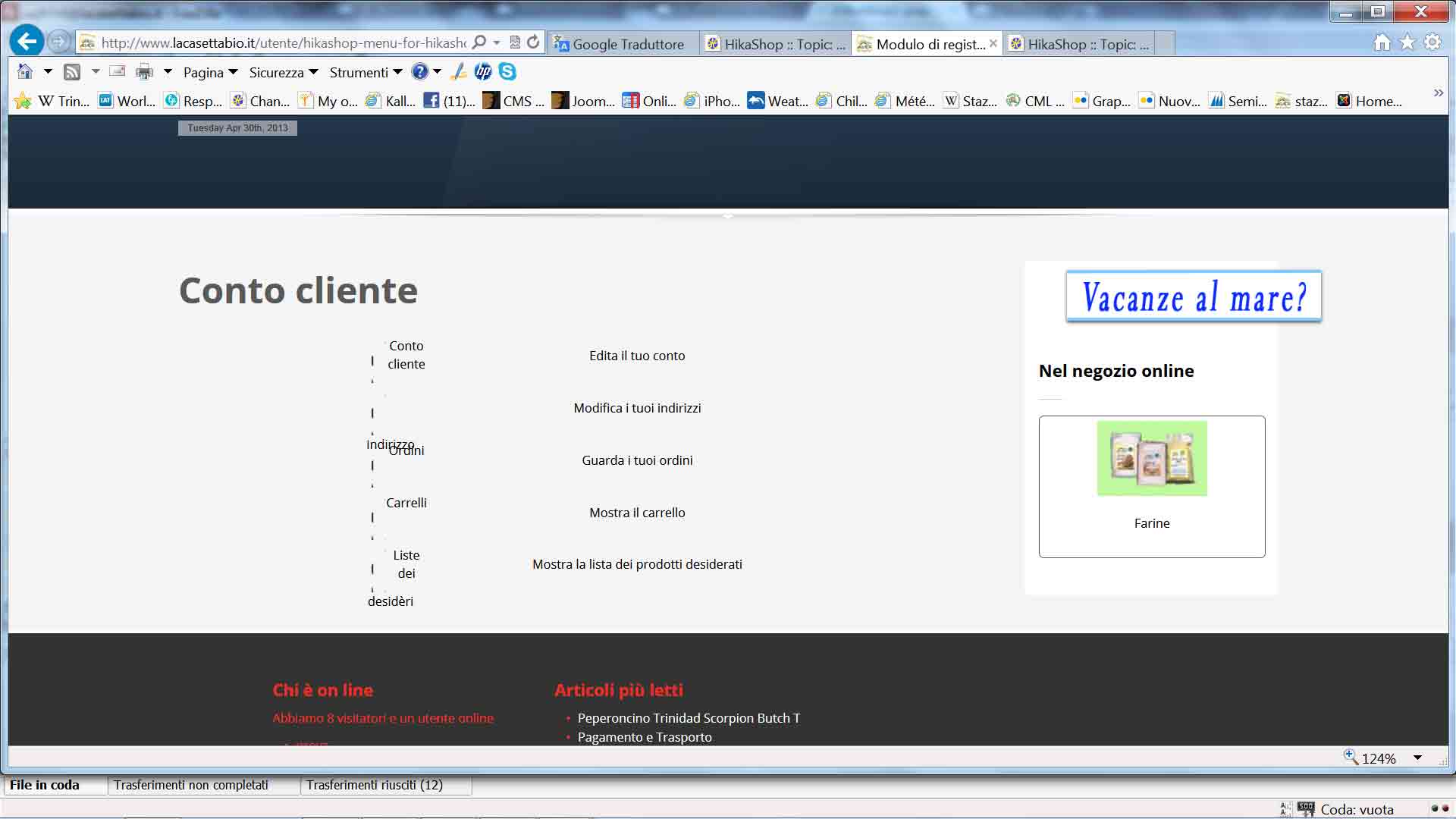

I'm very sorry but i noticed a new problem on the user control pannel.
There is something strange and wrong as you can see on my screenshot.
I have the same problem with my test site where i didn't change the template modal class.
Could you help me please?
