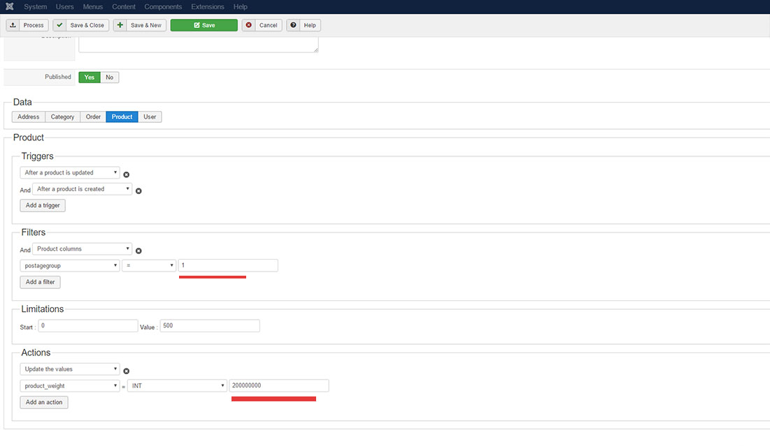

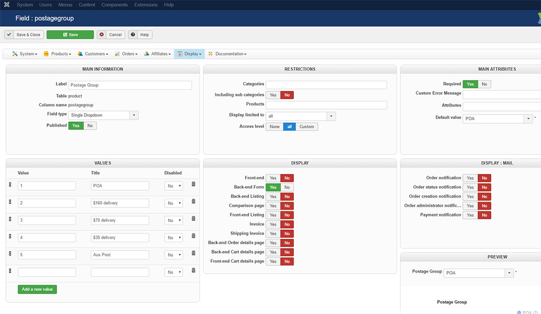

I have a product custom field set up for Postage Group (single dropdown).
I then have a Mass Action set up for each Postage Group so that when a product is updated or created it will specify a product_weight depending on the chosen Postage Group
This works as expected on a server with PHP 5.6 and applies the correct product_weight to the product.

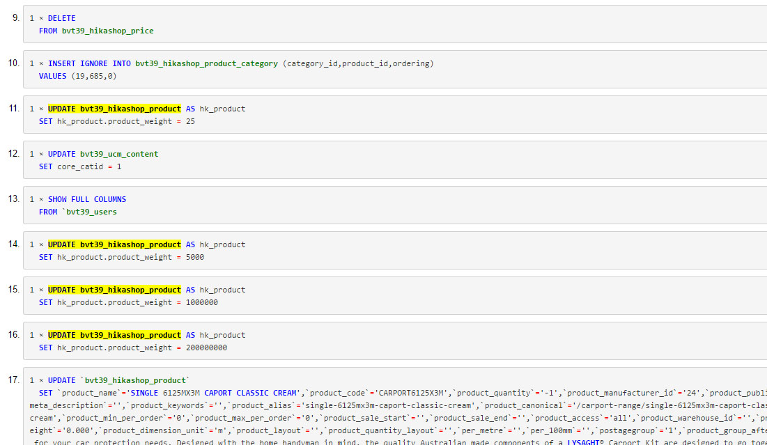

With PHP 7 (I tried 7.0.19 and 7.1.5) it always sets the product_weight to the weight specified in the most recently created Mass Action (regardless of the Postage Group I set.) I investigated further by enabling Debug mode in Joomla and noticed that it performs all of the Mass Actions update queries instead of only the one based on the filtering of the Postage Group.
