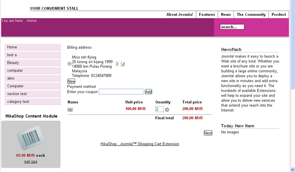

hi all,
help... customer view when doing confirmation the payment method choices and shipping choices not appear to let cust choice.
please help...

Shipping do not appear because you didn't set a weight in your products.
Please look at that FAQ to find out what you're missing: www.hikashop.com/support/documentation/i...ins-listing.html#faq
Also, if none of these points solve the problem, there is a bug on PHP4 with the display of methods in the latest version (1.4.7):
www.hikashop.com/en/support/forum/2-gene...d-message.html#10551
