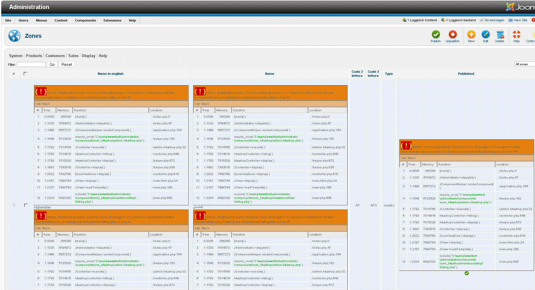

i am also getting an error why i go to the zones section

For the notices on the zones listing: If you redownload HikaShop and reinstall, it should fix the problem.
