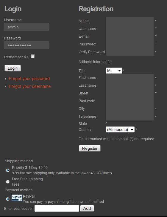

I'm not sure where to get the log file, but also...this doesn't look like how I set it up. Something has changed since I sent it in. It was working fine yesterday. Right now it looks like I am requiring registration in order to order something...but that isn't what I want. I'll look into it and get back to ya...don't know what happened, but it's a little frustrating.

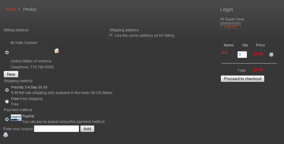

Ah, I got it. Apparently there IS a requirement to register before purchasing, as seen in the screen shot. Once registered, everything looks normal, at least to me. And as you can see, the PayPal option is there. Do you not see this option?

I can see the paypal method while not registered/logged in, but when I login/register on your website, I don't see it.

Your country is USA, mine is minnesota and that's the only one I can select. Please read the FAQ. It clearly explains the problem :
5/ If you restricted your payment methods to zones, check that the address you're using is inside those zones ! Otherwise the payment methods will be filtered out.
Thus, you should remove the payment plugin's zone restriction that you setup.
