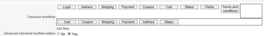

Hi all
I'm new to hikashop and fairly new to Joomla but im getting to know my way around it a bit
My problem is that when I go to the hikashop checkout page it shows the billing address and shipping address check box twice, one bellow the other. Ive been through everything I can think of in the back end and can't find anything that might be causing this and also can't find anyone else online with a similar situation
Any advice would be greatly welcomed
Simon
  • Posts: 86045
  • Thank you received: 14176
14 years 10 months ago #26798
It's probably because in the "checkout workflow" option of your configuration, you have the "address" view twice. You should delete one of them and it won't happen.
  • Posts: 5
14 years 10 months ago #26800
Thanks Nicolas. I thought that might be it too so I tried to remove one off the address steps. I dragged it to the trash icon and it disappears but when I click on save the second address step reappears in the sequence
  • Posts: 5
14 years 10 months ago #26801
I think I have sorted it. For some reason I had to remove both address steps from the workflow so that the one that reappeared after saving was the only one left. Any ideas why the steps could be reappearing after saving? I have noticed that it does it when I try to remove any of the other steps too.

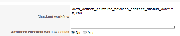

We'll fix that in HikaShop and add an option to disable the graphical drap&drop workflow so that you can still use it the old way.
  • Posts: 38
14 years 10 months ago #26806
There is already an option to switch between the old and new? See attached. Just seems the new one has a few bugs still.
--Joel
  • Posts: 5
14 years 10 months ago #26808
I don't the the the advanced checkout workflow yes/no option. Im using 1.5.4
  • Posts: 86045
14 years 10 months ago #26811
You need to redownload the install pakcage on our website and install it over your current version. That will then display the option. Also, the problem should be solved.
