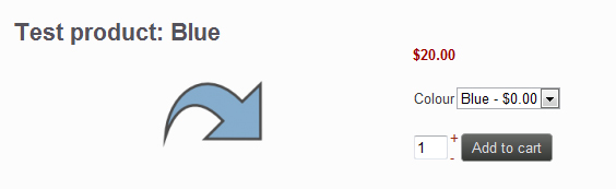

Hi Nicolas, giving this one last go before giving up!
I have added the following code to characteristic.php:
foreach($characteristic->values as $k => $value){
$price=$element->variants[$k]->prices[0]->price_value;
$price=sprintf("%01.2f", $price);
$values[$k]=$value->characteristic_value." - $".$price;
and I have now got variant dropdown boxes that have the price appended to the vairant text. Problem is, all the prices are zero (ie: Red - $0.00)
See attached pic.
Any help on what I'm doing wrong appreciated!
Tks
  • Posts: 86106
  • Thank you received: 14207
14 years 9 months ago #29737
that's because the $k is the id of the value of the characteristic, not the id of the variant.
So $element->variants[$k] is not correct.
You should loop on $element->variants to check on whether the variant is linked to that characteristic id and then get the price of the variant if it's a match.
