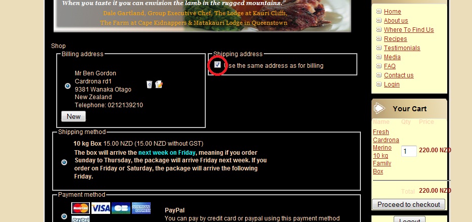

  • Posts: 7
15 years 7 months ago #6623
The website is www.cardronamerino.com . It is the same problem described above. If I want to change the shipping address it changes the billing address.
  • Posts: 86181
15 years 7 months ago #6624
I was able to place an order on your website with one address for the billing address and a different address for the shipping address. Everything worked as expected. You can check the order on your back end to see that you have different addresses for the billing and shipping...
  • Posts: 7
15 years 7 months ago #6625
So do you think it might be a caching problem on my end? Since it doesn't work on 2 of my computers... I see that you were able to do it, so I assume it is fine...
Thanks for the quick reply :)
Last edit: 15 years 7 months ago by chatmautr.
  • Posts: 86181
15 years 7 months ago #6626
You don't seem to have any caching activated.
Could you try with different browsers ? Also, could you do some screenshots of what you're doing step by step so that we can understand where lies the problem on your end ? It might be because you're using it in a way we didn't think of...
  • Posts: 7
15 years 7 months ago #6627
Here is a zip with how I add the address. The address was already filled in from a previous time
  • Posts: 86181
15 years 7 months ago #6628
The address selection screen enables you to select an address from the list of addresses you have attached to your user account.
When you click on edit, it will edit the address entry. Since that address is selected for both the shipping and the billing address, when you change it, it changes for both of them.
If you want to have two different addresses, you can use the new button to add a new address. That will display both addresses for each the billing address and the shipping address selection, enabling you to select different ones for the billing and the shipping.
  • Posts: 7
15 years 7 months ago #6629
Aha, so that is just the way it was built. Is there any way not to show the billing address as the shipping address?
  • Posts: 7
15 years 7 months ago #6630
Just to clarify, I don't want the billing address to show up when I uncheck the box for the same shipping address.
  • Posts: 86181
15 years 7 months ago #6631
Well, that's not how it was build. In HikaShop, you don't create/edit shipping and billing address, but you create/edit addresses which can then be used for shipping/billing. So far, no one reported that they didn't like the way it was built...
  • Posts: 7
15 years 7 months ago #6632
It might just be me then. If there was a way to separate the different address inputs, that would be nice. But as I understand it everything is just saved as an address and the selection gives it either the shipping or billing parameter.
The problem is usability, this site is not for tech savy people, so some might find it frustrating. I'll just put how to do it in the FAQ on the site, so nobody can complain.
Thanks for the great support!
