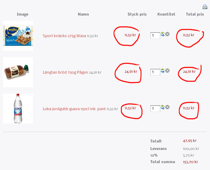

What do i have to do to show prices with vat on the front-end checkout and the back-end invoice?
I'm not good att coding so i would appreciate a really easy guide :unsure:
Best regards

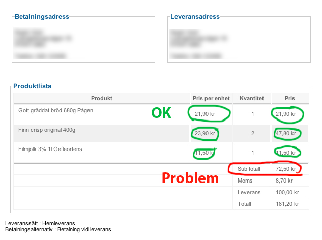

I think i must change the code in cart.php and invoice.php.
All works great in shop when listing products and so on, but when I'm on checkout page the problem appear.
Suddenly all products shows without tax, it's just in the total at the bottom of the page the taxes shows up.
Second problem appears when I'm klicking on the generate "invoice-button".
/Peter

I found answer to one of my questions here --> www.hikashop.com/en/forum/4-how-to/43728...-includes-taxes.html
This code did the trick for my checkout page "
Regarding the total price with taxes on the checkout, you will have to edit the file "cart" of the view "checkout" via the menu Display->Views in order to add the line:
$this->params->set('price_with_tax',1);
before the line:
$this->row=$this->total;"
But the code for invoice did not work, don't know why.
I'll hope Nicolas can help me out :)

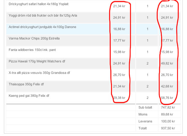

Only one more thing, same problem as peetree21 has.
The sub total when generating invoice in backend does not show tax.
I believe it is this line <?php echo $this->currencyHelper->format($this->order->order_subtotal_no_vat,$this->order->order_currency_id); ?> i have to change.
/Peter

Yes. You can just use that line instead:
<?php echo $this->currencyHelper->format($this->order->order_subtotal,$this->order->order_currency_id); ?>
