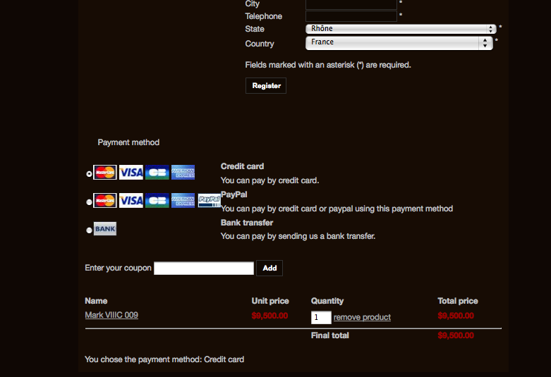

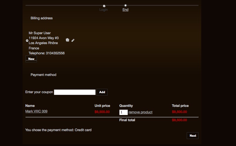

Hi, I have a problem to configure payment details as well. Once I add the product to cart, it takes me to the login where it displays payment as well. I know I need to adjust a little bit of layout, but here are some screen shots.
Once I click on payment it takes me to the checkout and it shows as follow.

So, first I don't want payment options to be displayed on the 'login/registration' page.
Then, radio buttons don't work properly. But when I click on paypal let's say and I press next, I just go to the next page and it looks like this (attached)
So user can't choose any payment options. Plus, if I click on next, my page refreshes and this is it. :(
I'm very new to all this store front, so need your help.
Thank you!
Last edit: 15 years 3 months ago by areena.
  • Posts: 86048
  • Thank you received: 14176
15 years 3 months ago #15161
If you want to have your checkout workflow in several pages, you need to change the "checkout workflow" option which is in the tab checkout of the configuration. We have a lengthy documentation on how to set it up:
www.hikashop.com/support/documentation/5...config.html#checkout
Concerning the payment methods "disappearing", that's probably because you set a "zone" restriction in your payment methods settings. Here is a FAQ on the different possibilities of that problem: www.hikashop.com/support/documentation/i...ins-listing.html#faq
