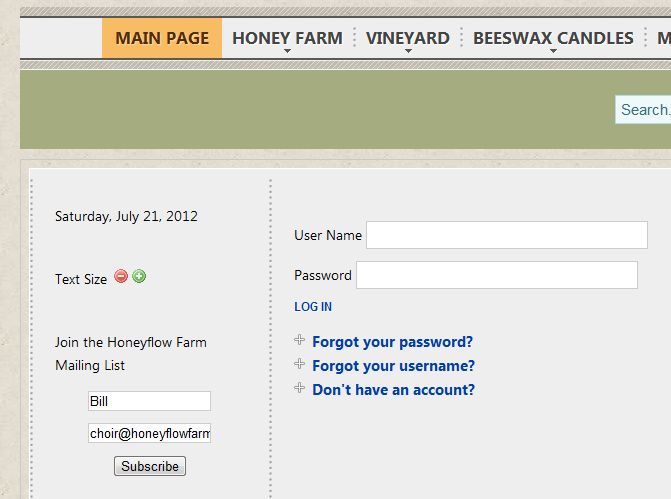

14 years 1 month ago #58372
The order details page is only available for logged in users.
When the user is anonymous, he can't access order details for security reasons because it's not possible to identify him.
So the behavior you're experiencing is totally normal.
Either you don't redirect the user to the order details page and you can have a "no registration" checkout, or you redirect to the order details page and you can't have a "no registration" checkout.

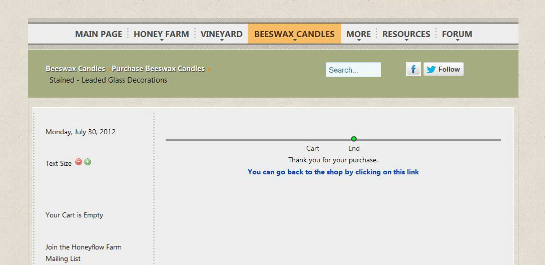

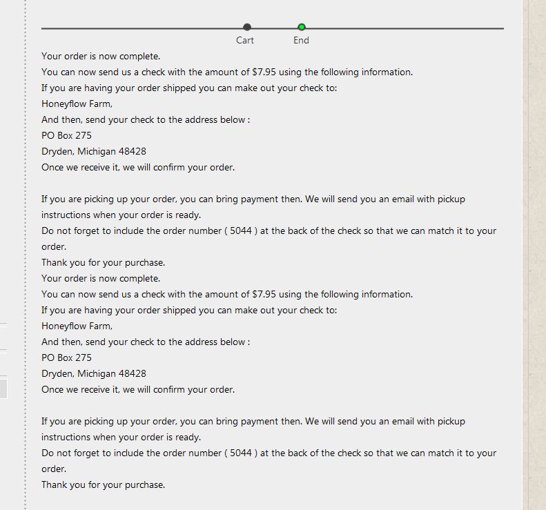

Test order 1 - local pickup & send check - order went through just fine with nice send check info screen at end.
Test order 2 - ups & authorize - order went through just fine but at the end I saw a nice screen with some thank you text and something more... But the screen disapeared and went blank.
1 - How can I keep that screen back in the end picture (and maybe edit it slightly?

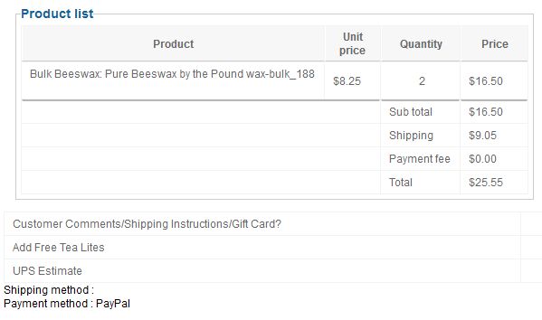

2 - On the invoice (sent to us and customer) (attached), can I get the TYPE of shipping, and the TYPE of payment somehow on the invoice?
3 - How do I get any mention of VAT off of the invoice - We have none.

2. You can add such code in the invoice file:
<?php
$shippingClass = hikashop_get('class.shipping');
$shipping = $shippingClass->get($order->order_shipping_id);
$shipping->shipping_params = unserialize($shipping->shipping_params);
echo 'Shipping method :'.$shipping->shipping_name;
echo '<br/>';
$paymentClass = hikashop_get('class.payment');
$payment = $paymentClass->get($order->order_payment_id);
$payment->payment_params = unserialize($payment->payment_params);
echo 'Payment method :'.$payment->payment_name;

1 - Attached is a screenshot of the page that dissapears after an order is completed. If I could get that page to stay with a copy of the order below it the problem would be solved. Do you have some code I could paste - I cannot write code myself. (I think maybe you already said I could not do this because the customer is not logged in - but can I edit the page and remind them an order copy will be sent to them?) (I guess I have to decide what scenario is worse - forcing a login or no order copy)
2 - I copied and pasted the code to show the shipping and payment methods to the "bottom" of the "invoice file I found in the "display - Views" folder. The methods were not visible in the next text order I made.

14 years 4 weeks ago #59431
1. Indeed, you can't display the order details there since users have to be registered for that.
If you just want to change that text, you can use a translation override:
www.hikashop.com/en/download/languages.html#modify
I think that the redirection that you get on that page comes from the fact that you entered a URL in the "return URL" field of the authorize.net configuration.
If you don't set it, it won't redirect the users.
2. Make sure that you're doing it for the file of your back end template.
3. You will have to revert that change if you want to display the taxes there.

I have pasted the above code in the back end of the invoice file on the bottom and the shipping method is still not visible on the invoice printed from the back end of Hikashop. (image attached) It does show up for a "Free Shipping" order. I use this page to go pack the order and it is very useful to show how I should pack and ship it. The payment method comes through ok. I can write it in by hand but it should be there.

It must be because you're using UPS.
Instead of:
try:
echo 'Shipping method :'.order->order_shipping_method;
