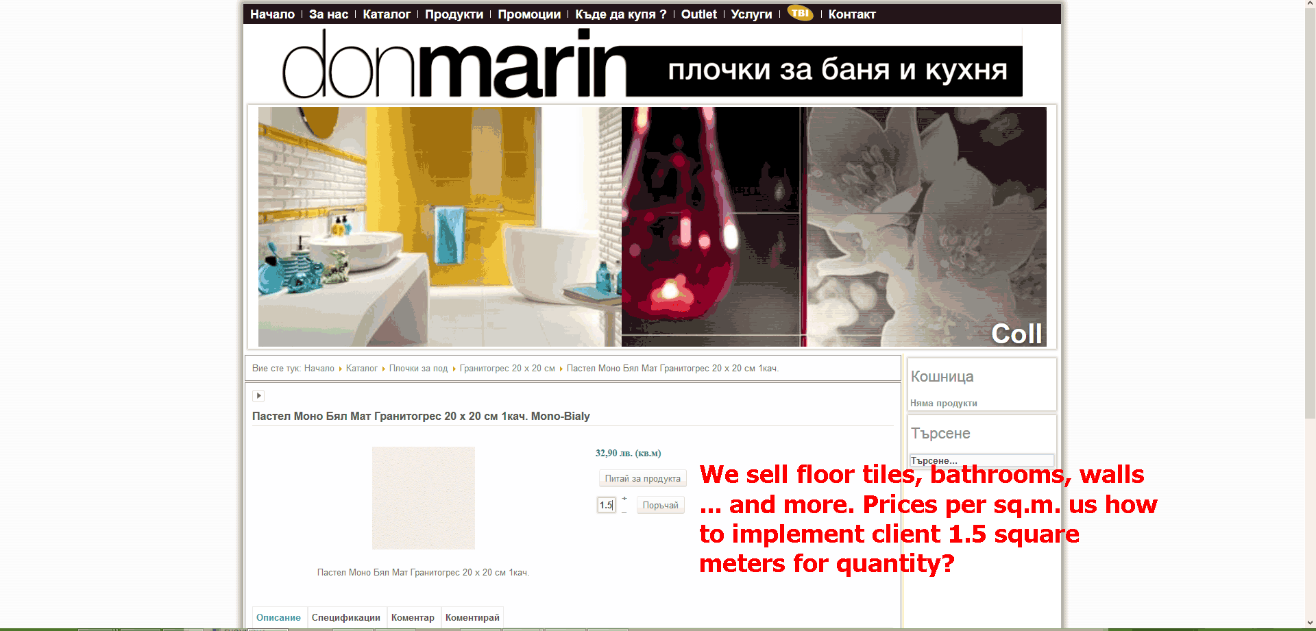

Hi Nicolas, We sell floor tiles, bathrooms, walls ... and more. Our prices per sq.m. ... how to our consumer imput 1.5 square meters for quantity field in the cart?
Our site is www,donmarin.com

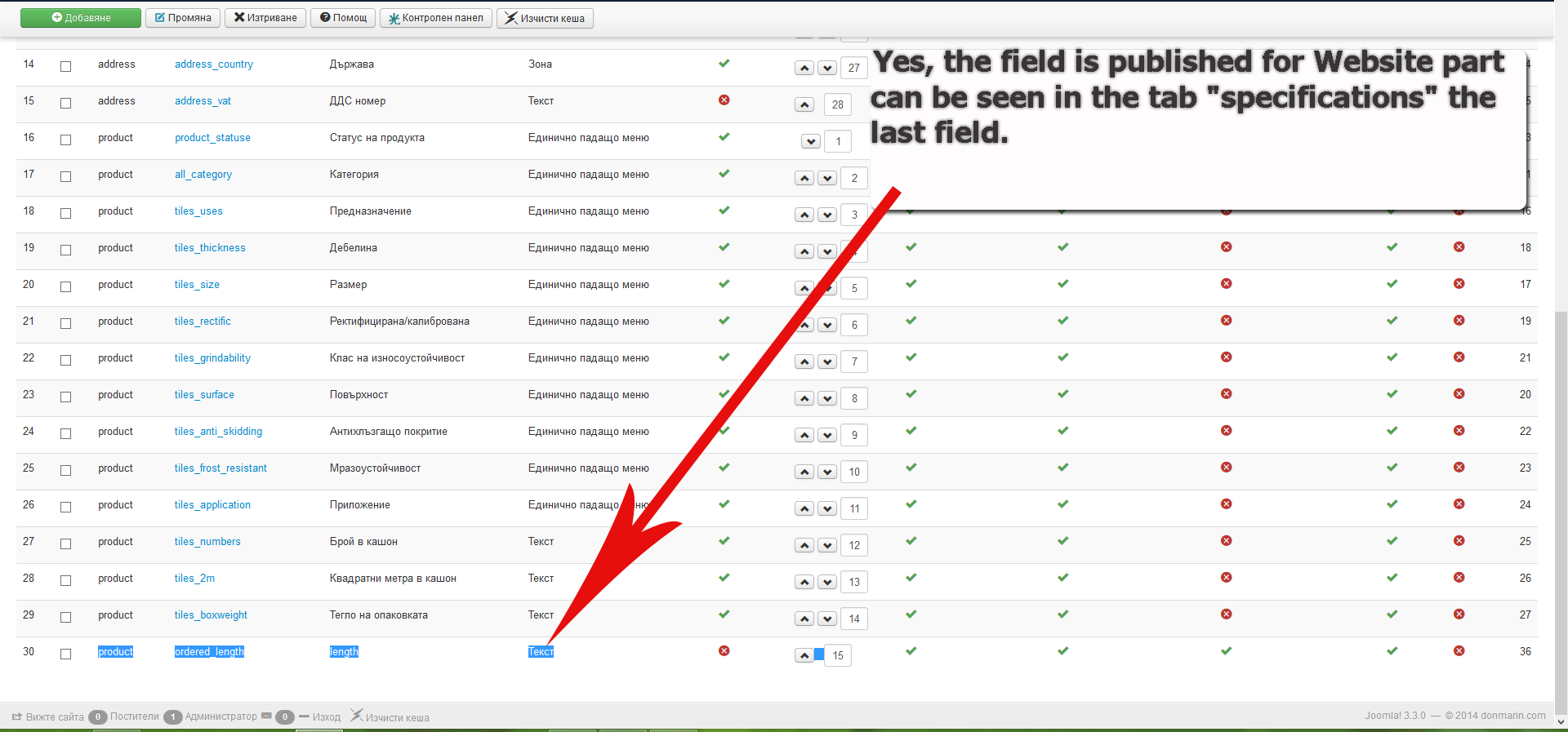

Yes, the field is published for Website part can be seen in the tab "specifications" the last field. See on the product page HERE

12 years 3 months ago #157662
create a custom field in the table "item"
You created it in the "product" table ;)

12 years 3 months ago #157796
Thank you, and yes, it's my fault, but the translation of Hika Shop in Bulgarian is wrong, the latter two categories from the drop down menu in the categories of the custom fields are not translated correctly, hence my mistake. Now, all right poletoizliza enables users to enter values ​​that we want, but they not be calculated into the final amount.
