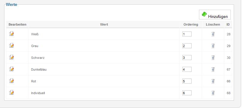

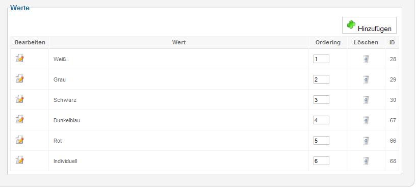

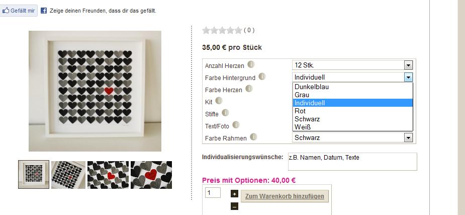

  • Posts: 22

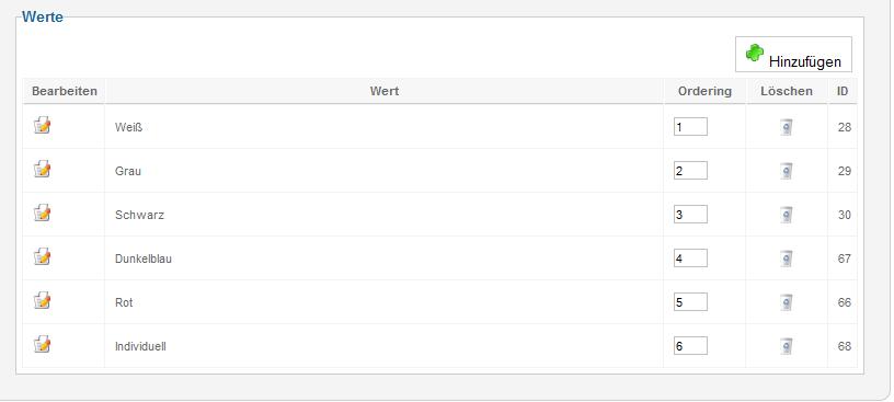

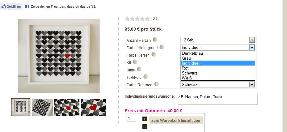

13 years 10 months ago #69054
Here are two screenshoots. One of the backend with the selected order and one of the frontend with the wrong order.
Thanks,
Alex

  • Posts: 86051
  • Thank you received: 14179
13 years 10 months ago #69063
Ok, it's the values of the characteristic that you want to order, not the characteristic itself :)
In the display tab of the configuration there is the option "characteristics values ordering" that you can set to "ordering". That's actually the default value for that option.
  • Posts: 22
13 years 10 months ago #69070
Thanks but actually it was already set to ordering. If I save it again nothing changes. If I set it to ID the order changes to the ID numbers but it doesnt work with ordering.

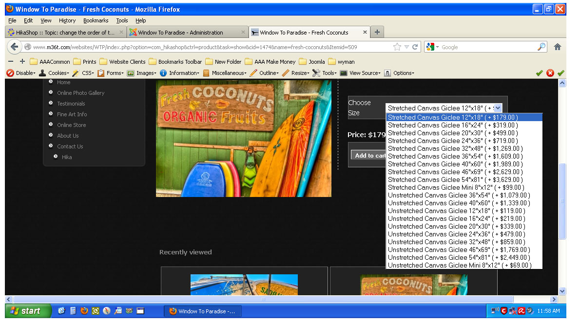

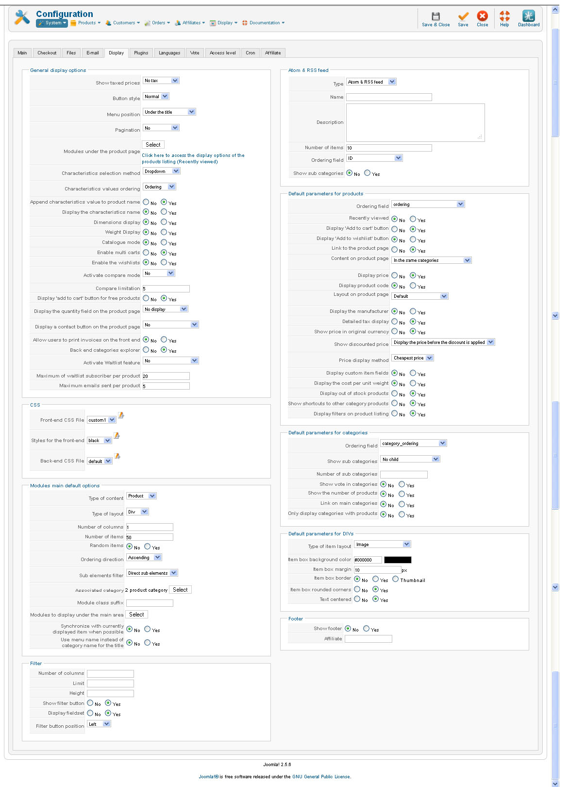

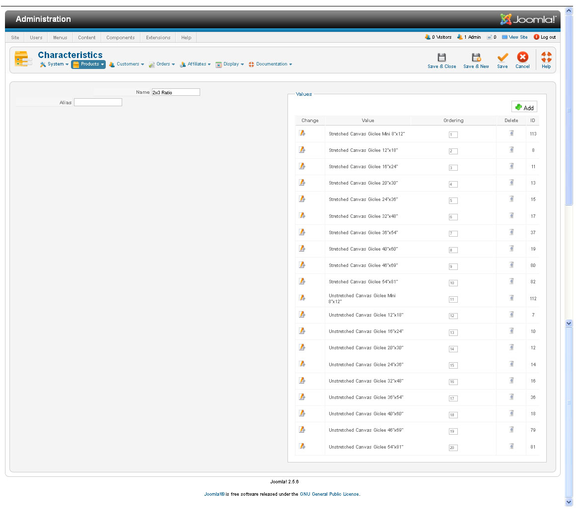

  • Posts: 9

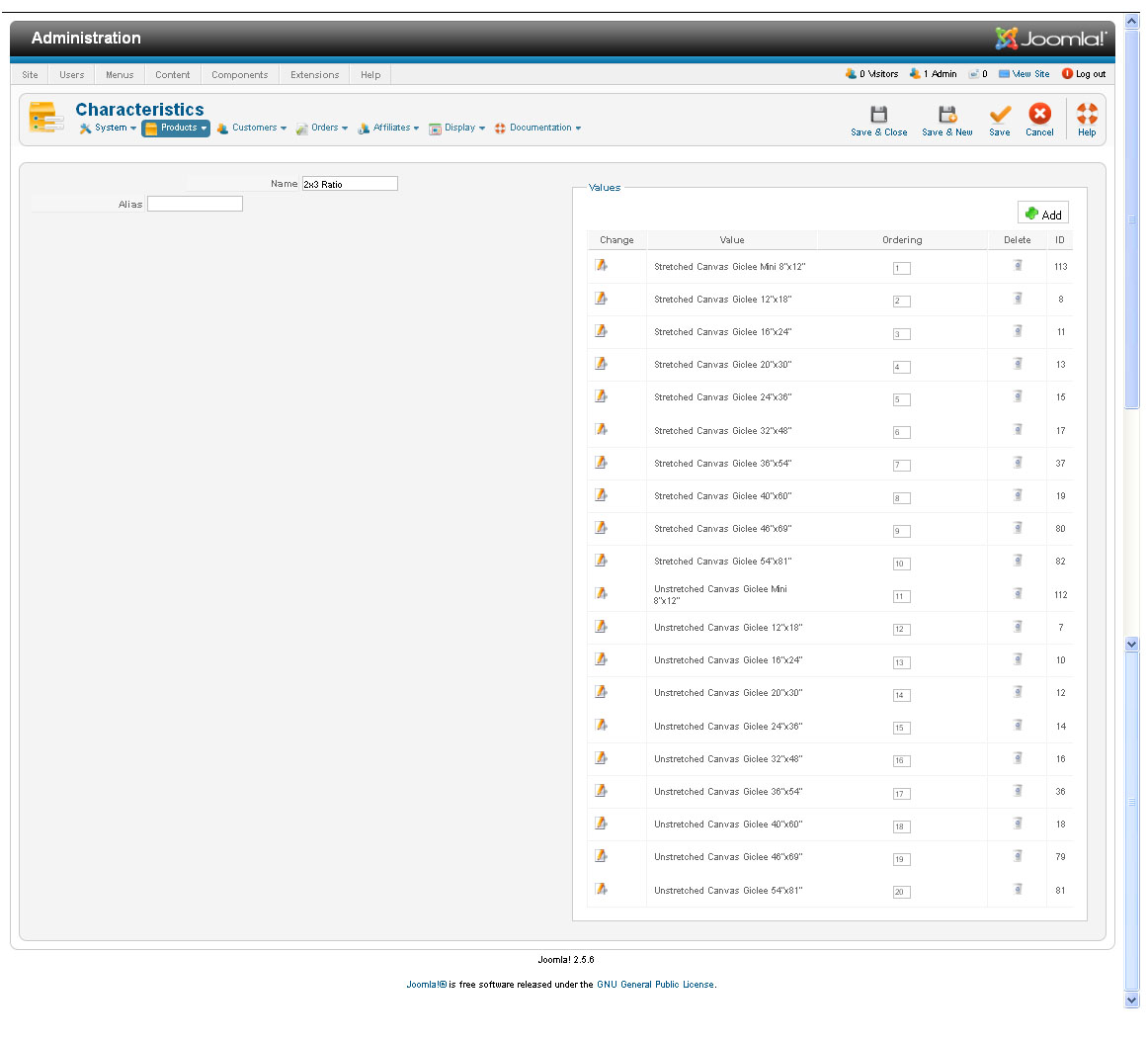

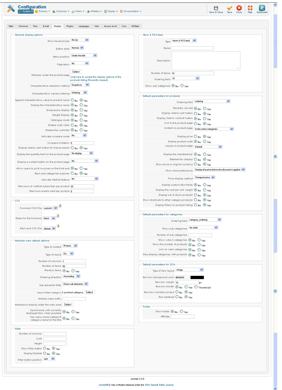

13 years 6 months ago #88188
Hello Nicolas,
Thank you for the response. Yes it is set to ordering. I have included 3 screen shots: Front end view, back end characteristics view and my display settings view. Please review and let me know what you think.
The store is setup using characteristics/variables that I attach to a product and then use that as the option product to the main print product. Then for additional products I can copy my main option product attach it to a new main print product and be able to publish or unpublish the necessary sizes that apply.
It is urgent I get this resolved since I cannot move forward until it is. I know you are very busy and any help is appreciated.
Switching over from Virtuemart, I have to say, Hikashop is great! Thank you!
Last edit: 13 years 6 months ago by MauiMark. Reason: Urgency addition

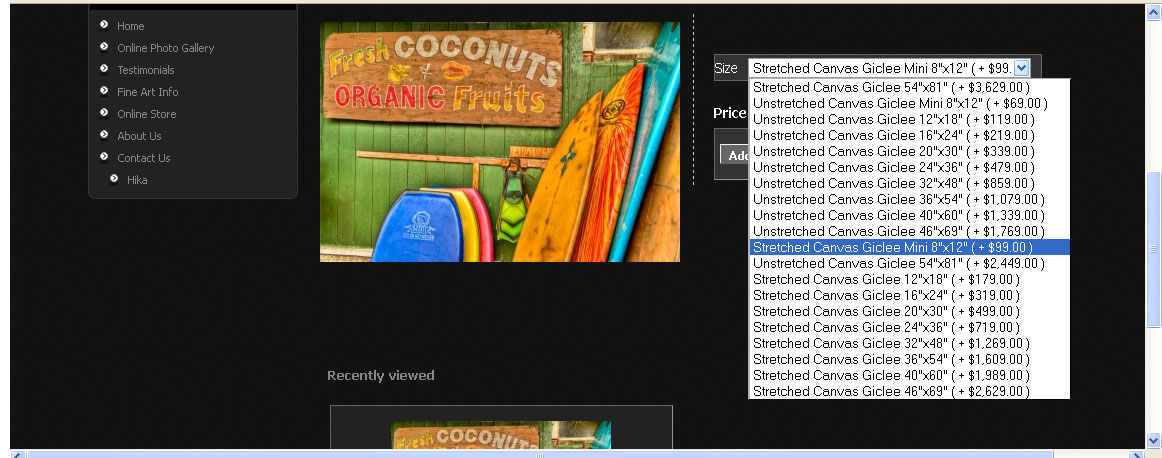

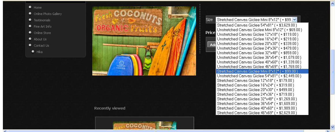

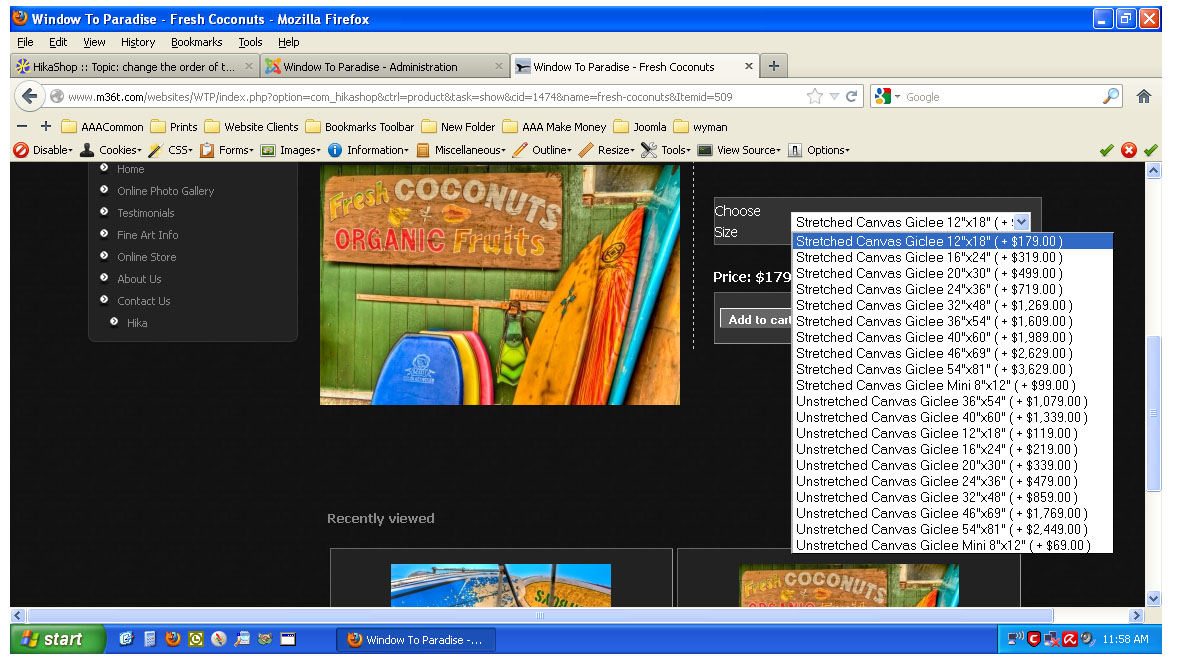

  • Posts: 9
13 years 6 months ago #88407
Hello Nicolas,
Thank you for the response. I have tried this and attached the results in a new screenshot of the front end product view. I have also attached the view.html.php file as I modified it per your suggestion. Unfortunately, it does not seem to have resolved the issue?
FYI: When I view the product which has the characterisics on it(the one i have set as the option) it shows right. It is when I add it to the main product as an option that the sort order no longer works.
Last edit: 13 years 6 months ago by MauiMark. Reason: additional info
