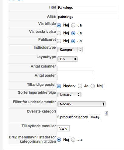

Hello - i just installed the free version of this Cart.
Then i want to add categories to my menu.
I looked at this Youtube video - very good indeed
www.youtube.com/watch?v=SBMcCvMj6Zg
BUT - when i take the step where i am suppose to choose a category for my menu - it will NOT save.. ore yes i can save, but it dissepears when i save.. SO i end up with all category showing.
I dont know if i can explain. But if i have Paintings.. i choose my category "paintings" for the menu, but when i save it dissapears and when i then push the "menu button: Paintings" it show ALL my categories... so it did not point on the specific category.
What can i do - and what did i do wrong?
I put a screendump.. where it goes wrong is where you should choose "2 product category" - i choose.. and save.. and then it dissapear and doesnt work..
If you look my page you can push to the left "Paintings".. then it SHOULD show paintings and those subcategories (when i make them) - but its just showing all my top categories.. :( ?

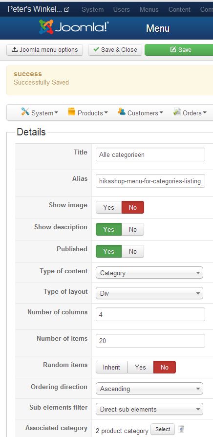

  • Posts: 21
13 years 7 months ago #82648
I try to change the number of columns, and the result was that now the number of the columns is empty. And also the number of the articles is now empty.
I can type any number but after I hit the SAVE button, every is empty again.
Peter
  • Posts: 26381
13 years 7 months ago #82658
Hi red_garfield,
I tried with the access you send and I didn't have any problem to save the HikaShop content menu configuration.
I have changed the number of columns to 4, save it and, it works...
Which browser do you use ?
  • Posts: 21
13 years 7 months ago #82661
I'am using Safari on a Mac.
Now I also installed Chrome. It looks like this will work.
Peter
