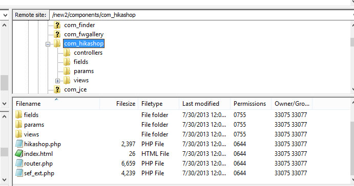

  • Posts: 32
12 years 9 months ago #123639
I am having exactly the same issue. I posted about it here yesterday. www.hikashop.com/forum/checkout/861991-o...customer.html#123638
I checked for the helper.php file in the back end but am unable to find it! Attaching a screenshot so that you can see what I mean. There is no helper folder! What am I missing?
thanks.
  • Posts: 26360
  • Thank you received: 4068
12 years 9 months ago #123834
The helper is in the backend, not in the front-end....
administrator/components/com_hikashop/helpers/helper.php
