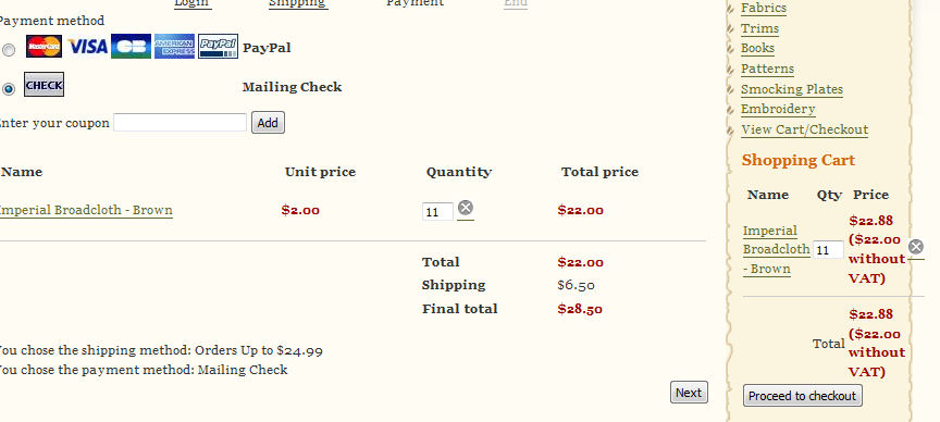

I have it set to show the price with and without taxes, but if you look at this image, you will see
The cart info on the left, the total price column, nowhere in that column does it reflect the taxes. Over on the right, the cart module display does show the taxes. That is confusing.

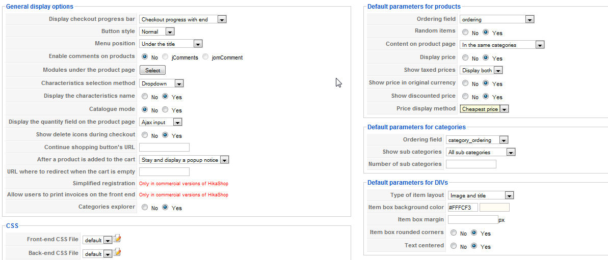

  • Posts: 15
15 years 9 months ago #944
I believe I have this set correctly in the display configuration.

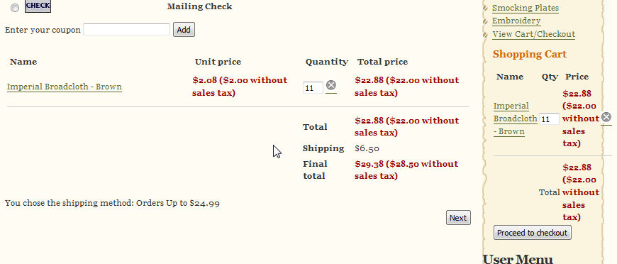

15 years 9 months ago #947
Here is what the check out looks like now.
To me this is a somewhat cluttered and confusing shopping cart checkout.
I would prefer a much more cut and dried looking checkout
Total $22.00
Shipping 6.50
Taxes .88
Final Total 29.38
Is there a way to accomplish this??
  • Posts: 86042
  • Thank you received: 14174
15 years 9 months ago #949
That's a good idea. We will try to add a new option for that. In the mean, time you will have to edit the code of the file cart.php of the checkout view via the Display->view menu.
