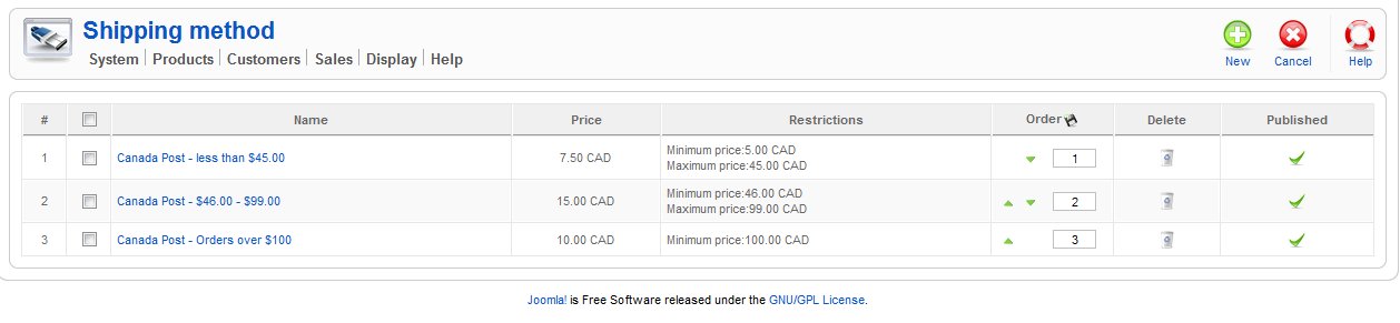

I am having problems with making the shipping amount consistently applied to a order. Sometimes it is and sometimes it is not. There does not seem to be a rhyme or reason to it. :(
I have attached a image file showing the manual shipping methods I have setup.

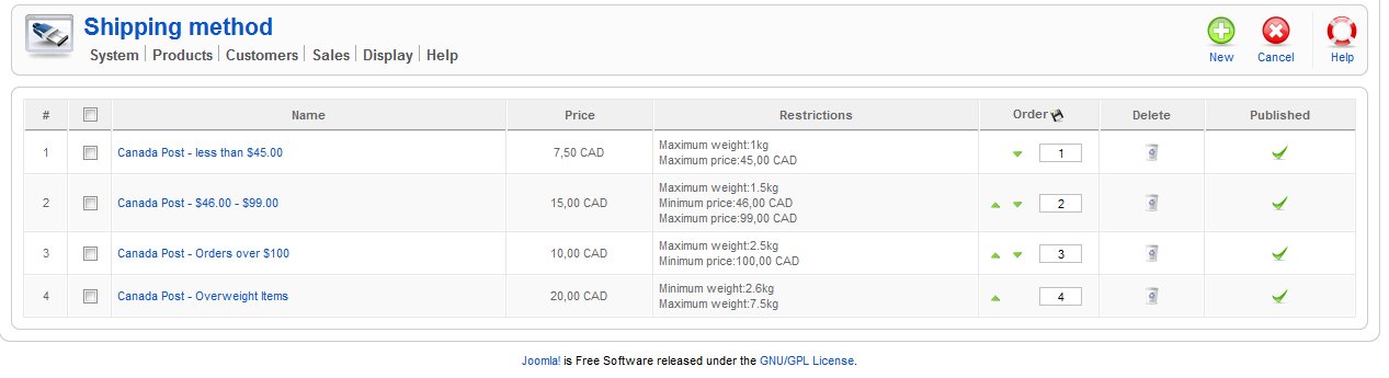

If your order weights between 1kg and 1.5 kg and that the total is below 46 CAD, you won't see an shipping method available because you don't have any shipping method for such case as well as other cases.
The shipping methods restrictions need to be all matched in order to be displayed. If you have an order between 1kg and 1.5 kg and that the total is below 46 CAD, the first shipping method won't match because the weight is too high and the second won't match because the price is too low.

15 years 5 months ago #9013
Sorry, I am still having problems with the shipping. I have attached the shipping methods that I am currently using which is just price dependent. Sometimes the shipping cost will be applied but often not. I remove all the items from the cart and start again with still the same result.

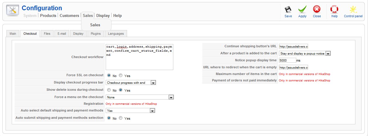

Have checked all the points on the FAQ. Attached is the screen-shot of Checkout

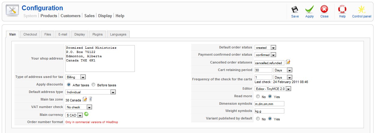

Attached is the screen-shot of System

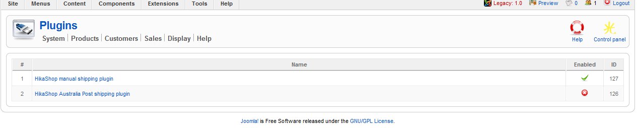

Attached is the screen-shot of Plugins

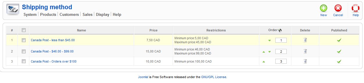

Attached is the screen-shot of Shipping Methods

15 years 5 months ago #9293
Ahha! I see the problem now. I am using a csv file to import my products and had set the weight unit to "KG" but Hikashop is configured to use "kg". On import it defaults to kg but is not happy with it so probably registers it as zero weight. I changed the weight symbol to kg in the csv file and re-imported and all is well.
Thanks for your help!
