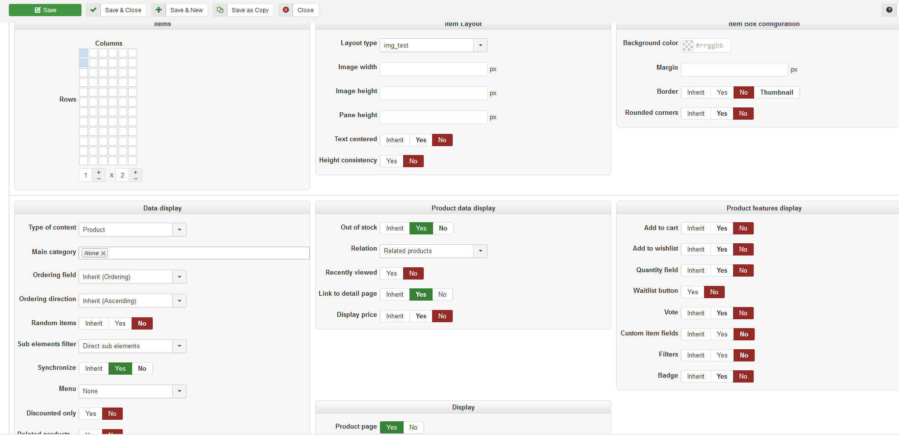

step 1 : create a new hikashop content module - > setting set relation : Related products
step 2 : go to hikashop setting -> display tab -> Product options section -> Modules under the product page = select a module Related products
step 3 : go to product and set a Related products (search product name show a product and select ->save)

4:
Create a view override of a product listing view file close enough to what you want through the Display -> Views menu in the HikaShop backend, e.g. for listing_img_title.php.
If an override for this view already exists (indicated by the trash bin in the views listing), give the new one a new name, e.g. listing_related.php, and save.
5.:
Edit this view to your liking, including all the PHP you want.
6:
Back to the module which you created following p30yaran, there with "Div" selected, find and pick your new view under "Layout type".

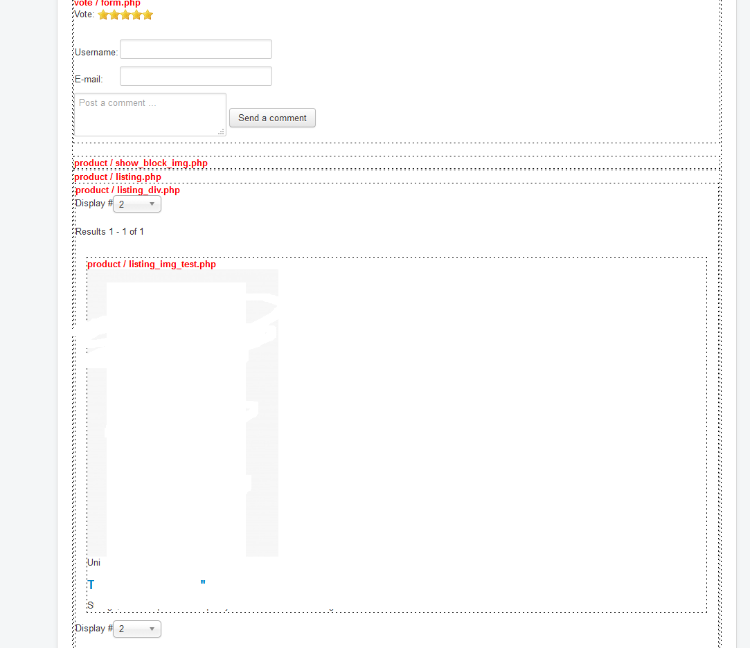

I would like to know if there is a way to load related products data of the product via PHP CODE.
The issue is that we have some customization under listing_div.php and this is also included loading via module. For sure we could hide with css but maybe we could go cleaner way and load product related data as we do as example for product code:
$this->element->product_code
Doing var_dump for $this->element returns no data for related products. So i am curious where are they stored?
I hope question is more clear now.

1. If you look at the code of listing_div, you can see this:
$itemLayoutType = $this->params->get('div_item_layout_type');
$this->setLayout('listing_' . $itemLayoutType);
echo $this->loadTemplate();
That's the code which loads listing_img_title or listing_img_desc, etc based on the item layout setting of the menu item/module.
So you could modify product/listing.php, get the $itemLayoutType = $this->params->get('div_item_layout_type'); line of code to load the item layout of the module, and if it's your custom layout, then you could call listing_custom instead of listing_div in the line:
$html = $this->loadTemplate($layout_type);
2. Pagination is supported for modules under the product page so that if you have more related products than space available to display them, you can have a pagination to see all of them.
Now similarily to point 1, you could turn off the pagination if the item layout is your custom layout like that:
$this->config->set('pagination', '');
The following user(s) said Thank You: kyratn
