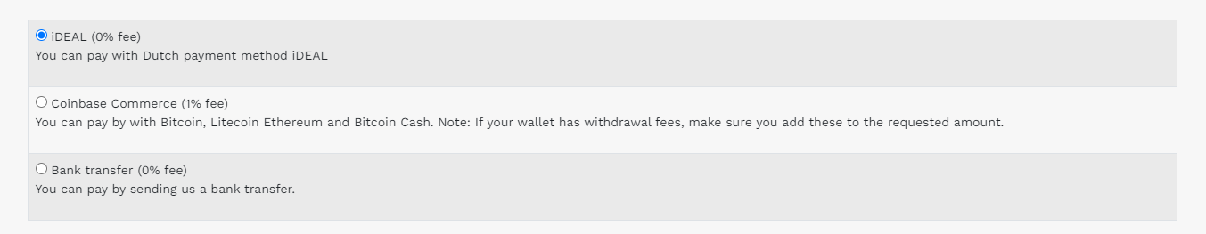

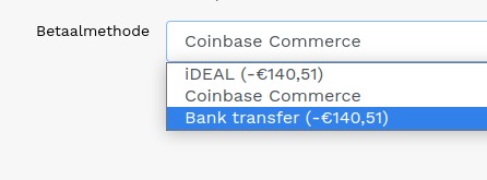

I have recently changed to show the payment fee in % instead of price shown in the attachment below(hikashop_paymentfee.png).
I came across the pay now fucntion in the order listing page and noticed on there you still see the payment fee in price instead of % as shown in the second attachment.
How do i also show the payment fee in % instead of price on the pay now page.

That's not as easy to change.
This will require modifying the code:
$diff = $method->payment_price_with_tax - $this->order->order_payment_price;
					$sign = '';
					if($diff > 0)
					 $sign = '+';
					$this->methods[$this->type][(string)@$this->order->order_id][$k]->payment_name .= ' ('.$sign.$currencyClass->format($diff, $this->order->order_currency_id).')';
in the file administrator/components/com_hikashop/types/plugins.php
This is a core file of HikaShop, so you will lose your changes each time you update HikaShop.
To avoid that, you would have to override the whole class with the development of a system plugin:
www.hikashop.com/support/documentation/6...ntation.html#classes

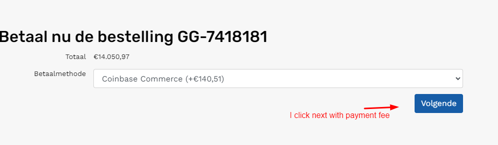

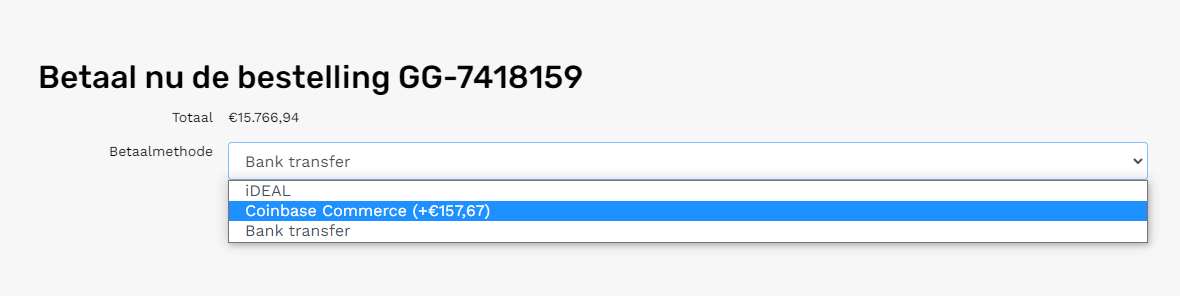

I found a bug on the pay now page.
Whenever i click pay now with a payment fee and cancel the payment by going back to last page the other payment methods price change instead of the one with a payment fee.
Screenshots in attachment if i was unclear.
Thanks,
Ismael

The payment method without a + or - fee is the one selected in the order. So its fee is included in the total of the order.
The + or - fee of the other payment methods is the difference it will make if you switch to the other payment methods.
So on your first screenshot, you have a total 14050.97€ with another payment method.
And you selected coinbase which adds +140.51€ to the order.
On your second screenshot, you must have a total of 14050.97 + 140.51 = 14191.48€ with the coinbase payment method selected.
And if you switch to iDeal or bank transfer, it will remove these 140.51€ that were previously added to the total.

I see how it works but i dont like this concept.
Whenever someone is trying to complete the order i want to show the right payment fee at all times.
So whenever i want to switch to a different payment method i want to see the same payment fee's as before.
I hope you understand this can only be confusing to my costumers.
Is there a way to always show the right payment fee?

So you want the total to be displayed there to be without the payment fees and that the payment fees in the dropdown are similar to the checkout.
I understand what you mean but there is no easy way to change that. As I said previously www.hikashop.com/forum/4-how-to/904060-h...ment-fee.html#339843 it would require change PHP code in core files of HikaShop.
