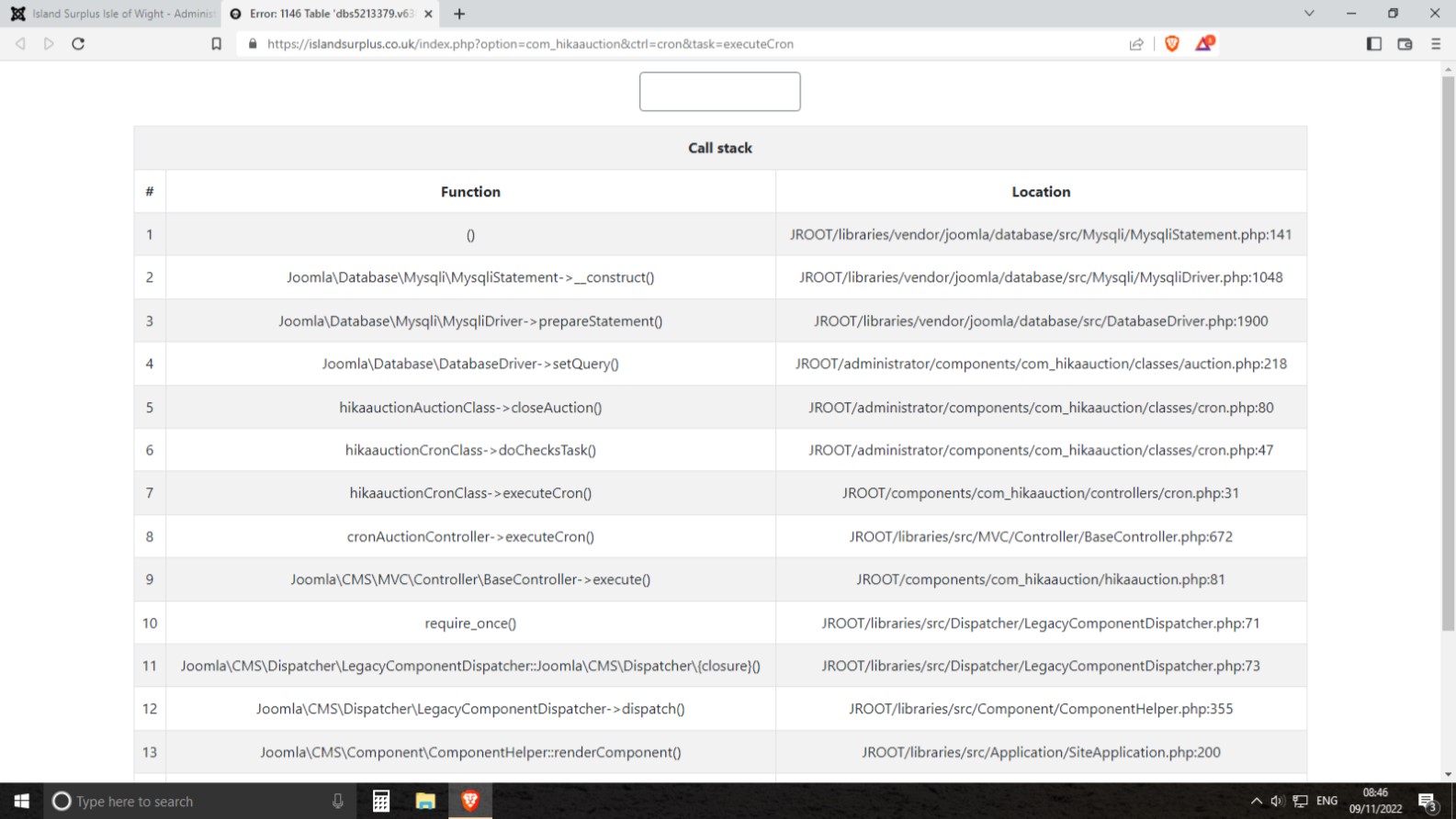

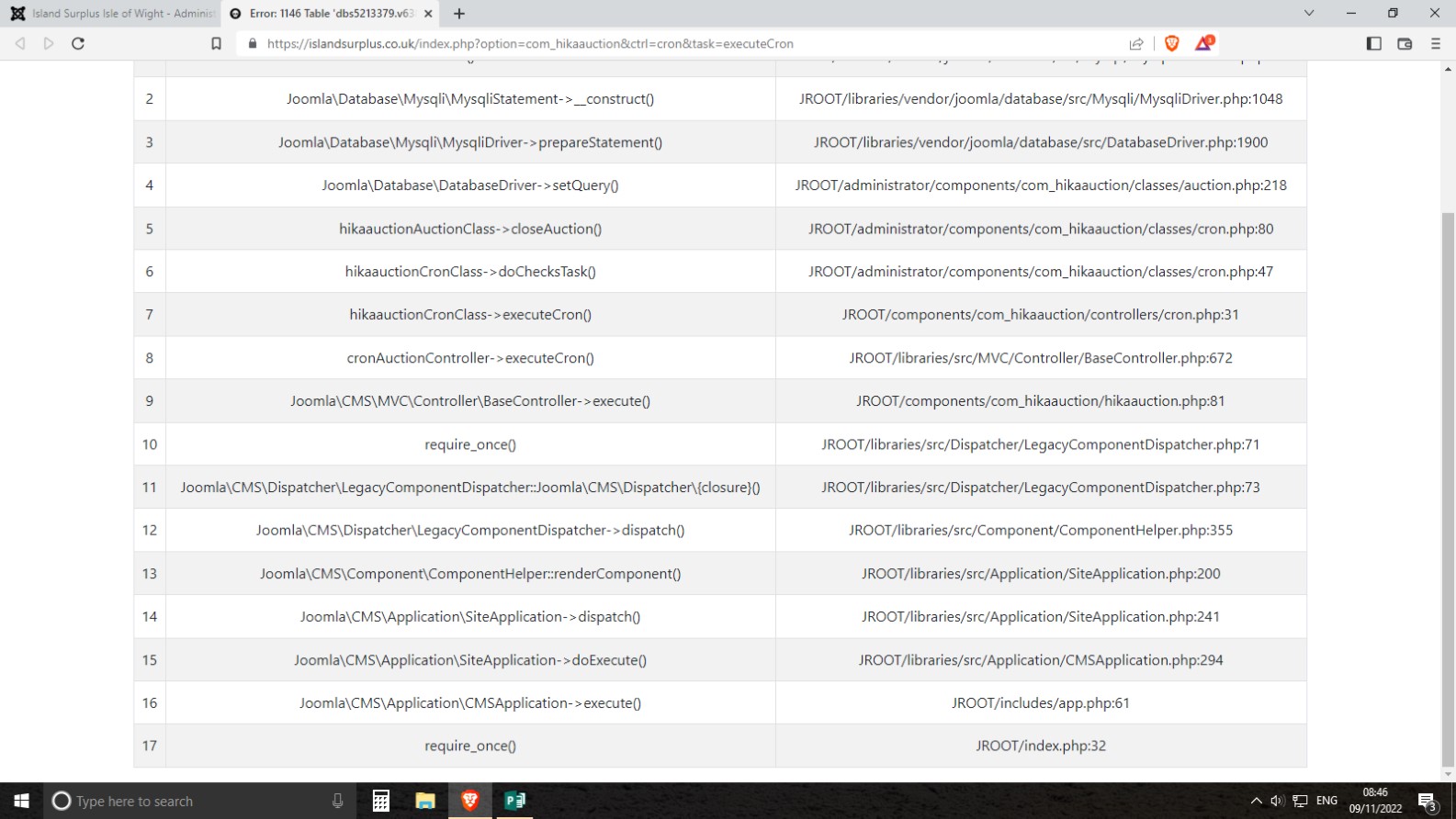

after our first auction ended no notification emails nor links for people to pay for their lots were sent.
I had a notification to say the cron job had been cancelled due to too many failed attempts then when forcing manually from the auction configuration had this message: Table 'dbs5213379.v638a_hikamarket_vendor' doesn't exist
Running the debug gave the error report in the images attached.
There is no where to see orders, invoices or anything created from the hika auction system for wining lots.

3 years 10 months ago #346391
That's an issue I replied to several months ago here:
www.hikashop.com/forum/hikaauction/90355...ications.html#339855
So you can follow the solution there and it should fix the problem.
I've also made a patch in HikaAuction so that even without running a mass action like explained there, it should work if you just update HikaAuction.

3 years 10 months ago #346401
Hello Nicolas,
thanks for your response.
doing it manually didn't cure it, all I got was: 1146
Table 'dbs5213379.v638a_hikamarket_vendor' doesn't exist.
Updating seems to have sorted it.
I am still a little confused though. Even though the cron has now been sucessful, there is no where I can see orders, invoices or details of what a customer has won, apart from the product listing itself in the auction section of Hikashop that shows the highest bidder, am I missing something?

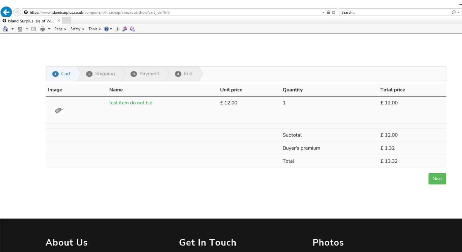

Now have configured the auction checkout workflow but now trying to work out why I cannot proceed through the process when in the shopping cart.
After being sent an email to "complete your order" I now follow the link, Login, go to my Cart and see my item but cannot proceed to the Shipping and payment option as the "next" button does nothing, not sure where to look next.

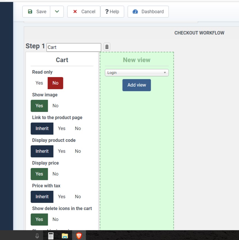

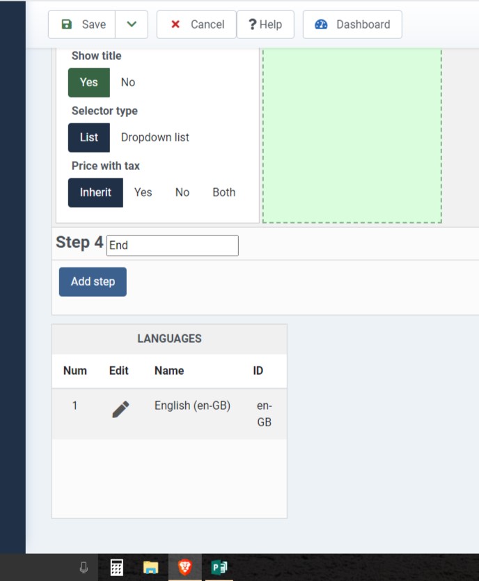

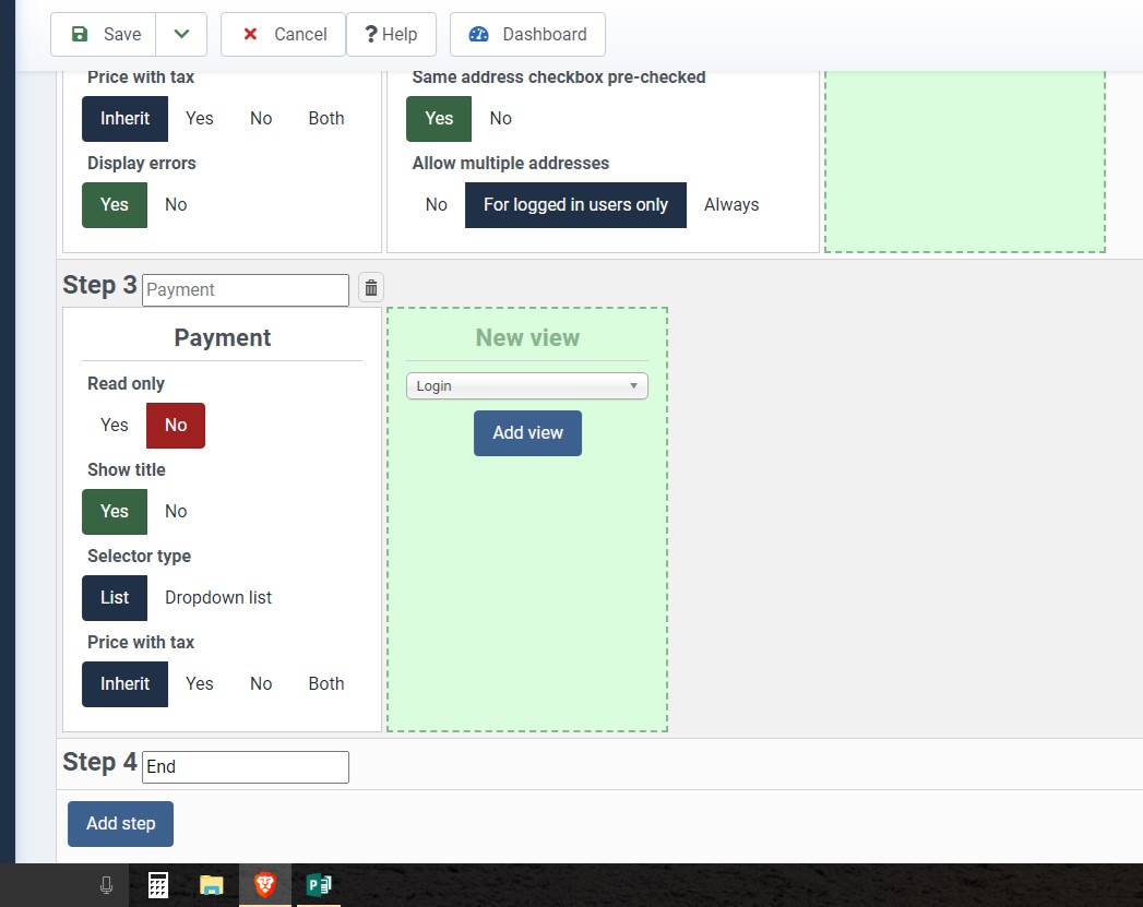

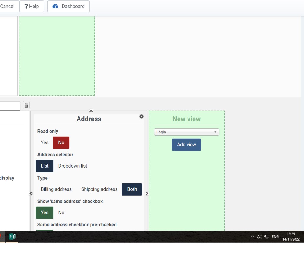

  • Posts: 16
3 years 9 months ago #346520
Here you go Nicolas.
hope you see something obvious.
thank you
Lee
  • Posts: 86105
  • Thank you received: 14206
3 years 9 months ago #346526
It's not clear on your screenshots, but it seems that you've added the "address" view and not the "login" view to your checkout workflow. The login view is required if you want to have the "address" view as an address needs to be attached to a user.
I think it might be why the system is not letting you go through the whole checkout as it can't have you select your address.
