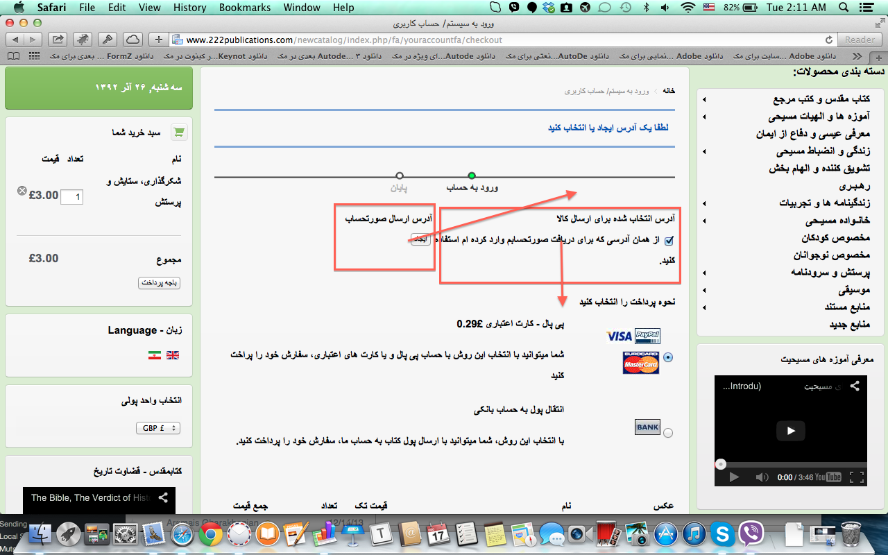

Thanks! That solved my problem completely, now there's a new problem. When I add multiple addresses in billing and shipping, they are so close to one another. as you can see in this screenshot: www.dropbox.com/s/pxh0euye67uen2d/Screen...12-19%2021.42.47.png
how can I set a border or line between them or somehow make it clear that these are two separate addresses?

12 years 7 months ago #137256
hi
How can i set space .... ( border margin padding, :after !!! <br/> )
use browser debugger to see witch html tag element define the edge of each adress box ( surround box ) .
Add to the class attaxch to the element
a margin bottom for the top adress
a margin top for the bottom adress
a border can have color
margin have no color is locate outside border
padding have no color is locate inside border around content text
collapse can occur for border /margin in some cas ( block sibliing adjacent block )
give access to the webpage is the best way if someone want to help you : what you see by rendering CS browser don't show how it is implemented ( html and css code ) !
Hope this ll help you !!

12 years 7 months ago #137324
You can use:
.hikashop_checkout_address_left_part tr{ margin-bottom: 10px !important; border-bottom: solid 1px #ccc !important;}
to add space between two addresses, and a border at the bottom/
The following user(s) said Thank You: PubSite

12 years 7 months ago #137409
I did as you said but nothing changed. I refreshed the page even with SHIFT held down... but this is what I see:
www.dropbox.com/s/o68rhenorvm1x42/Screen...12-20%2019.07.13.png
www.dropbox.com/s/60emomdgemstlqk/Screen...12-20%2019.07.19.png
  • Posts: 846
  • Thank you received: 92
12 years 7 months ago #137420
I send you a private mesage ( make error not refer to second image / problem ) .
the image have been remove from your dropbox account ( the one refer to space problem !!! )
does your problem have been resolve ?
could you annotate comment : add text arrow ...to show where the problem is locate in you capture screen ? .
This problem must be easy to resolve ...
regard's
Last edit: 12 years 7 months ago by lionel75.
  • Posts: 86042
  • Thank you received: 14174
12 years 7 months ago #138141
You should also add that css:
.hikashop_checkout_address_right_part tr{ margin-bottom: 10px !important; border-bottom: solid 1px #ccc !important;}

  • Posts: 100
12 years 7 months ago #138144
and by the way, the code you gave me, just like the code you gave me the other time, isn't working.. I don't know what's the problem..
SCREENSHOT after code : www.dropbox.com/s/cxkarfzm73wxrww/Screen...12-31%2014.39.27.png
and SCREENSHOT of how I've entered the code in CSS : www.dropbox.com/s/7endb47zl30lyrw/Screen...12-31%2014.40.26.png

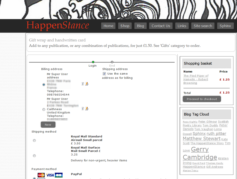

  • Posts: 43
12 years 6 months ago #142190
I am having the same problem regarding spacing between the checkout addresses, and have tried adding the code shown earlier in this thread to the CSS without success. I guess that my template is overriding the Hikashop CSS, and I've spent hours trying to work out what I need to change but I'm totally stumped. If anyone can help, I'd be very grateful.

  • Posts: 86042
12 years 6 months ago #142227
I don't see any problem with your addresses selection interface. Could you to a screenshot and explain what is the exact problem ? What do you want to move where ?
  • Posts: 43
12 years 6 months ago #142288
Apologies, Nicolas. Of course I should have included a screenshot. :oops: Here it is:
My problem is that when there are multiple addresses to choose from, there is no space between the addresses.
  • Posts: 2334
  • Thank you received: 403
12 years 6 months ago #142302
Hi there,
You can try to add the following css to your frontend css file:
.hikashop_checkout_billing_address_info{
  display: block;
  margin-top: 10px;
It might not be the most elegant way but it should work :)
The following user(s) said Thank You: SarahW
  • Posts: 43
12 years 6 months ago #142325
Brilliant - it worked! Many thanks for that, Eliot :)
