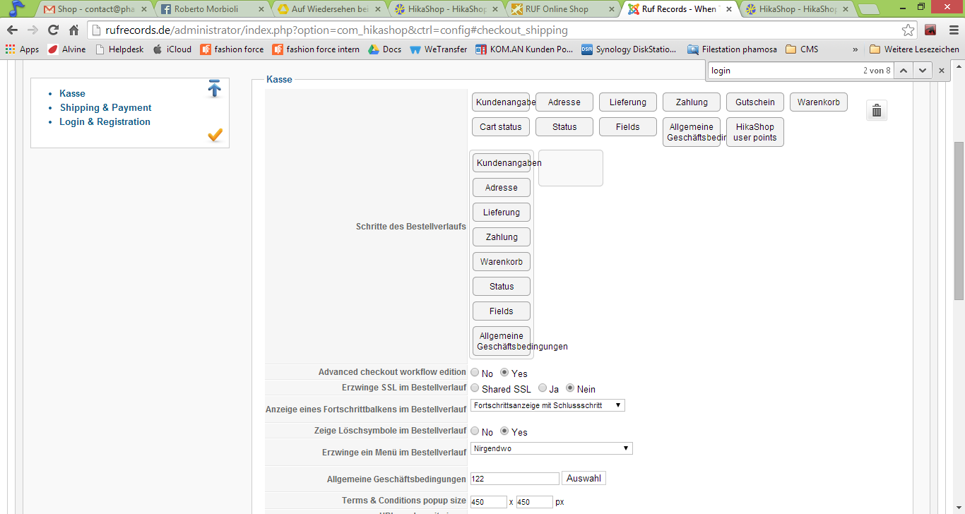

-- url of the page with the problem -- : www.rufrecords.de
-- Joomla version -- : x2.5.19
-- PHP version -- : 5.4.9
-- Browser(s) name and version -- : Firefox or Chrome
The FINISH Button at the end of the checkout flow does not work, the page loads again but does not do the checkout and does not forward the order.
Here is a screenshot of the checkout flow:

It means that the system is not creating the order because something is missing.
Please make sure that your template is able to display error messages:
www.hikashop.com/support/support/documen...tibility-issues.html
Then, turn on the "error reporting" and "debug mode" options of the Joomla configuration.
Then, try again. Do you get any error displayed after clicking on the "Finish" button ?

The solution of cbadmin is probably different from the solution you need because the cause of the problem is probably different.
Please follow the instructions I provided here and let us know what you find:
www.hikashop.com/forum/checkout/868270-f...redirect.html#156273
  • Posts: 65
12 years 2 months ago #159583
I turned on the Debug Mod but i don't know what to with it then. on the frontend I get this DEBUG frame on every module but when i click the FINISH button, nothing changes in these debug frames.
sorry, but i'm really not an expert..
would you like to have an access to the site (by email?)
thanks
carolin
  • Posts: 65
12 years 2 months ago #159677
hi nicolas, it is REALLY urgent, the shop does not work at all.. could you please have a look why the checkout does not work anymore?
best
carolin
  • Posts: 86042
  • Thank you received: 14174
12 years 2 months ago #159715
I did a test but creating an order works fine on your website. I was able to click on the Finish button and then I saw the message of the bank transfer payment method telling me to proceed with the payment.
For the credit card payment method, I didn't test since obviously I don't want the payment to be made, but since it's a third party payment method that we didn't develop, if there is a problem with it on the checkout, you need to see that with the developer of the payment plugin.
Time to create page: 0.097 seconds
