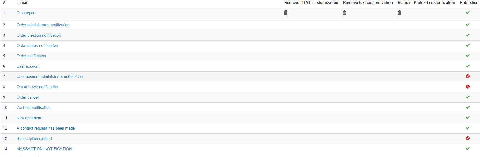

  • Posts: 86042
  • Thank you received: 14174
11 years 2 months ago #203775
Simply disable the "order creation notification" and "order admin notification" emails and you'll receive only the emails after the order is confirmed.
For the cancellation, the customer we'll get an email if you activate the user notification when you change the status, so that should not be a problem.

11 years 2 months ago #203841
Nicolas,
Thanks for your reply.
Since my posting, I've done a test. At the moment, I (as admin) and the customer are not receiving any confirmation emails ?
Does the customer get an email if the order status is changed automicaly because of not finishing the payment proces (SIPS2.0) ?
As far as my test have been, they do not seem to get an email.

  • Posts: 86042
11 years 2 months ago #203850
When the order is cancelled automatically by the payment plugin for a payment notification, no notification is sent to the customer. It's only sent to the admin.
You would have to add the line:
$history->notified = 1;
before the line:
$this->modifyOrder($order_id, $this->payment_params->invalid_status, $history, $email);
in the file plugins/hikashoppayment/atos/atos.php
