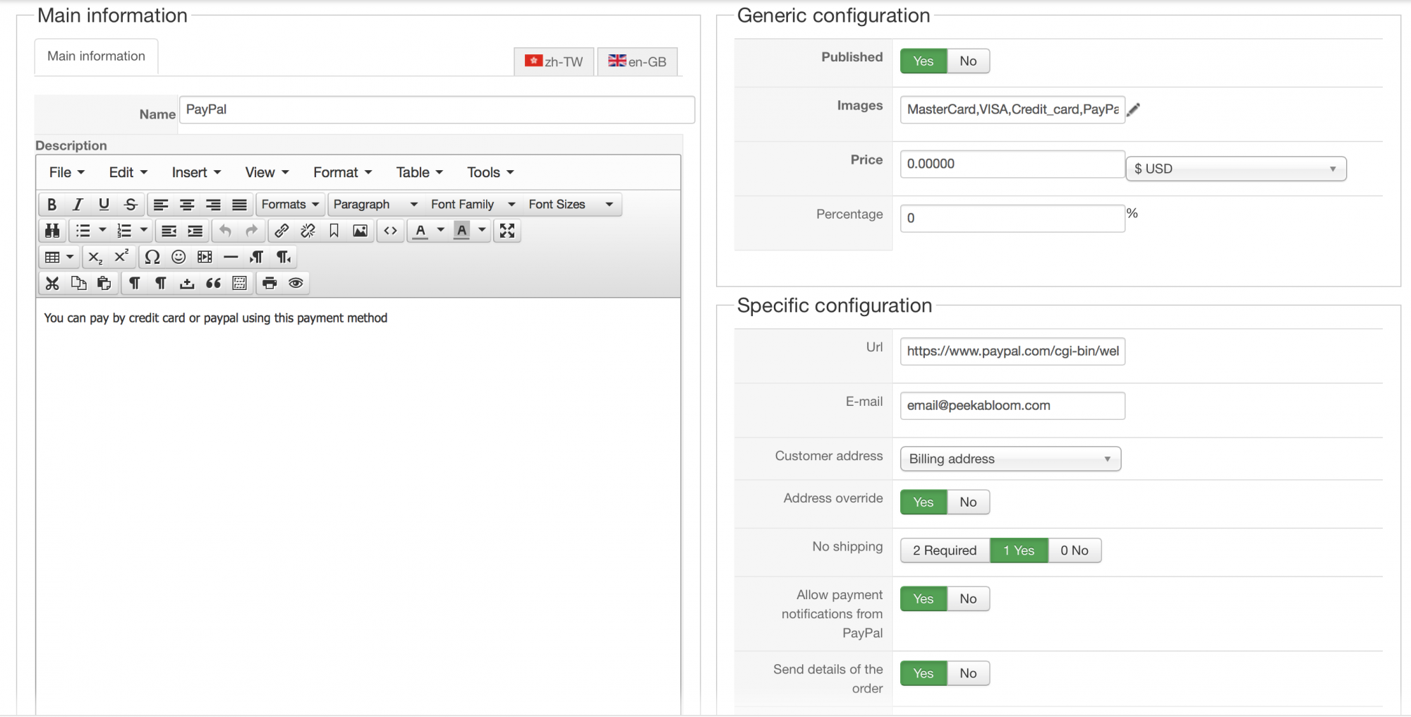

1) I have activated the HikaShop Paypal payment plugin. I it working when I tested it using sandbox Paypal credentials once. But that was before I added products and moved the checkout items around. I have tried again with it connected to the same sandbox Paypal credentials, all it would do is reload the last checkout page with no warning message. I have debug mode enabled but in the debug file, it shows no data. I am not sure what else to try.

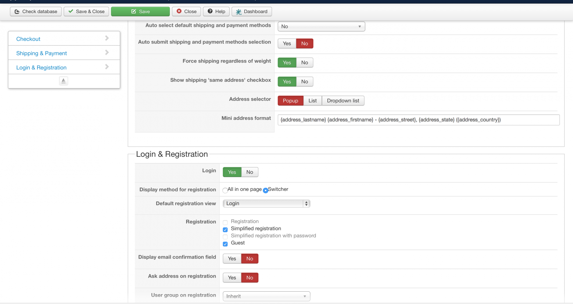

2) Also, we are having a lot of problems with the checkout either showing a checkbox to have the same billing and shipping address, or no checkbox but the system auto-populate the same info into the shipping address anyways. Since we can't force the system to leave the shipping address blank, I wanted to remove it completely. But the Front CSS is set to 'none' as oppose to 'default'. If I enable 'default' then I notice the template that we use starts to look funny. Is there any other (easy) way to either have a cleared shipping address fields or remove this section completely?

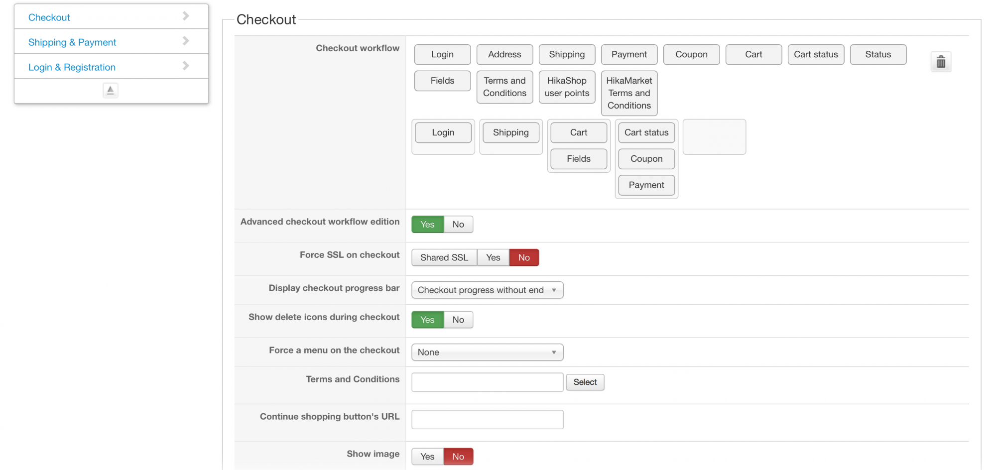

My settings in Paypal and Systems > Configurations > Checkout is attached in case if they are useful. I will continue to browse on here for a solution, any suggestions or advice would be much appreciated.

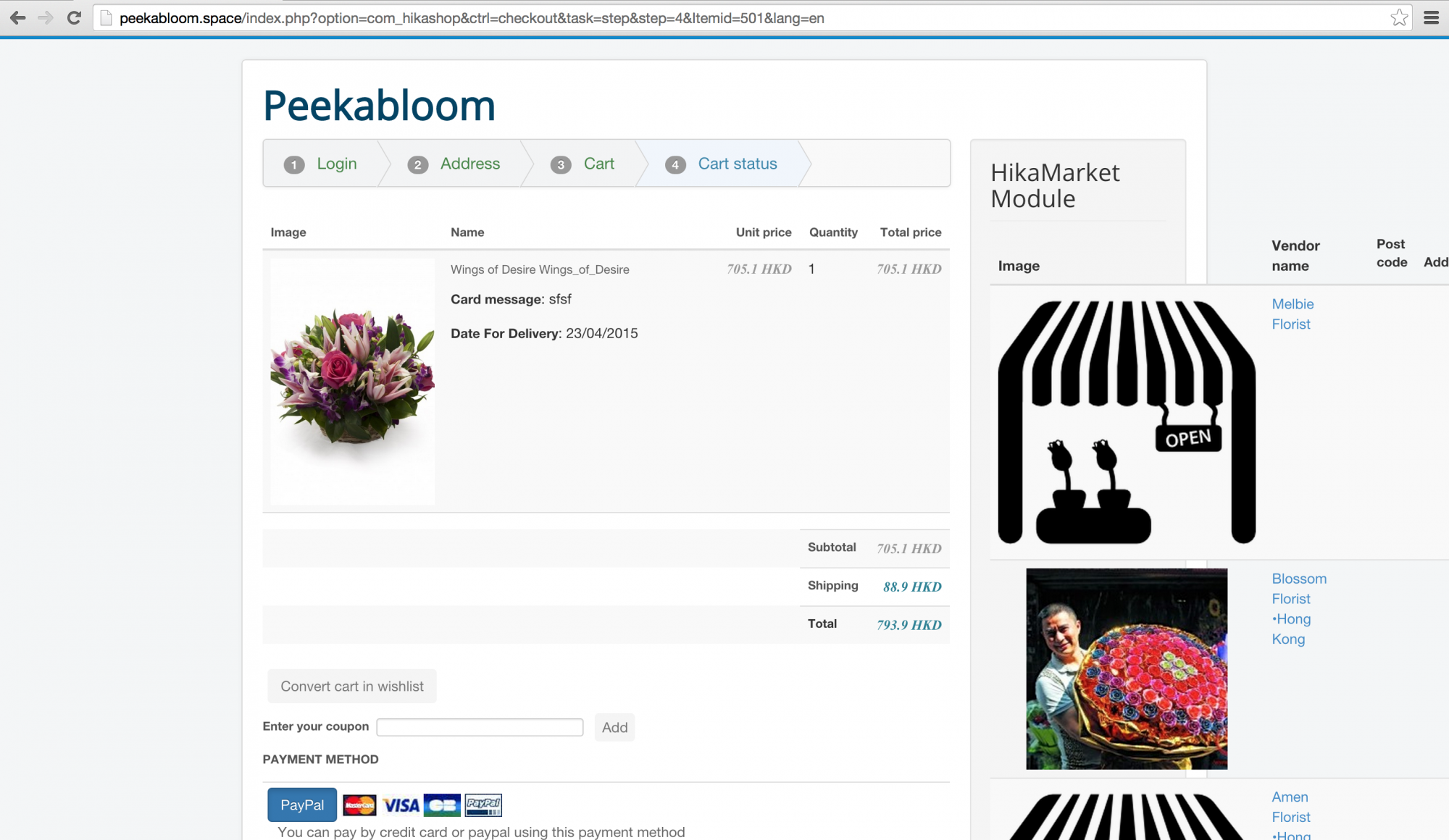

I took a screenshot of the final checkout page too, but not much to see:
Would you have any advice on what else I could check to get it working?

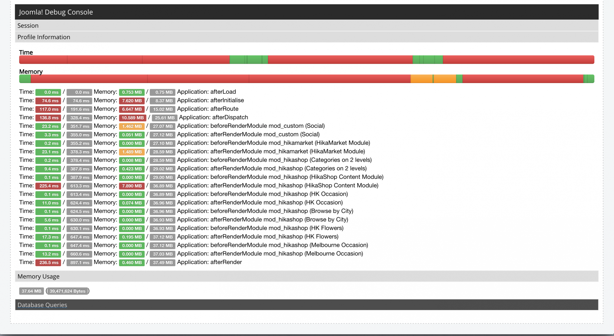

With the Flative template (from Joomlavi) in use, no error message or anything different would show up. I changed the template back to Protostar, then I see at the bottom of the screen the Joomla Debug Console. I don't know if it is giving any useful information relating to this problem. Below is a screenshot of all the tabs that contain data:
I feel so stuck now and we cannot turn our business back on without the ability to receive money... If you have any advice on this matter, it would be much appreciated.

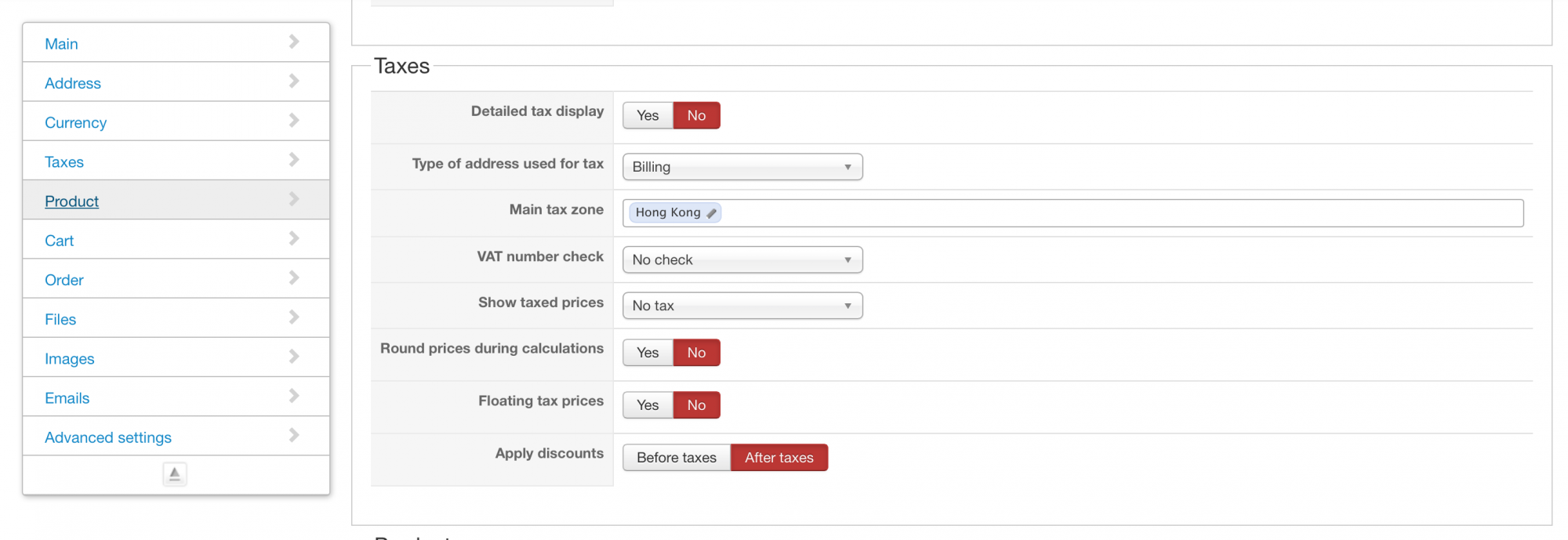

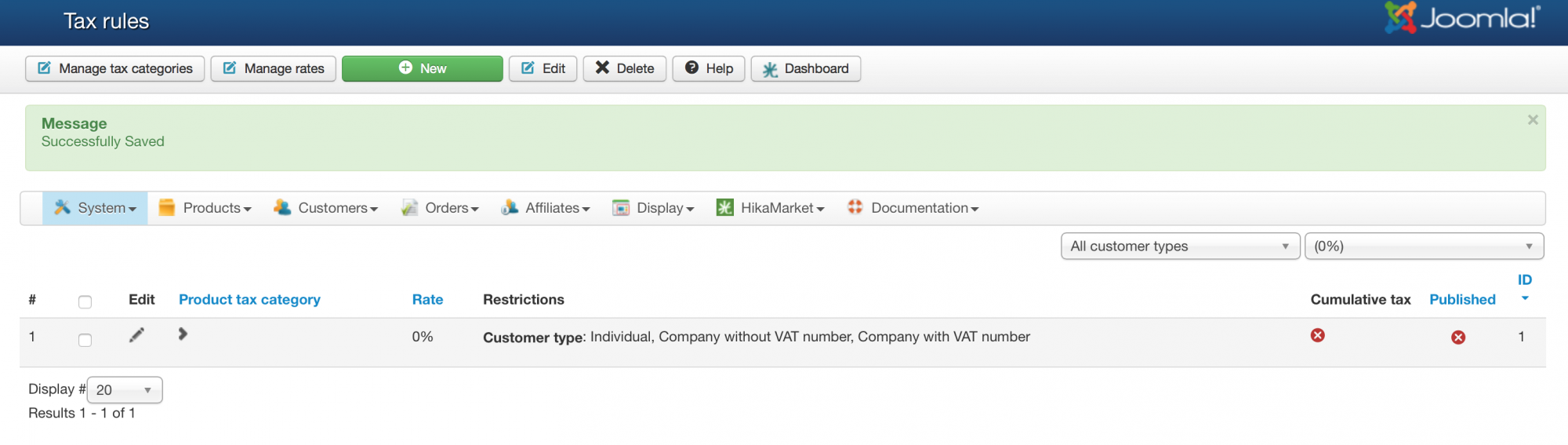

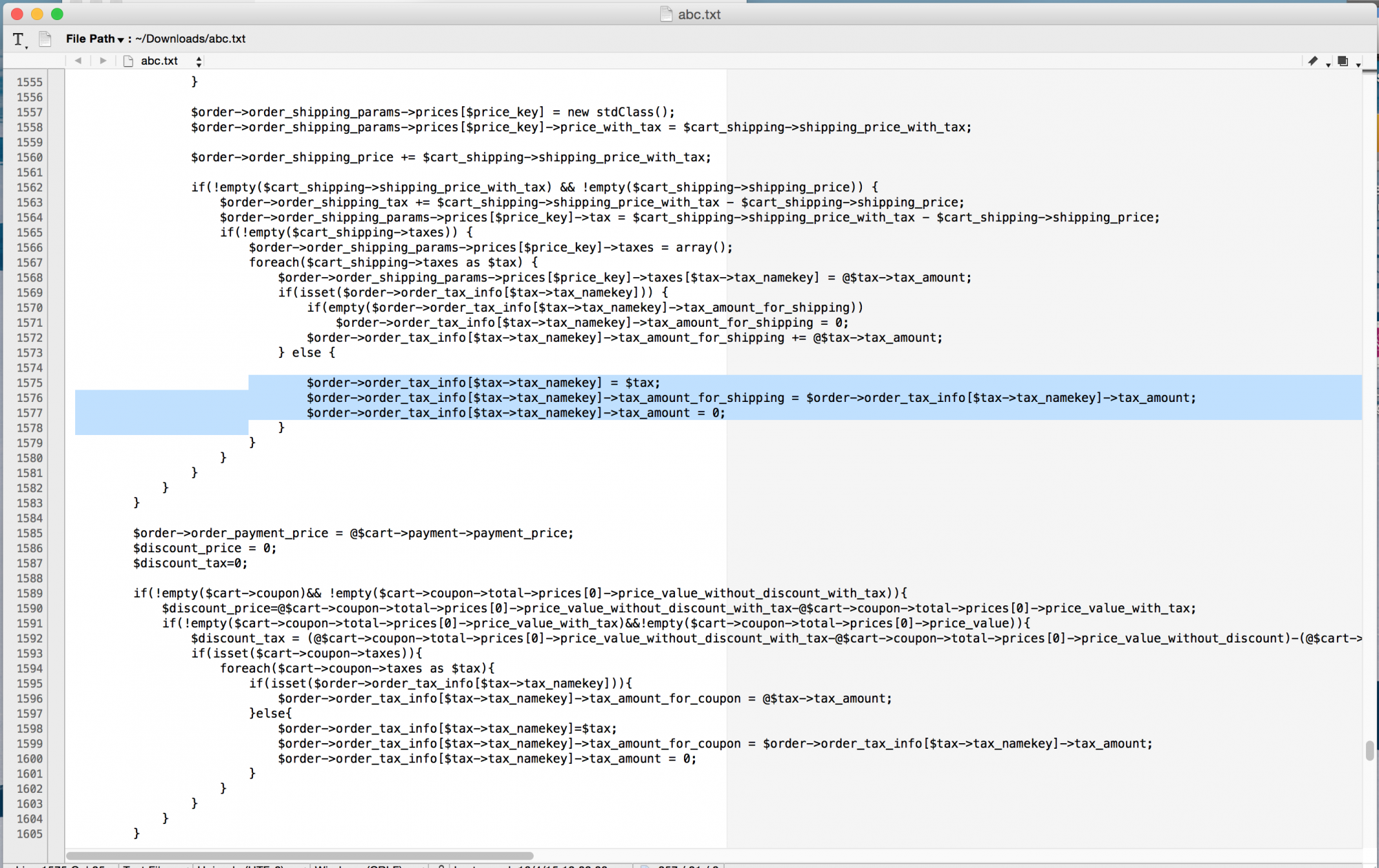

Just want to add a bit more insight into this issue. I had a programming (non-Joomla) friend to take a look at the site's checkout php files. Upon a quick scan, he believes that the problem may be caused by the $tax codes. I have checked as best as I can to ensure that that are no tax settings turned on (because we have no intention to collect any tax for any reason). He found the following posts relating to this issue and have tried all of the solutions offered, including adding a '@' to the code like this: @$tax->tax_amount;...but nothing is working.
I am not a coder so I have no idea how to understand or fix this issue, sadly, so your help is extremely appreciated! Is it possible that this is the issue that is preventing the checkout from connecting to Paypal...and also...how to fix it?
