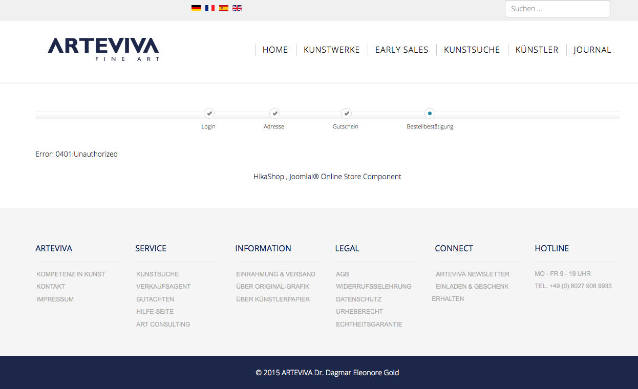

  • Posts: 21
10 years 6 months ago #228382
Hi and thanks for the tip.
I updated Hika Shop and changed to Protostar and at least I got redirected to Sofort with an error now. ( screen )
So I guess its the Template, its a shaper helix3, has this template given Problems before?
Thanks in advance,
Wolfram
ps. Shaper Helix wont give advice...
"Thanks for your query. We are really sorry to say that, we can't give you third party joomla extension support. Please contact with Hika Shop forum."
Last edit: 10 years 6 months ago by immagine1967.

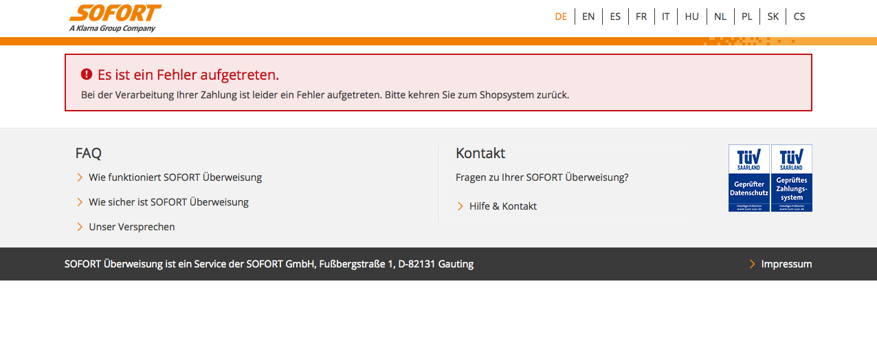

  • Posts: 26380
10 years 6 months ago #228396
We are not able to read/understand the error message ; would it be possible to have it in "text" instead of an image or have a translation of that error message in English ?
We do not have specific issues with helix3 ; but it is possible that you have some javascript errors in your page which would explain why the checkout could not work properly.
  • Posts: 21
10 years 6 months ago #228492
Hi, the error isnt important right now. I have checked my settings, shut Mootools off and on and disabled all components i dont need.
Would it be possible to check the backend to see where the conflict is?
s553057611.online.de/av-2016
Thanks again but is anyone there? I find Hika Shop great but if i cant pay with it it is not worth the money.

10 years 6 months ago #228778
Regarding the Sofort error message :
An error occurred
Unfortunately, an error occured when processing your payment. Please return to the shop system.
You should probably directly ask them about that issue to have more information about it.
Also note that the Sofort payment plugin wasn't originally developed by us but apparently by "LG solutions".

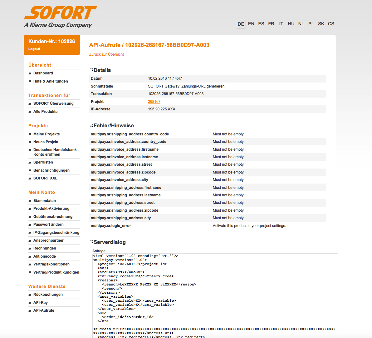

and the error xml
<?xml version="1.0" encoding="UTF-8"?>
<new_transaction>
<transaction>102026-268167-56BB0D97-A003</transaction>
<payment_url> www.sofort.com/payment/go/74ca36a41645cd...9700a9817469884f9d1f </payment_url>
<sr>
<errors>
<error>
<code>8010</code>
<message>Must not be empty.</message>
<field>shipping_address.country_code</field>
</error>
<error>
<code>8010</code>
<field>invoice_address.country_code</field>
</error>
<error>
<code>8010</code>
<field>invoice_address.firstname</field>
</error>
<error>
<code>8010</code>
<field>invoice_address.lastname</field>
</error>
<error>
<code>8010</code>
<field>invoice_address.street</field>
</error>
<error>
<code>8010</code>
<field>invoice_address.zipcode</field>
</error>
<error>
<code>8010</code>
<field>invoice_address.city</field>
</error>
<error>
<code>8010</code>
<field>shipping_address.firstname</field>
</error>
<error>
<code>8010</code>
<field>shipping_address.lastname</field>
</error>
<error>
<code>8010</code>
<field>shipping_address.street</field>
</error>
<error>
<code>8010</code>
<field>shipping_address.zipcode</field>
</error>
<error>
<code>8010</code>
<field>shipping_address.city</field>
</error>
<error>
<code>8057</code>
<message>Activate this product in your project settings.</message>
</error>
</errors>
</sr>
</new_transaction>
Last edit: 10 years 6 months ago by immagine.
10 years 6 months ago #229572
That Hikashop Sofort Payment plugin is only using their Library, so these error are launched either by their Library or by their API.
In your case the best solution will probably be to directly ask more advice from the person who created that plugin or from Sofort.

10 years 6 months ago #229585
1.
As I said, The LG solutions was the name which was added on the XML of the Sofort plugin, but I think that you should contact the user "Boopoo" that you can find through that thread :
www.hikashop.com/forum/payment-methods/8...elopment.html#131701
2.
Regarding your "Must not be empty" errors, you should probably test it by adding through the "sofort.php" file, these lines :
if(isset($order->cart->billing_address))
			$Sofort->setSofortlastschriftAddress($order->cart->billing_address->address_firstname, $order->cart->billing_address->address_lastname, $order->cart->billing_address->address_street, '', $order->cart->billing_address->address_post_code, $order->cart->billing_address->address_city, $order->cart->billing_address->address_title, $order->cart->billing_address->address_country->zone_code_2);
just after this line :
$Sofort->setNotificationUrl($notify_url);
3.
Regarding the "Activate this product" error message, you should maybe ask it to Sofort.
