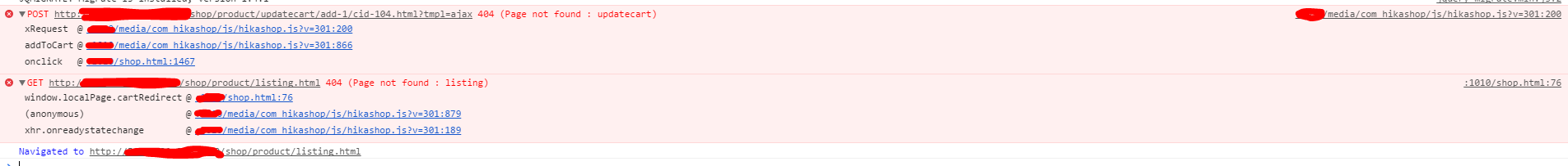

9 years 3 months ago #267164
Hi nicolas.
That indeed seems to have solved the issue, however we seem to be having a issue with the buy now buttons and products which doesn't have any "options", to see the issue click the "Buy now" (On the Product listings page) for the product called "eMedia My Guitar v2" or any product from the "MUSIC NOTATION SOFTWARE" Group.
Clicking the Buy now seems to produce 2 errors in the console looking like this:
Last edit: 9 years 3 months ago by earmaster.
  • Posts: 86027
  • Thank you received: 14172
9 years 3 months ago #267166
I don't see why it would do that.
The link on the add to button is correct. It seems to be a SEF related issue.
Do you have a third party SEF system like sh404SEF ?
If you turn off the SEF settings of Joomla, does it work ?
