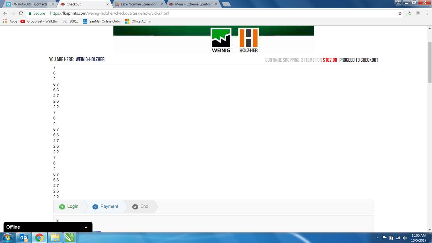

-- url of the page with the problem -- : www.lknprints.com/weinig-holzher/
-- Joomla version -- : 3.8.1
-- PHP version -- : 7.0.12
Periodically we have some weird numbers showing up in checkout. It doesn't seem to do it all the time, but when it does it's in the content area of the check out. See attached for an example.
We are using some template overrides, but we have disabled those when the problem happens and they show up even without the overrides.
Any ideas?

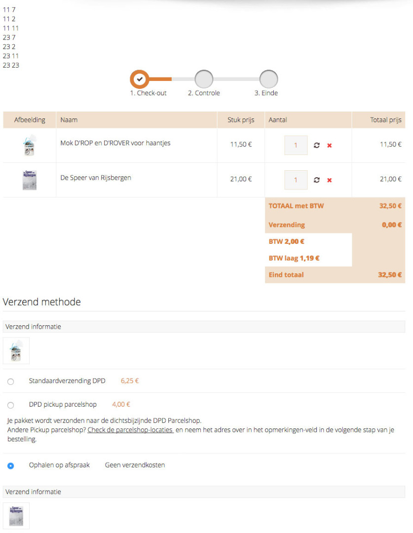

  • Posts: 11
8 years 9 months ago #280415
I experience the same thing, but only with products with warehouse-selection. Maybe that points into a direction.
Same system specs as BNRBranding.
Regards, Arjan
  • Posts: 42
8 years 9 months ago #280418
Arjan wrote: I experience the same thing, but only with products with warehouse-selection. Maybe that points into a direction.
Regards, Arjan
Hmm. We use warehouses for our products, but products are only ever in one warehouse. Do you use AWOcoupons?
The way this site is setup is basically a bunch of independent stores. Each store is a product category that has it's own warehouse. This allows us to use different shipping options for each "store". I can't seem to replicate the issue, but the site owner has it happen all the time. I inspected the code when I did see it happen and it's definitely showing up within the Hikashop part of the code.

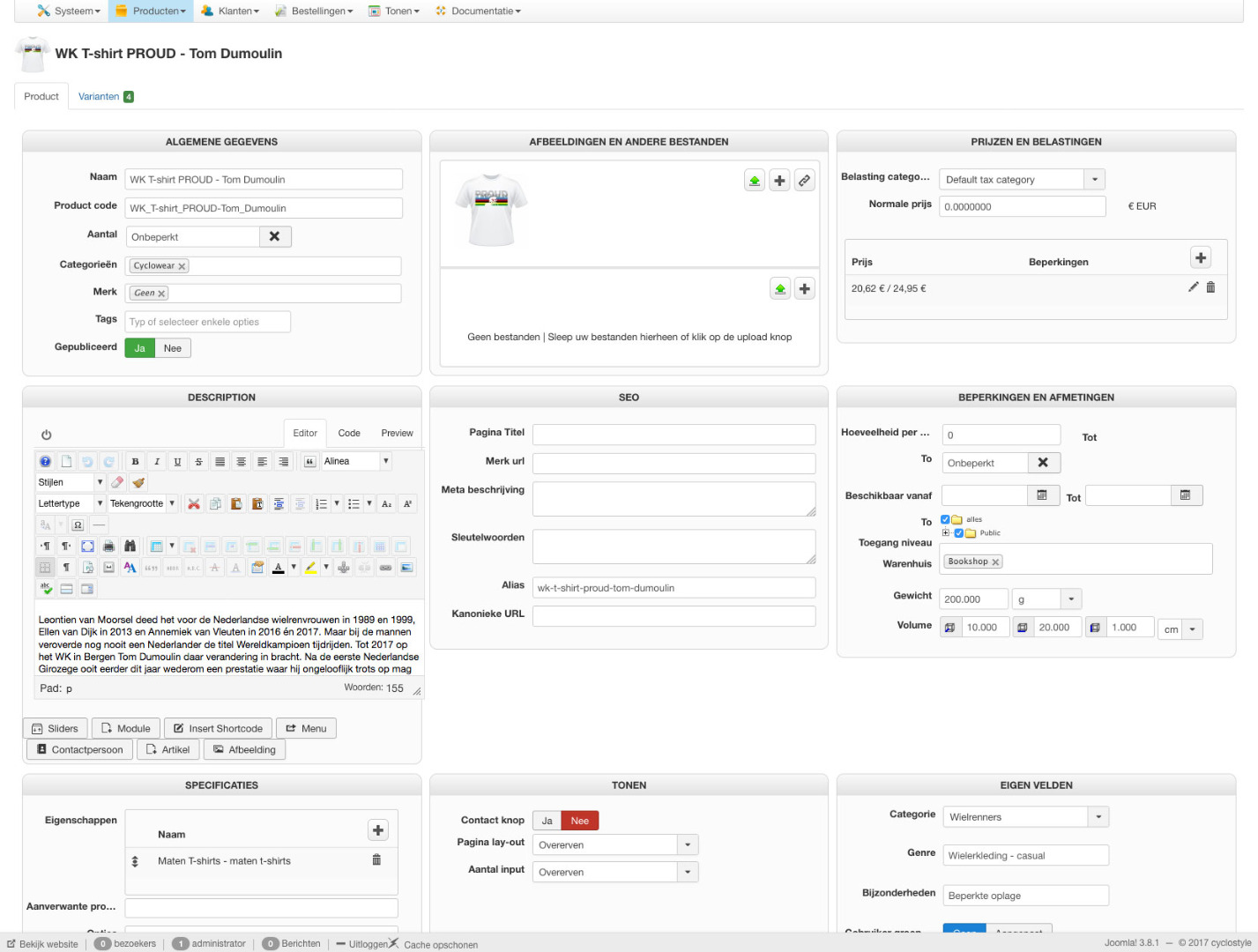

  • Posts: 11
8 years 9 months ago #280628
Hi Guys, sorry it took a while but I was caught up in other work.
The website is located at cyclostyle.com/
When you go to cyclostyle.com/shoppen/Artikelen/cyclowear and select for example WK T-shirt PROUD - Tom Dumoulin ( cyclostyle.com/shoppen/Product/wk-t-shirt-proud-tom-dumoulin ) and add to cart you will notice the numbers on the left, underneath the breadcrumbs.
See attached screenshot for the settings.
ps
after add to cart there is no popup, as I use JM Creatrix which is no longer stable popups don't work anymore. Working on an update with new template!
