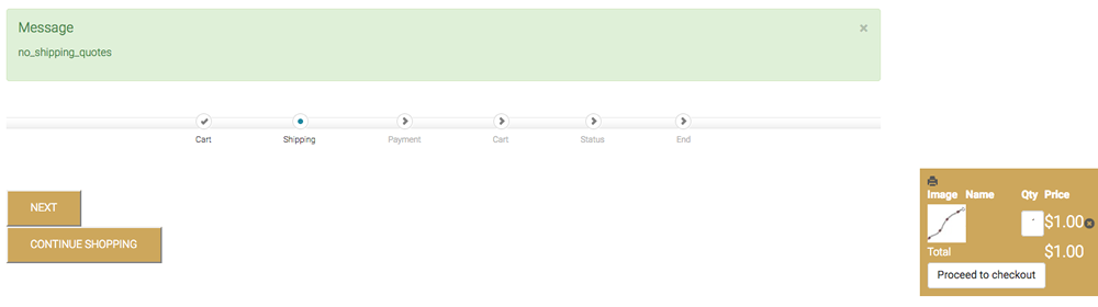

-- Error-message(debug-mod must be tuned on) -- : Message
no_shipping_quotes
I have the checkout workflow on this development site the exact same as my production site however I am receiving a block on the checkout process here. Workflow is Cart/Login/Address, Shipping, Payment, Cart, Status/Fields.
On this checkout process, when proceeding to Shipping, I receive Message: no_shipping_quotes and thus can't go any further. Haven't been able to get anything from the archives for this message and have more then triple checked my settings but can't figure this out. Thanks for any advise.

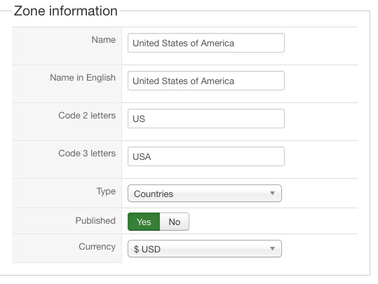

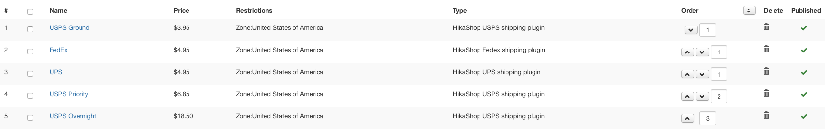

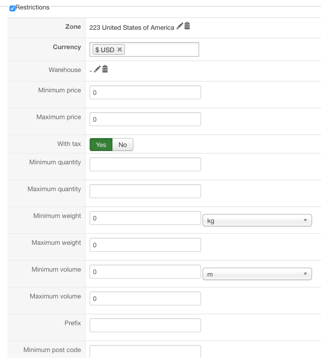

Here's some more info. The error message just indicates no_shipping_quotes and it occurs as sson as you select Next in the checkout process. Looks like you registered an account so if you would, just go to silverconnection.cloudaccess.host/index....uct/6178-anklet-9996 and you can just directly add my test item. It appears that all my zone settings are set to 223 (usa). I am using an address in the US as my mailing address for my tests. Also attached are setting for usps ground, as an example, from the authorize.net payment option. Please let me know whenever additional information you might need.

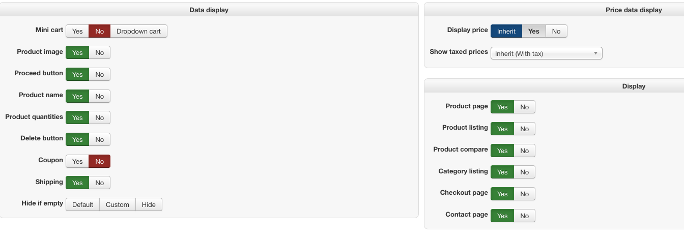

Two more screen shots. The shipping methods and also the hikashop cart module.
