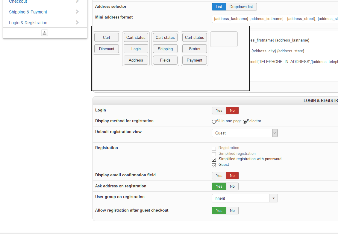

We are trying to set up registration during checkout. We have configured our checkout as per screenshot. Now the issue.

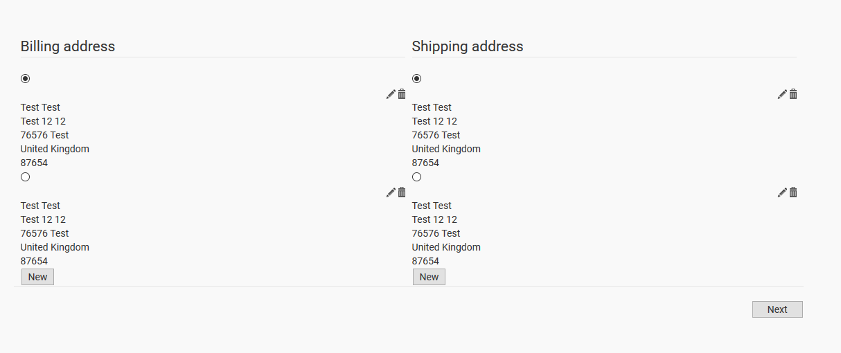

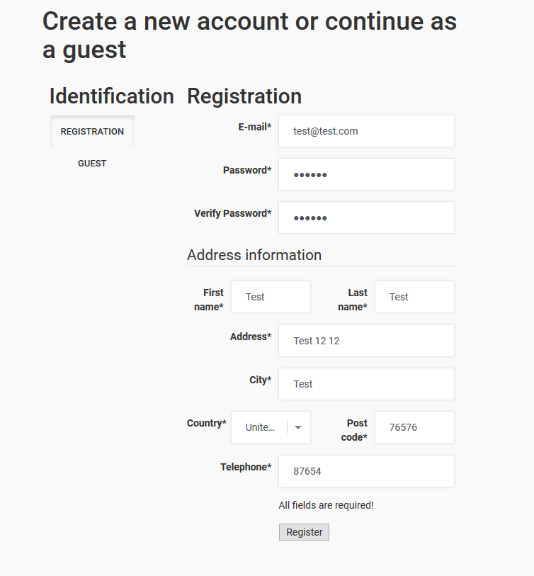

When user comes to address details page and proccess as a guest all goes fine but if he changes hes mind, goes back and register account the address block has 2 same shipping and billing addresses which makes no sense because address was not modified...
As i understand hikashop first save address for guest and later it does same after user register. So we have same address twice.
Is there a way to avoid it??

you would have to create a small plugin to set the address_published to 0 for all the addresses already in the table hikashop_address with the same address_user_id in the onBeforeUserUpdate trigger of a plugin of the group "hikashop".

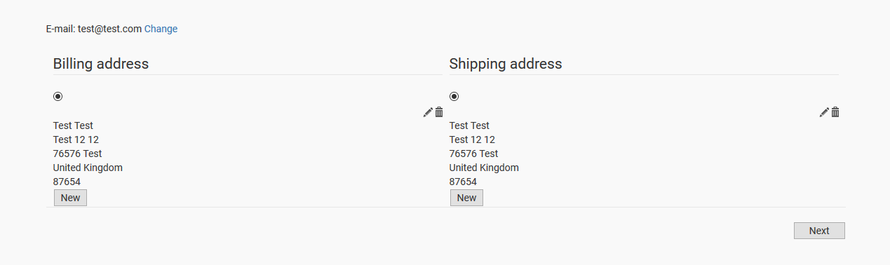

However we do have other issue regarding address. Could you please explain how different billing/shipping address works?
As example after user register he see 1 billing address and 1 shipping address. Now if user edit (not delete, not creat new) billing address the shipping address also gets edited and takes same values from billing address. Why would it do like that? When editing billing address user expecting that shipping address wont be changed... So to have different billing user must create new billing address and then toggle radio buttons between addresses...but honesly everyone would edit it if it's already entered.
What we are looking is to have only one billing address and only one shipping address with edit and delete buttons only. Those addresses shouldn't be connected between when editing...
Now not sure how this could be done when we have such behiviour described above.
Any thoughts?

For now the address_type field is not supported by the address block of the checkout.
So an address is an address and it can be used for either billing or shipping.
If you modify an address, the change will display in shipping and billing if the address is selected in both.
If you don't like that, you could potentially just remove the edit buttons (with CSS or view overrides).
That way, the customer could either delete an address, or create new addresses, or select a different address.

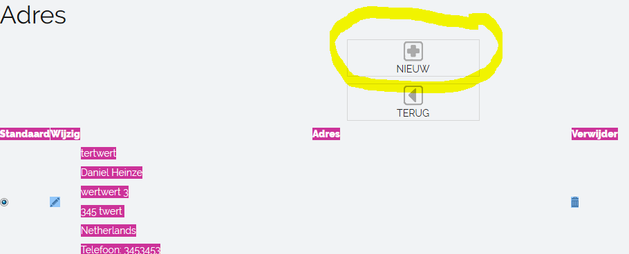

I need to delete the "New adress" Button when I go as an Shop-User in the Frontend on: My Profil > Adress >
There are 2 Buttons above (Screenshot): NEW and TERUG (back).
My customer don't want to give the Shop-user two adresses. There shall be no way to create another kind of adress.

You can do it by adding such CSS on your website:
.hikashop_address_listing .hikabtn:first-child {
display: none;

Hi, thank you!! First it didn't work - than I used
#hikashop_address_listing .hikabtn:first-child {
display: none;
instead of
display: none;
Now everything is fine :)
