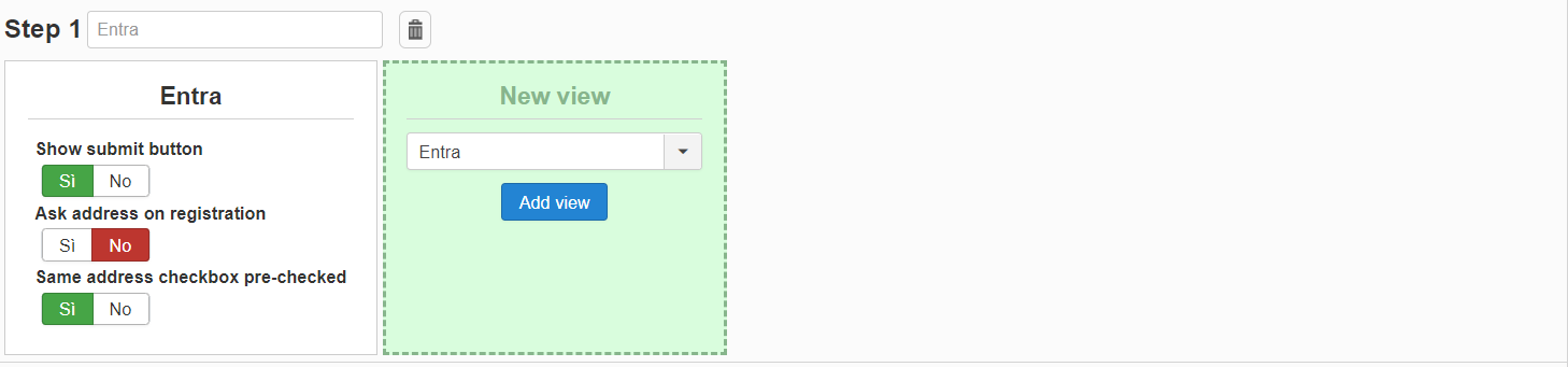

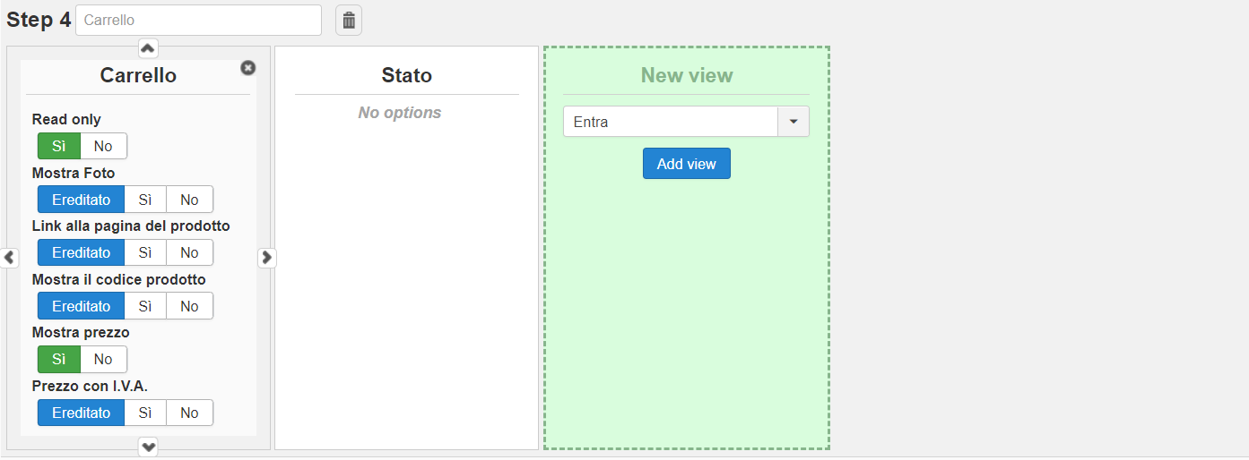

After updating Joomla (3.9.5) and Hikashop (4.0.3) the last step of the checkout ( dev.featfood.it/completa-ordine/checkout/task-show/cid-4 ) return to step 2 ( dev.featfood.it/completa-ordine/checkout/task-show/cid-2 ) after confirmation.
Attached the checkout flow.

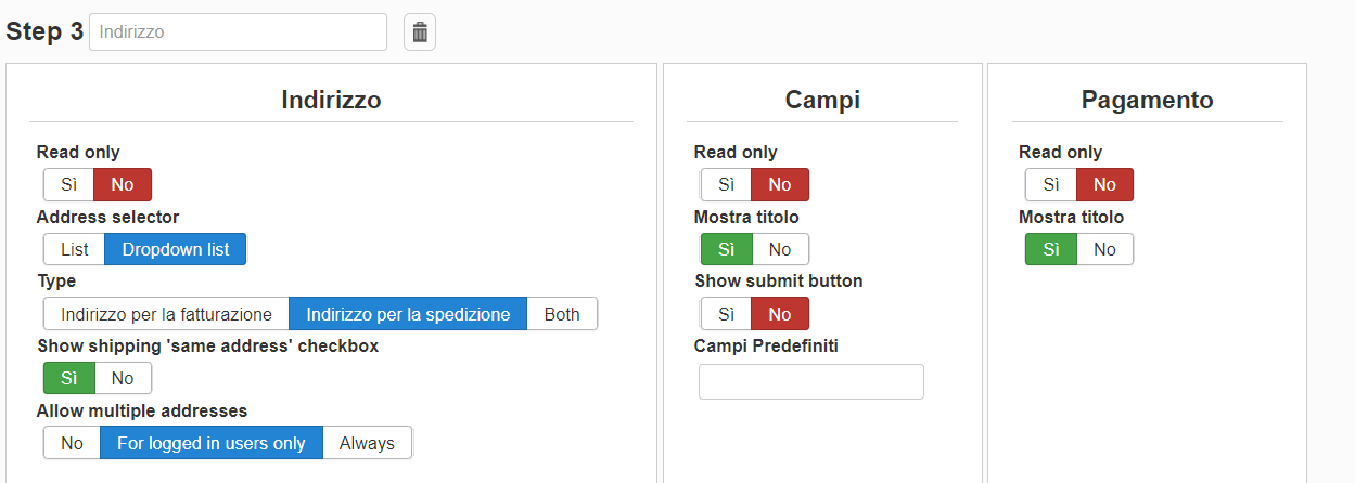

I'm not able to reproduce the problem on my end on a local website with the latest version of HikaShop.
However, maybe it has something to do with the fact that you have the "address" view configured to only ask for the shipping address and/or the fact that you have the "Show 'same address' checkbox" option activated.
That option is so that when someone enters a shipping address, it can be automatically added as a billing address too, and vice-versa. Since you only have shipping addresses, I would recommend turning off that option.
Or you could try with both shipping and billing addresses activated and see if that helps. In that case, you could just hide the billing address area with some CSS instead.
