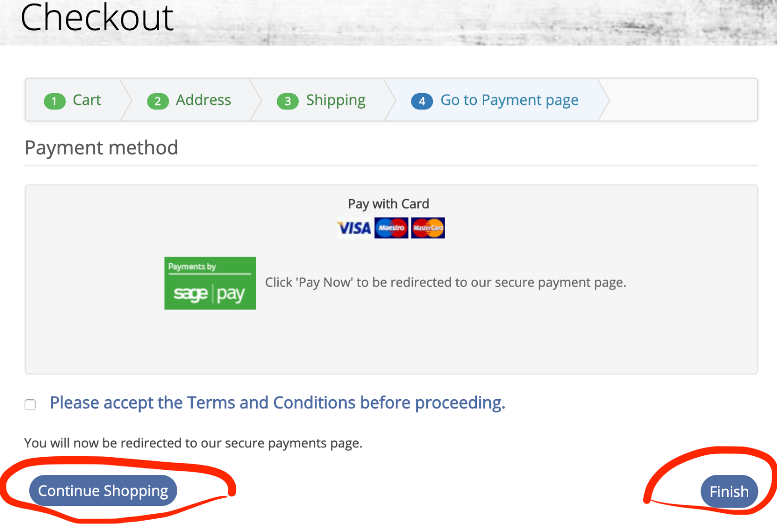

Hi I have two questions relating to the checkout process.
1, How can I change the final button "Finish" in the Checkout process to read "Pay Now"?
2, How do I remove the "Continue Shopping" button from the last page of the checkout process?

6 years 10 months ago #310694
You'll just have to change the value of the "CHECKOUT_BUTTON_FINISH" translation key via "Hikashop->System->Configuation->Languages" as explained on our documentation :

  • Posts: 75
6 years 10 months ago #310718
Thanks for that Mohamed,
How would I remove the Continue Shopping button on last page of Checkout?
Also I can't seem to make more than one Payment Method show up. I have two Payment Methods setup and if I disable one the other will show but not both together. How do I fix that?
6 years 10 months ago #310720
1. You'll just have to unset the value of the "Continue shopping button's URL" option via "Hikashop->System->Configuration->Checkout".

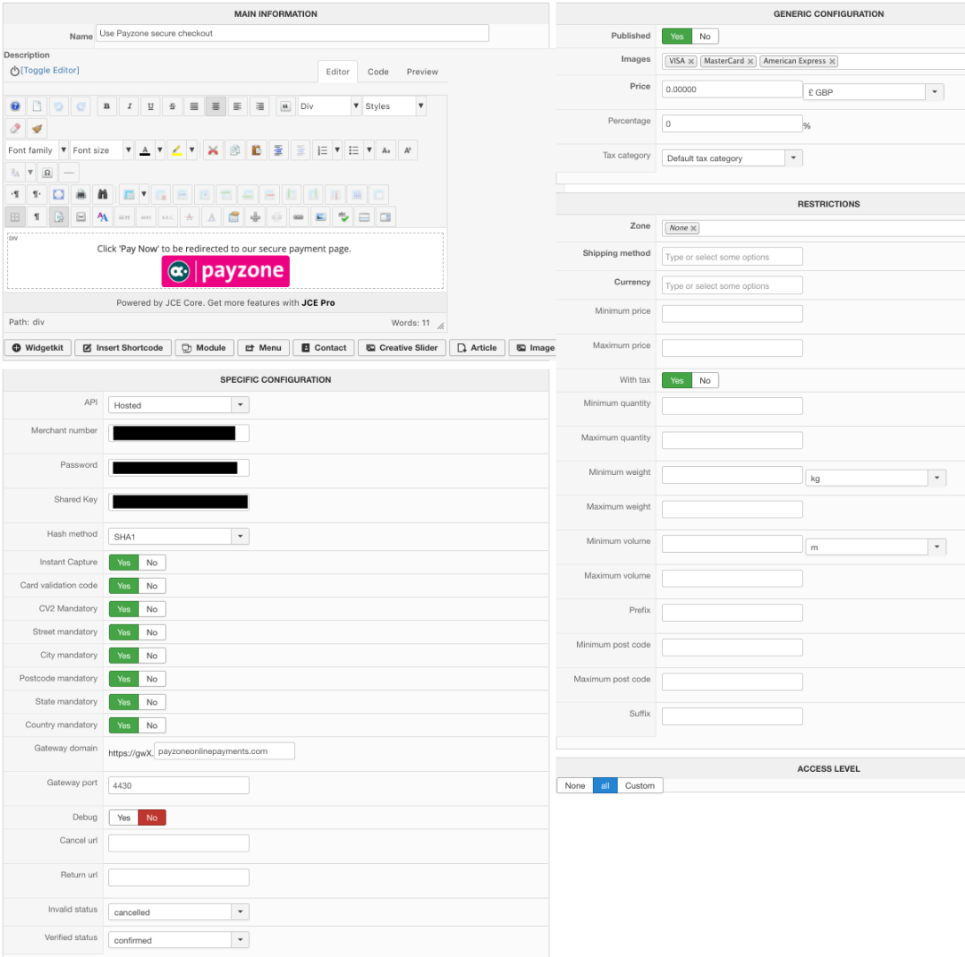

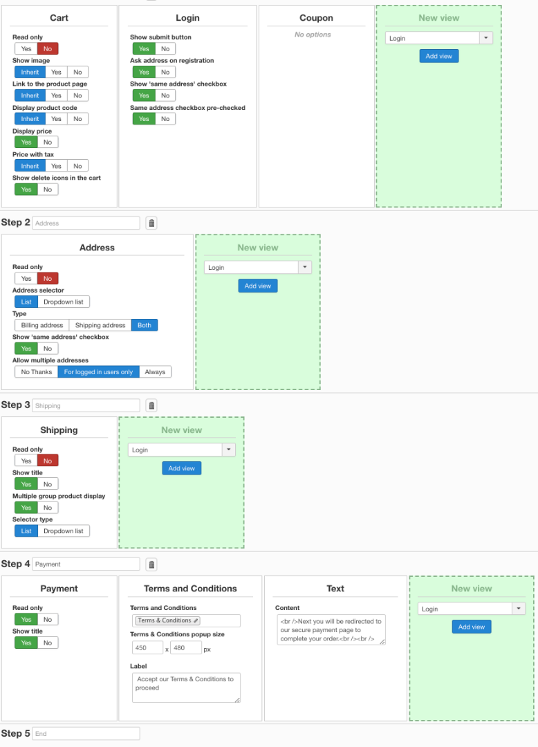

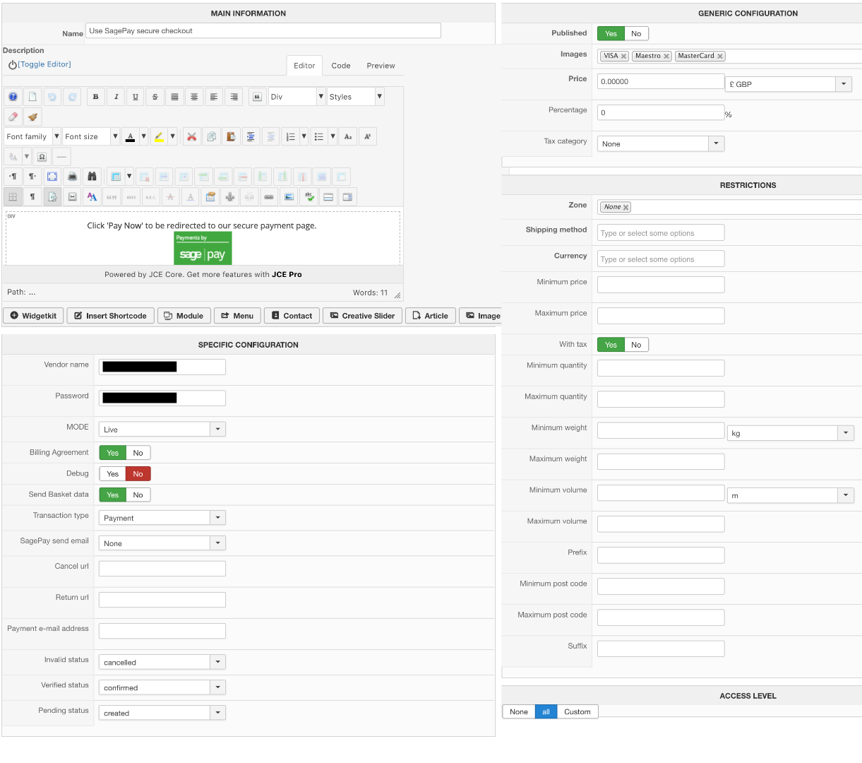

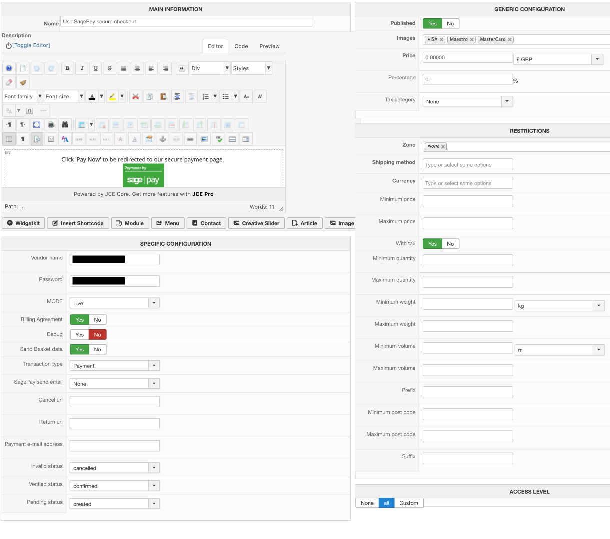

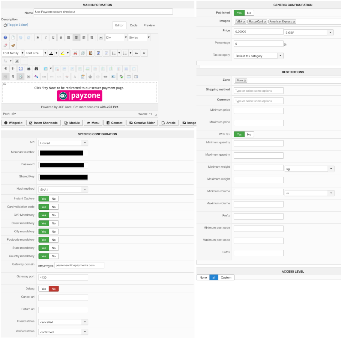

In that case, can you give us more information through some screenshots of your :
- Payment methods via "Hikashop->System->Payment Methods"
- Checkout workflow via "Hikashop->System->Configuration->Checkout"
So that we can directly test it on our end ? Thank you.
Kind regards,
Mohamed Thelji.
  • Posts: 75
6 years 10 months ago #310784
Here you go
  • Posts: 86027
  • Thank you received: 14172
6 years 10 months ago #310792
You have the "read only" setting of your payment view activated. So in that case, the view will only display the currently selected payment method and won't allow you to change it.
That's why you only see one of them and if you disable it, it automatically selects the second one.
