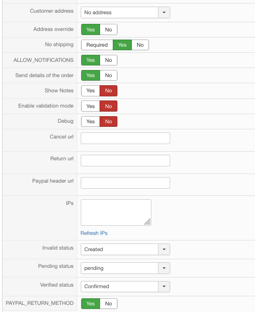

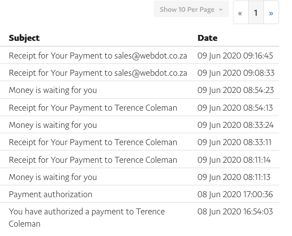

  • Posts: 89
5 years 11 months ago #320476
"So you means that the order status is not changed to "confirmed" automatically after the payment ?" - Yes that's exactly what I mean.
I have now changed the .htaccess to a standard Joomla one and I also changed the Paypal Payment as you suggested. - Please see attached screenshot with settings.
I have read through the Paypal documents and I am not finding anything else I need to change.
I have furthermore disabled Redirect Plugins, Sitemaps plugins and all other things that I think could cause issues and I am still not getting a CONFIRMED states on orders, after Paying with Paypal Sandbox.
When I return to the site I see :
Message
Thank you for your purchase.
You can now access your order here.
I receive the emails a Buyer and Seller would receive, but the Order Stays Pending.
I am also attaching the Notifications from Paypal Sandbox
  • Posts: 85712
  • Thank you received: 14048
5 years 11 months ago #320486
The payment method is properly configured.
Check that the payment is not pending validation in the PayPal sandbox merchant account.
You might need to manually validate it there to send the payment notification to your website.
Also, check the IPN history of the merchant account:
developer.paypal.com/docs/api-basics/not...0the%20IPN%20message .
This logs the payment notifications sent by PayPal to your website after payments are done.
It might contain information on why the payment notifications are not being received.
