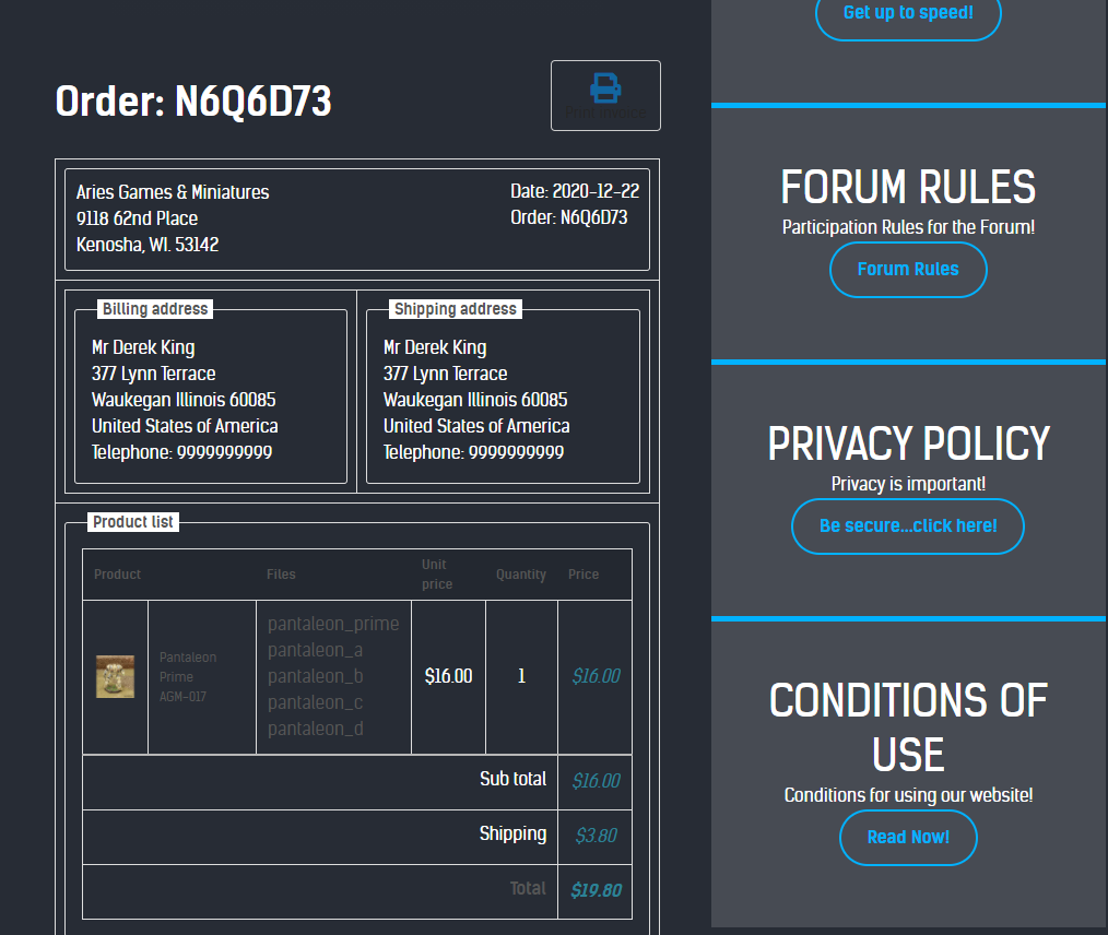

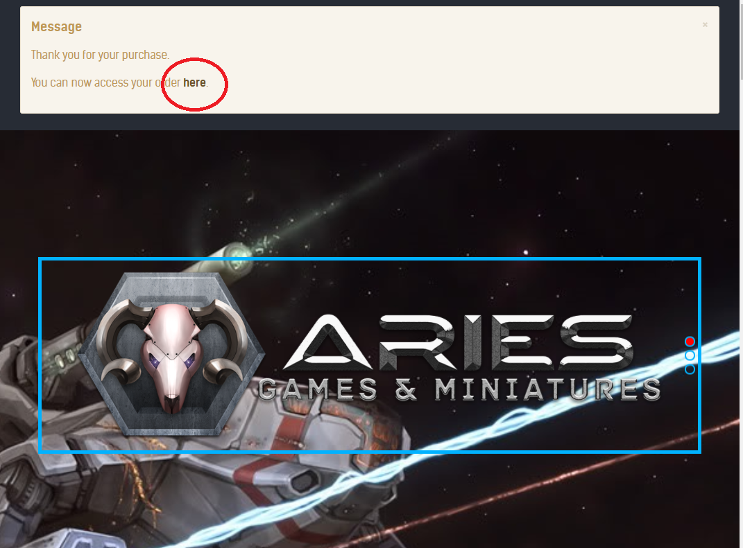

-- Joomla version -- : 3.9.23
So I've been working with Tsuki Dev on the square setup...and all seems to be working with the plugin...except when the sale is completed, the popup at the top of the page provides a link to view the order. When clicking on that link, the order is displayed on the HOME page of the template, NOT the correct page (called Blank on my site) as it should.
Tsuki Dev took a look but could not resolve & suggested I contact support here to resolve. I'd like to try and get this taken care of ASAP as I need to launch Square on the site right away.
I have provided login info for the test site to Nicolas on another issue I'm having with the points system not applying to a user account, and you can use the same login info if needed...but please take a look & let me know how to resolve. That login info is for the test site which is locked behind a security layer so the public cannot access it.
I've also attached images here showing the issue as well.
Thank you!

5 years 7 months ago #327863
Thanks a lot for your feedback !
Your issue was coming from the ItemID which wasn't correctly attached to the URL during the onPaymentNotification process of the Square plugin, that issue was just fixed by the Tsuki Dev team and we have added that version through your website.
If you need te re-install Square / Hikashop through you production website, you'll have to re-download Square through our website to be sure that you have the last version.
