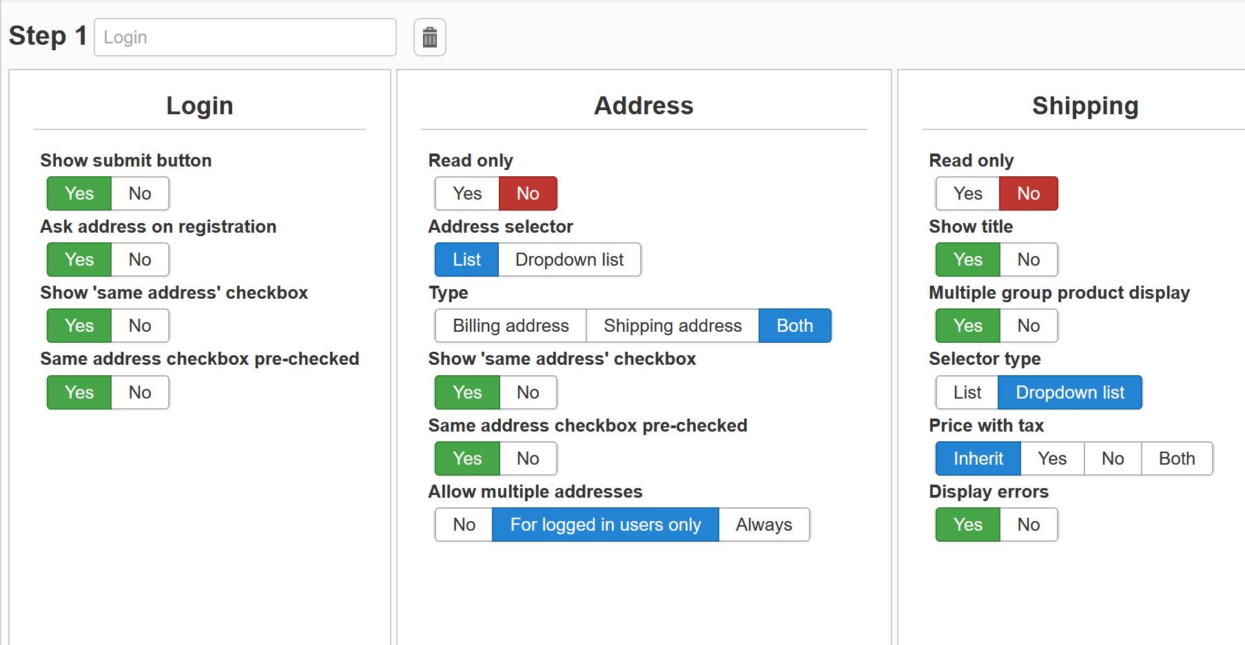

5 years 2 months ago #332674
Thanks for your suggestions.
I have the standard workflow for checkout and have have set it so that you have to login in and have an account to buy something. It has a Login as a first step. When you click checkout it does go to login in, but jumps down to payment method, and just above that the error message says no shipping address. This is because the user has no account.
So I think it is going to the login but then jumping down. I have attached a screen shot of the beginning of the checkout workflow. The login has the registration option to enable a new customer to create an account.
I am sure I have messed it up somewhere, sorry to be a pain :^)
Thanks again.
Zoe
  • Posts: 86027
  • Thank you received: 14171
5 years 2 months ago #332676
As I said, you need to have login and address on the first step, and shipping on a second step.
On your screenshot, I can see that you have all the views on the same step, not on several steps.
Please review the tutorial I gave the link to in my previous message and you'll understand what I mean and what to do.
