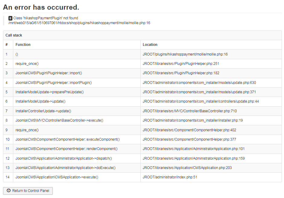

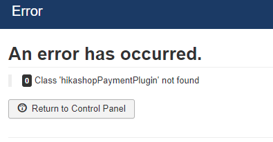

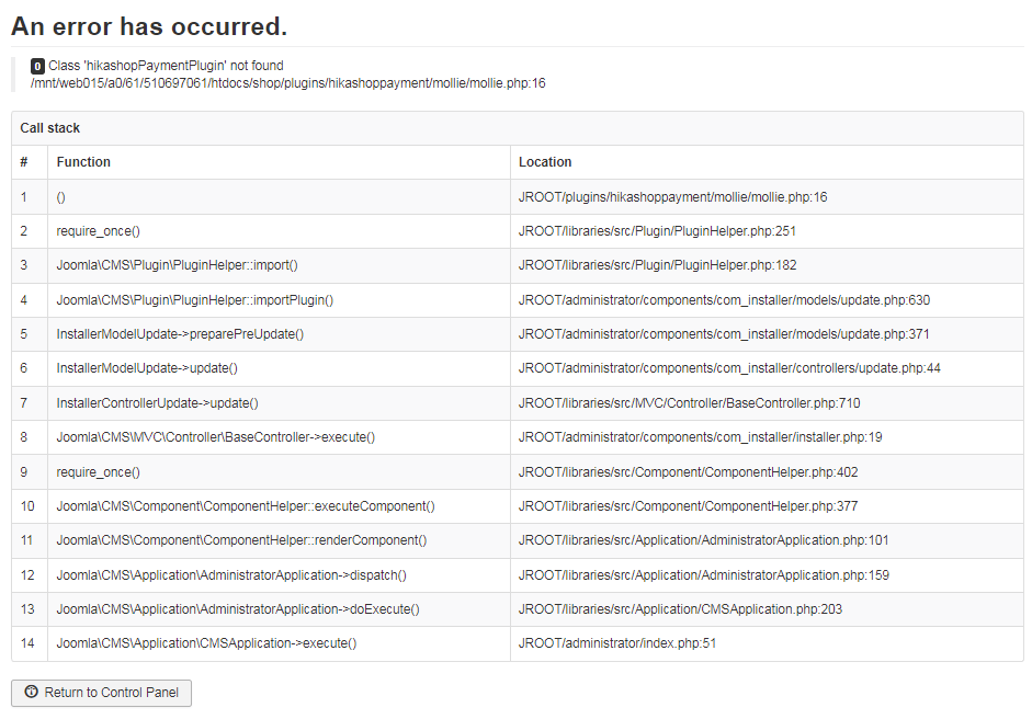

  • Posts: 59
4 years 11 months ago #333570
  • Posts: 85712
  • Thank you received: 14048
4 years 11 months ago #333574
It seems you have an old version of the mollie plugin and it's trying to updating itself and fails as it doesn't load HikaShop's helper.
I would recommend downloading the latest version of the plugin and manually installing it on your website to get the update.
If you still have the issue after that, you'll have to contact the developer of the plugin.
If you're using the mollie plugin from our marketplace www.hikashop.com/marketplace/product/153...ie-by-skyspider.html you can contact the developer here skyspider.com.au/#contact
