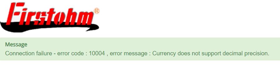

We use paypal plugin, it used to work well, but recently we got this error message:
Connection failure - error code : 10004 , error message : Currency does not support decimal precision.
Could you tell me what is going wrong,

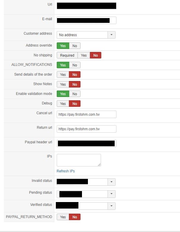

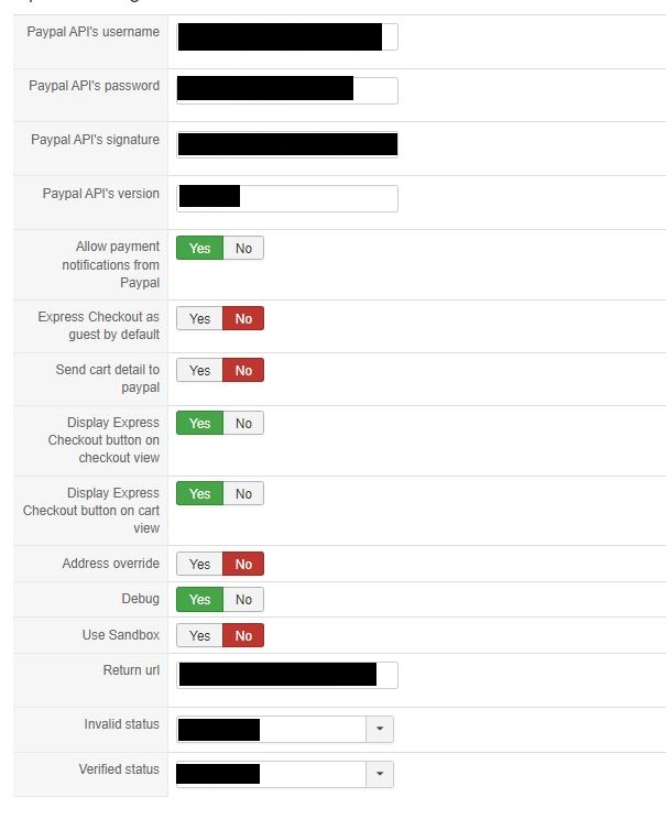

I just installed the new plugin, but I found a big problem that is the setting is different from my original one.
The plugin we were using is PaypalExpress
and the setting page is in attached_1
and the new plugin setting page is in attached_2
Could you send me this one
Thanks again

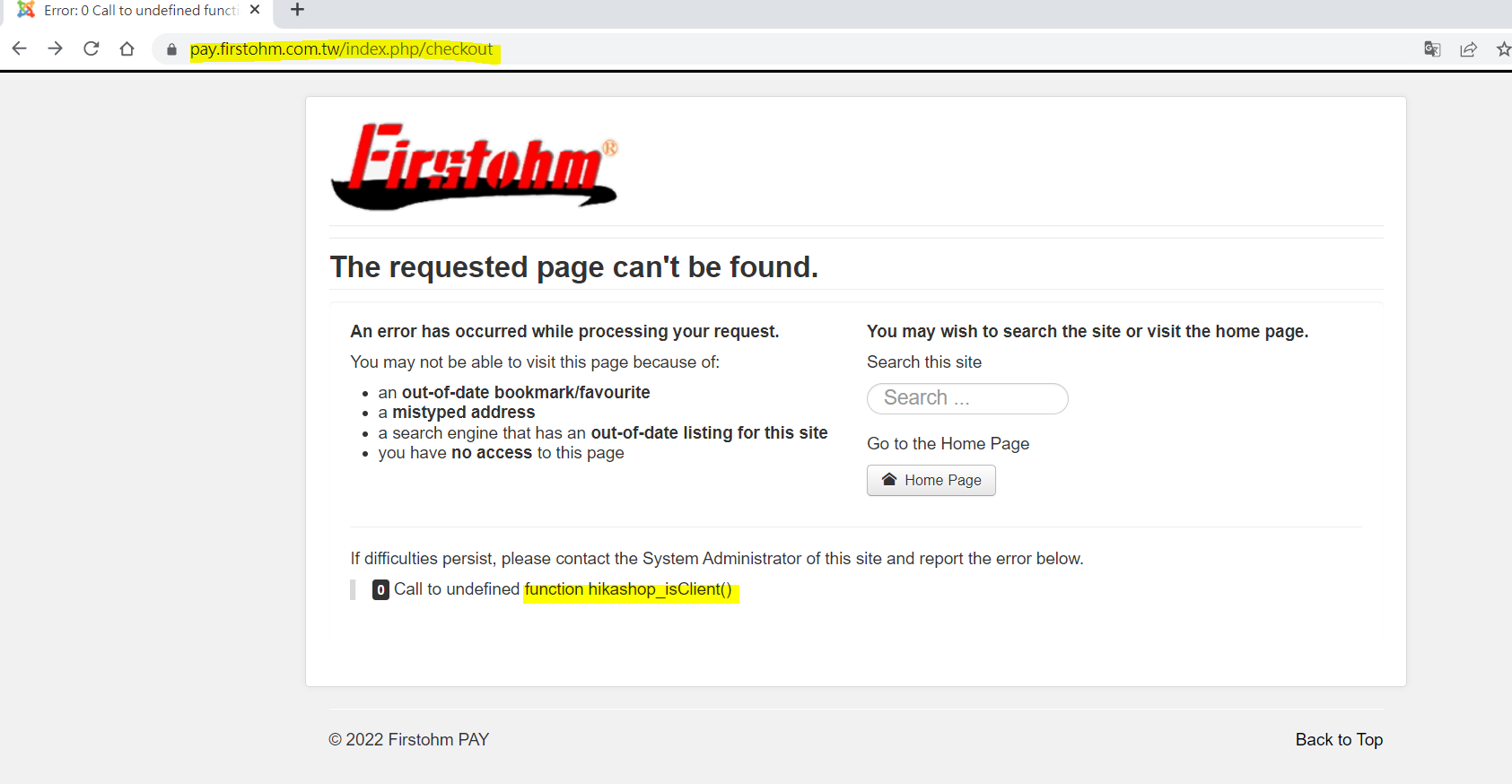

Thansk for you prompt replay, but I still have trouble setting my paypal.
Attached is the screenshot from after installing the new paypalExpress plug in.
That was when I click on add to cart.
Could you help to solve the trouble, thanks.
Last edit: 3 years 11 months ago by twscott.
  • Posts: 85712
  • Thank you received: 14048
3 years 11 months ago #342685
That's because you have an old version of HikaShop.
Update your HikaShop and you won't have that error.
I checked your website and it seems pretty standard so updating shouldn't be a problem.

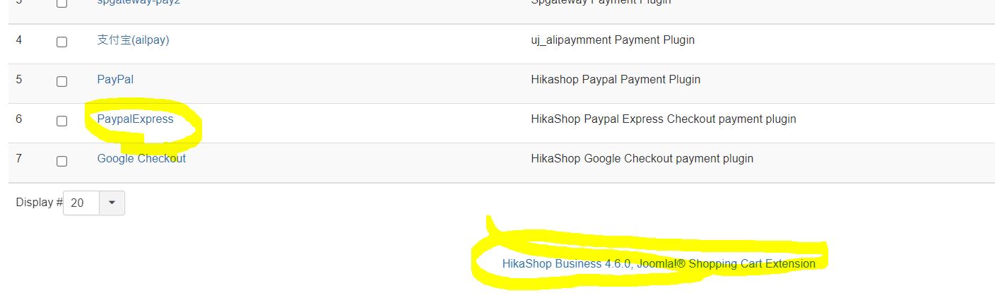

3 years 11 months ago #342855
I checked and you have the default PayPal Express plugin of HikaShop 4.6.0.
Note that when you updated your HikaShop to the 4.6.0, it overwrote the PayPal Express plugin with the one pre installed in the 4.6.0.
So if you want to test the version of the plugin I provided in this thread, you need to install the plugin again.
That's why it still produced the same error with the currency and the prices not rounded properly in the debug data.
