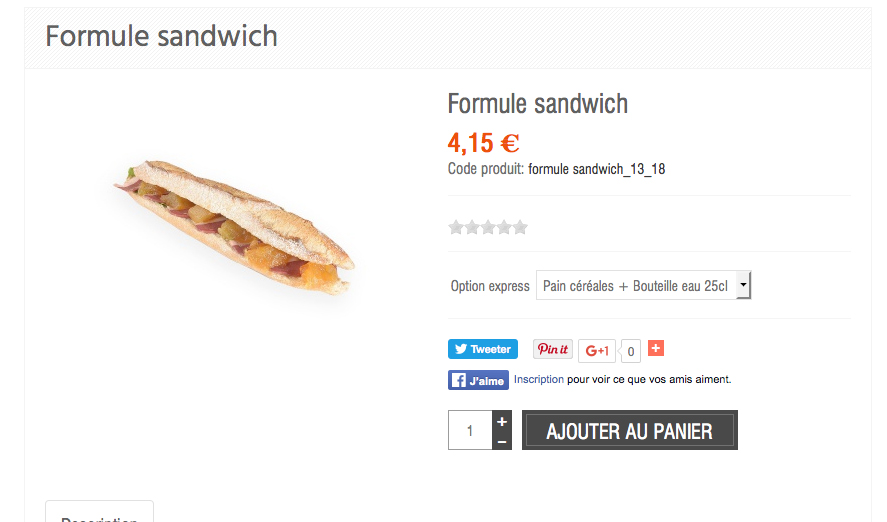

10 years 3 months ago #236213
step 2, I got my 2 characteristics and seem to be ok in the back office, BUT the 2nd option is not showing on the site. What am I doing wrong?
nb : the option Pain céréales + bouteille 25cl is one option, there is supposed to be another one below it for the second option of the product.
Last edit: 10 years 3 months ago by UserB.

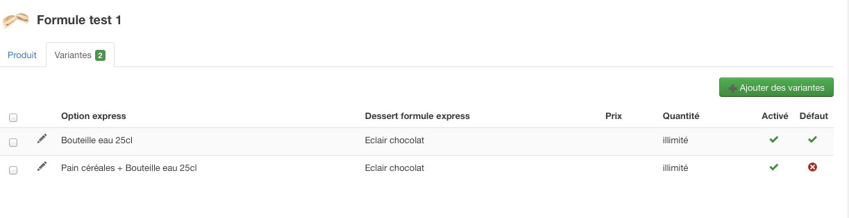

10 years 3 months ago #236216
Can you provide a screenshot of the variants tab of your product in the backend ?
  • Posts: 177
  • Thank you received: 8

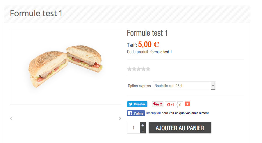

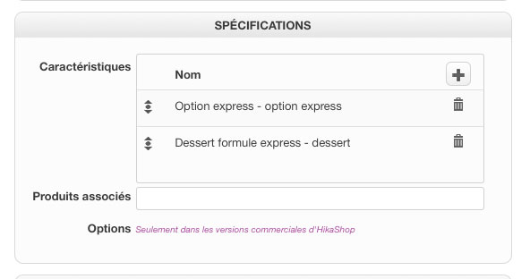

10 years 3 months ago #236354
so here is what we have on the front page :
and on the product page in the back office :

10 years 3 months ago #236644
I feel a misunderstanding, as a start I invite you to have look on this tutorial, here .
For complete my answer, don't confused Characteristics AND Variants.
Let's explain this with an example from the tutorial I give you :
- 1 Characterisitics for Color
- 1 for Size
Later, in my backend product I pick the two characterisitics AND I define a default value (white for the first and M for second)
Save your product, on the backend product will be displayed Variants tab.
I define for this product 2 color white and red AND I use the second characteristics (Size) to define which size are available for each color.
This point explained, do you want to have 2 characteristics OR 2 Variants ?
Second question, do you want display all available choice, for this go to Components => HikaShop => Configuration, and on Products dropdown select Characteristics, and click on your characteristics name, look for Characteristics selection method option and define it on "Radio Button".
Awaiting news from you.
