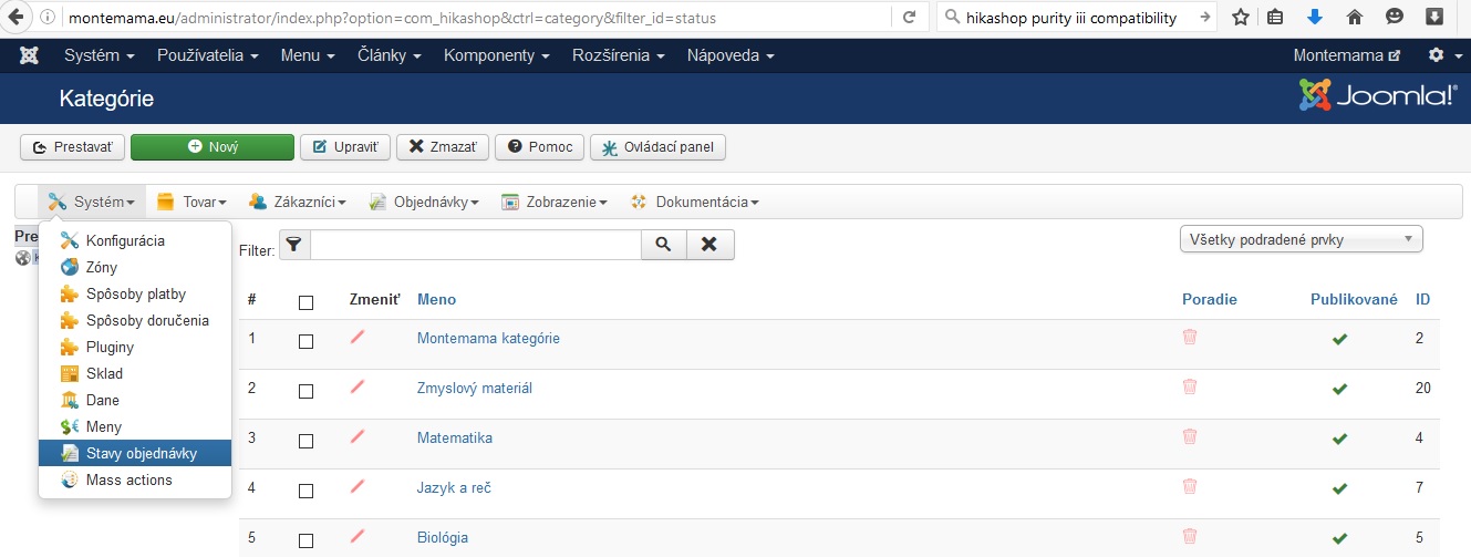

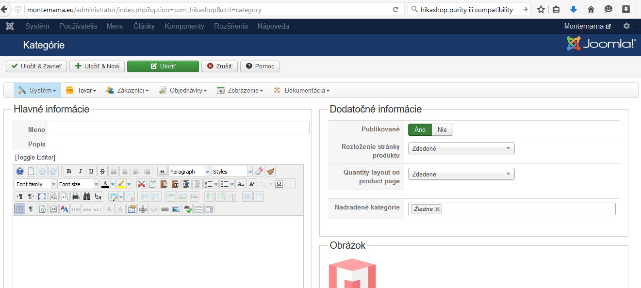

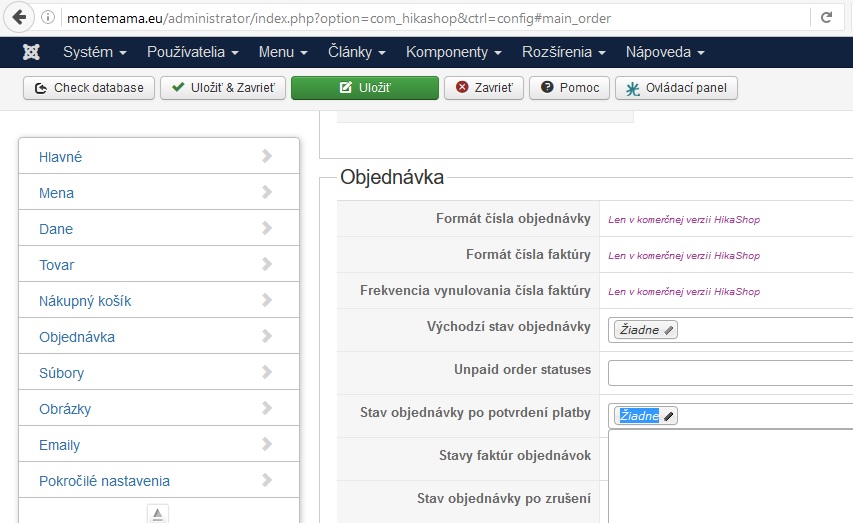

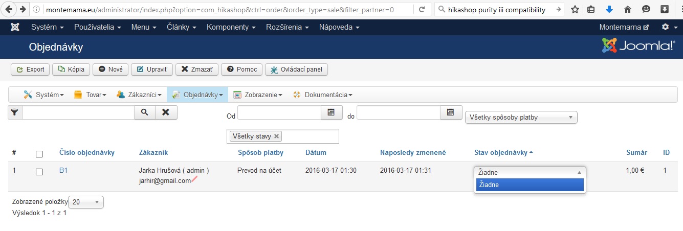

I am unable to change order status in order. When I want to create order status, I see only categories (please, see printscreens attached).
I had similar problem with creating categories, when the web used to run on free hosting www.hikashop.com/support/forum/content-c...category.html#233474
But now it is moved to paid hosting. Could you please, check what is it reason? Am I doing something wrong? Should I reinstall the Hikashop? Is there some error in database?
Thanks a lot in advance for your help!

I have tried to uninstall Hikashop and install it again, but it didn´t help. Still, there are no order statuses in configuration.
I have all my products, categories and settings back, so maybe it is necessary also to delete some fields in database? I do not have enough experience to test this. I am looking forward to your help ;)
