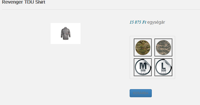

I have many clothes, what have two characteristics, one is the size (M, S L etc.) and the other is the pattern (ACU, Marpat etc.)
I would like to make 2 different list with images for the size and the pattern. So, the customer can choose ACU L, Marpat S etc. I made this list, and te pattern list was the main list. For the pattern list connect the size list. My problem is that for example I have Marpat S, M, L, XL and I have ACU S, M and I choose marpat, I see all the size and not only what is defined.

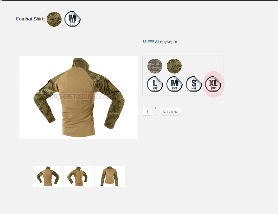

Yes, once I made it. But there is a problem.
On the attached screen the first pattern have XL size, the second pattern do not have, but I see on the second pattern the XL size. I would like to hide the size of variants what are not available.
  • Posts: 86027
  • Thank you received: 14169
9 years 11 months ago #249054
If HikaShop was to remove the XL size, you wouldn't be able to select it for the first pattern either.
Or it would require a dynamic display but it can get tricky when you display all the characteristics, and you have several of them, etc.
As I already explained, I have three options for you:
- You set the "characteristics selection method" setting of the HikaShop configuration to "table", and the characteristics will display as a 2d table which will only allow the customer to select available variants.
- You set that option to "list", and you'll see instead a list of the available variants.
- You edit the file "show_block_characteristic" via the menu Display>Views and add custom javascript code in there to refresh the characteristics display dynamically, but beware it's not easy.

Thanks. I think now is enough the "table" display setting.
