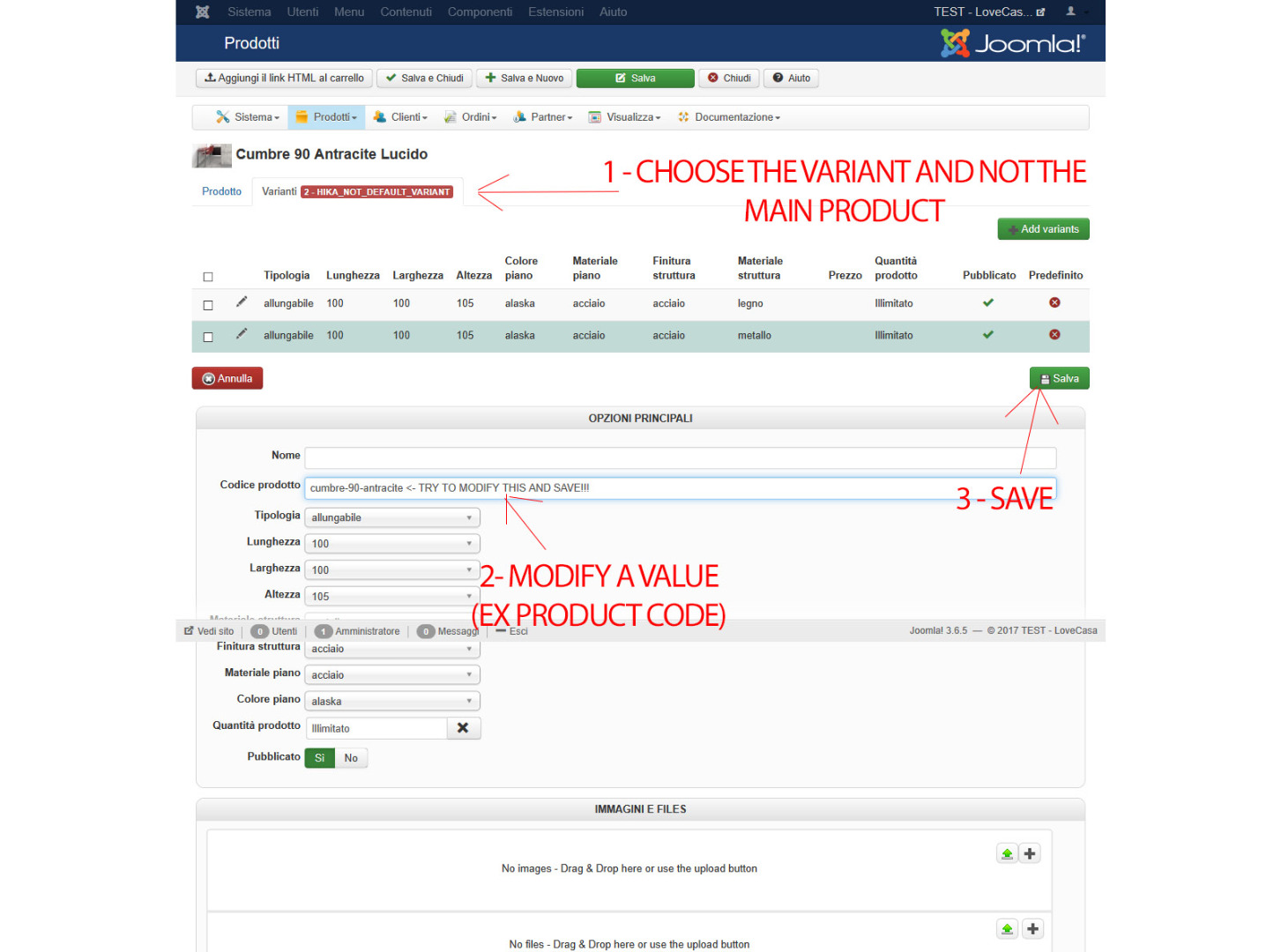

  • Posts: 117
9 years 6 months ago #261376
1 - Create a product of test from backend (if you create it inside "Tavoli" categorie, you can use the caratheristic)
2 - Generete 2 or more variant of this product (using 2 or more charateristic associated)
3 - Try to modify the price or the product code of a variant
4 - Save
Now the system try to save, but the price or the product code you try to modify, remain the same of before
