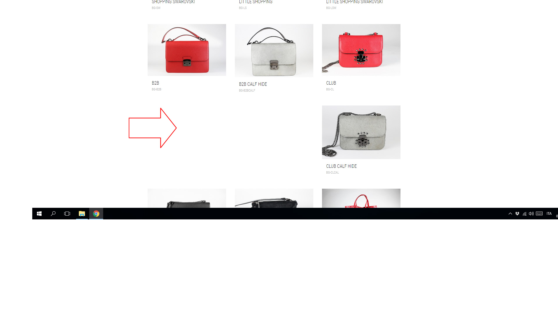

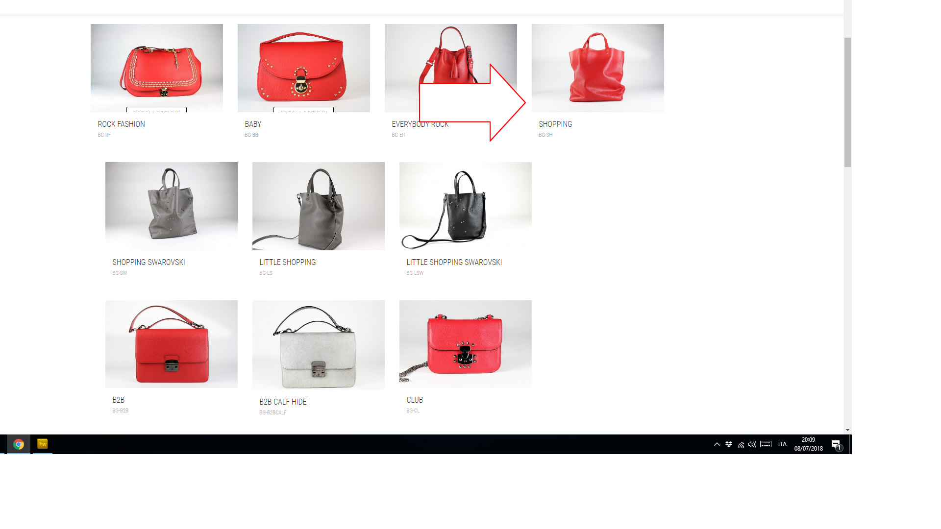

after having upgraded to the latest version,
the list of products which was a regular grid has become unbalanced as in the images attached.
as you can see there are voids and some items are alone on the right
help please

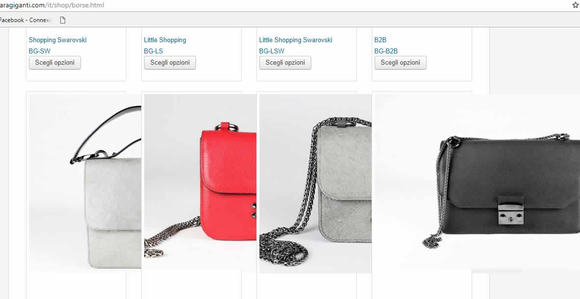

I've tested with one of the default template and this is the result.
Can I ask you to connect to the site and check personally?
Please let me know and I will provide you login details to backend
