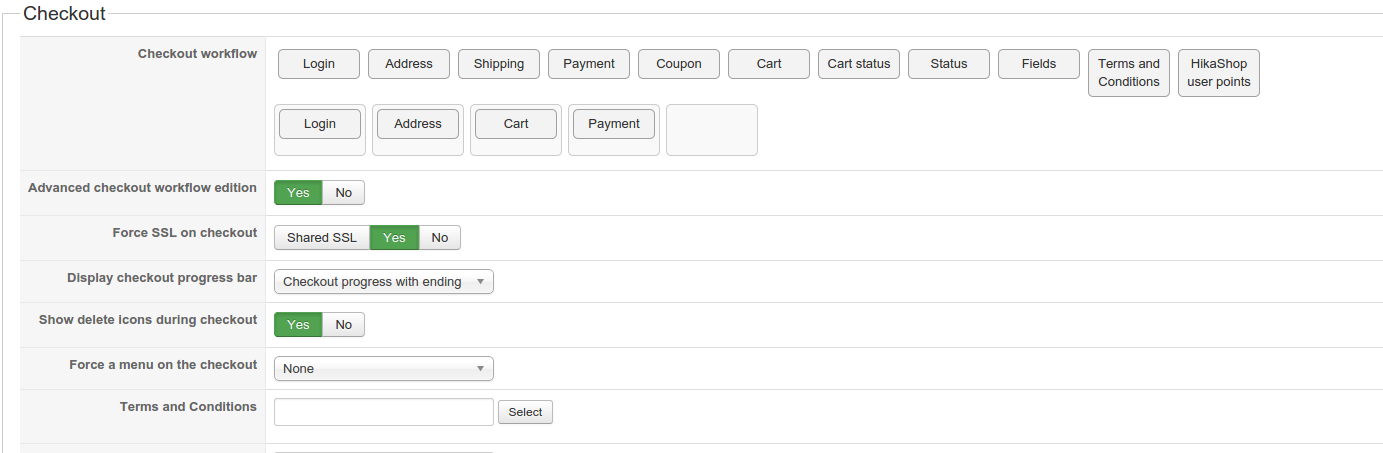

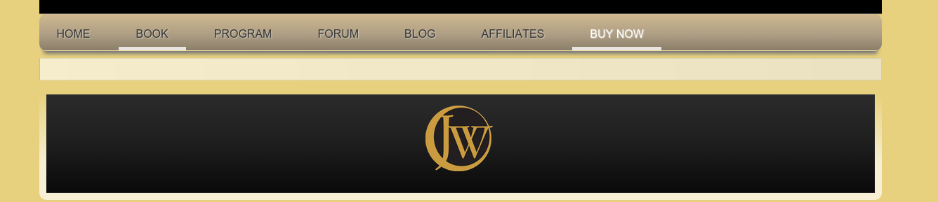

Step one on my flow screen is login. I require them to register, and require the address on registration. This works fine and I get the email with a link back to the site to confirm registration. However, after submitting the registration on the site, It will take me to a "blank" screen. My number one priority was "did I get the email", and the answer is yes. However, I do not want to have to count on the possible user having the inclination to check their email. I would think there should be some message here telling them that the email has been sent and they need to check for it. I have attached a screen shot of what I get after the register button is pressed.
Following a previous thread, I disabled the "AcyMailing : HikaShop integration" plugin. No change. I then turned on my debug and set it to maximum.
Also, this is more of a logic thing and I know I cannot be the first person to think of it, so there must be an answer I have not seen. I can have a successful registration, before the purchase has been completed. I do not think that any registration should be complete and account enabled on the site until after I know the purchase is complete. Is this more of a flow screen process change that I have possibly done incorrectly?
Thank you for any help you can give.

You didn't look at the right thread.
That is issue is quite common actually. You don't see the message after the registration because your template is not displaying messages. Please follow these instructions: www.hikashop.com/support/support/documen...tibility-issues.html

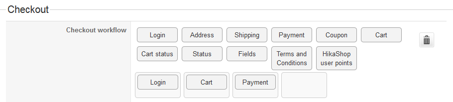

After looking through the Joomla setup, I think you are referring to setting up a manual registration enable. I am hoping that is not an option for this domain owner, as I really do not want to tell him that is his only option. Here are a couple of issues that I have seen in the registration:
I am hoping that I can solve this with a change to the flow screen, but I don't know if that is possible. Current setup:
After the user does a login, which is also a register, they get the email. After clicking on the email link, they return to the check out process. They are also logged in to the site. At that point, they are an enabled user and part of the group that the purchase will assign them to. If they want, they can click out of the checkout and have full access to whatever they would have based on the purchase. Here is a shot from a "botched" purchase where I clicked out of the checkout after registering. As you can see the "fake" user is active:

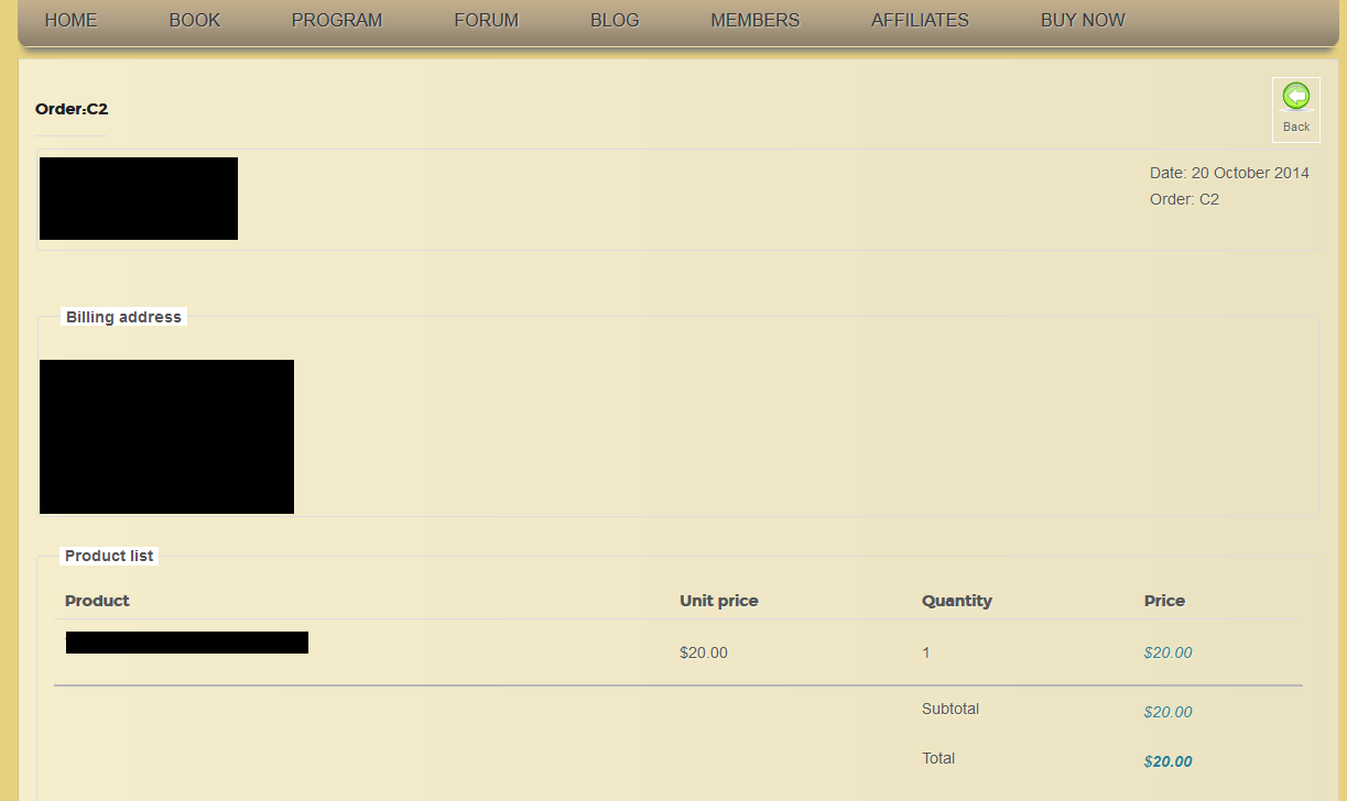

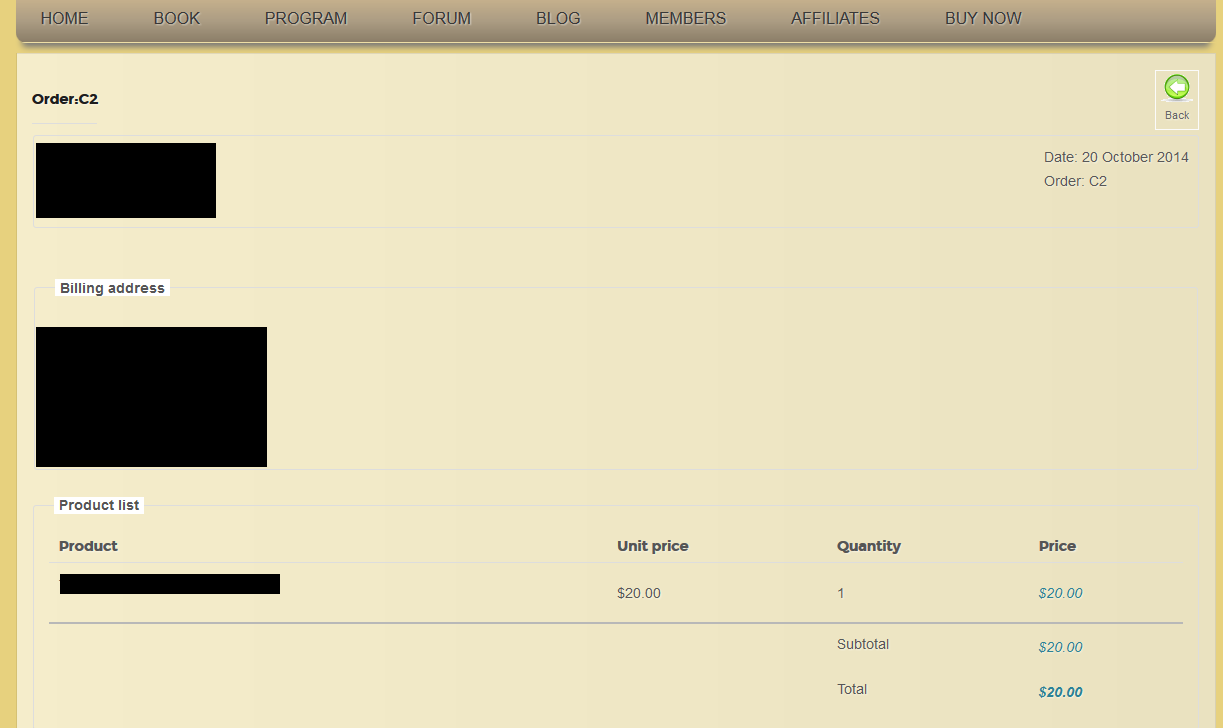

I removed this user and decided to move forward with the process. I got to the last step of the purchase where I would normally enter the credit card number. I then exited the purchase. My fake user received a order invoice via email. Then I checked the order process on both the front and back sides of Joomla!.
User can access their order information on the site. It looks like they have a successful purchase.
The soon to be administrator can see the order on the Hikashop dashboard. Is the Order status the tool they need to use to see that this checkout process did not complete? Or will they be filling an order that was never completed, and sending away their product?

1. No, you misunderstood me. I'm talking about the self user activation which can be deactivated so that users registering get automatically activated without having to click on an activation link. Again, that's an option of the Joomla user manager, not HikaShop.
2. At the end of the checkout process, HikaShop will direct the customer to the payment gateway so that the payment with the credit card can be done securely on the payment gateway page. And after that, the payment gateway will notify HikaShop that a payment has been done for the order XXX. So at the end of the checkout, HikaShop has to precreate the order with all the information of the user/order in order to send the XXX order number to the payment gateway so that he can then validate the order when it receives the payment notification.
That's how most of the ecommerce solutions/payment gateways work.
So it's normal that you see a created order even though you didn't pay the order yet.
When the order is paid, HikaShop will receive the payment notification and the order status of the order will be changed to "confirmed" and you'll be notified that a confirmed order is available and the customer will also be notified that his order has been confirmed with you.
