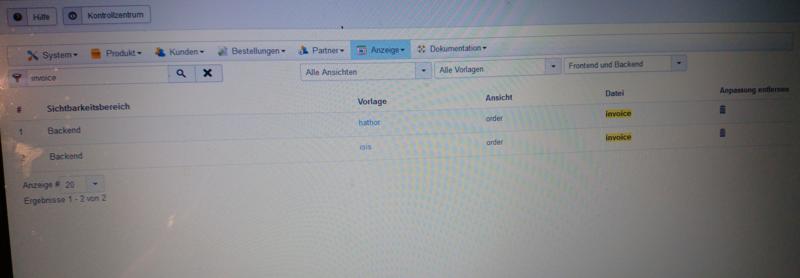

  • Posts: 86179
  • Thank you received: 14217
8 years 7 months ago #287525
You can edit the file "invoice" of the view "order" via the menu Display>Views and use such code:
<?php $this->element->customer->XXX; ?>
where XXX is the column name of your custom user field.

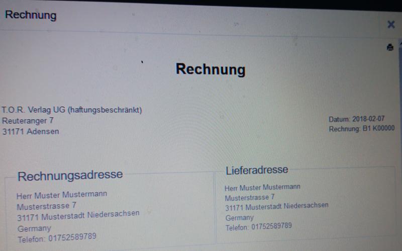

  • Posts: 30
8 years 7 months ago #287612
Is this ok ?
<fieldset class="hikashop_order_custom_fields_fieldset">
<legend><?php echo JText::_('ADDITIONAL_INFORMATION'); ?></legend>
<table class="hikashop_order_custom_fields_table adminlist" cellpadding="1" width="100%">
<?php foreach($fields as $fieldName => $oneExtraField) {
<tr class="hikashop_order_custom_field_<?php echo $fieldName;?>_line">
<td class="key">
<?php echo $this->fieldsClass->getFieldName($oneExtraField);?>
<?php $this->element->customer->kundennummer; ?>
</td>
<td>
<?php echo $this->fieldsClass->show($oneExtraField,@$this->order->$fieldName); ?>
</td>
I can not I can not see the Customer Number field on the invoice
Last edit: 8 years 7 months ago by Oktavian.
8 years 7 months ago #287619
Using that kind of code will be better to display it :
<?php echo $this->element->customer->kundennummer; ?>
Instead of :
  • Posts: 30
8 years 7 months ago #287697
I'm too stupid, I entered the code in two places.
In this two files I find. have in line 49 <?php echo $this->element->customer->kundennummer; ?>
I still can not see the element kundennummer in the Invoice.

  • Posts: 30
8 years 7 months ago #287743
That works fine.
how do i get the term customer number (Kundennummer) under invoice number (Rechnungsnummer)
The customer number is now next to the invoice number.
Where can I determine the look of the invoice number?
The invoice number is now But would have to be continuous because the last invoice number in the old shop was B00000893
Thanks Oktavian
  • Posts: 86179
8 years 7 months ago #287748
Just add a <br/> tag before your code so that it goes to the next line.
You can change the invoice number format with the setting of the same name in the HikaShop configuration:
www.hikashop.com/support/documentation/5...nfig.html#main_order
  • Posts: 30
8 years 7 months ago #287821
Thanks it works :-)
