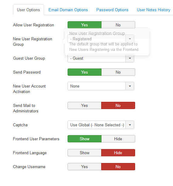

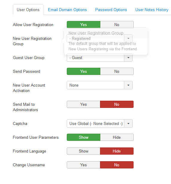

Can you check the settings of the joomla user manager ? there is a "captcha" setting there. Make sure that you select "none" there and that you save these settings once. Then try again and see if that helps.
  • Posts: 143
  • Thank you received: 9
7 years 3 months ago #307543
I did it but issue persist.
