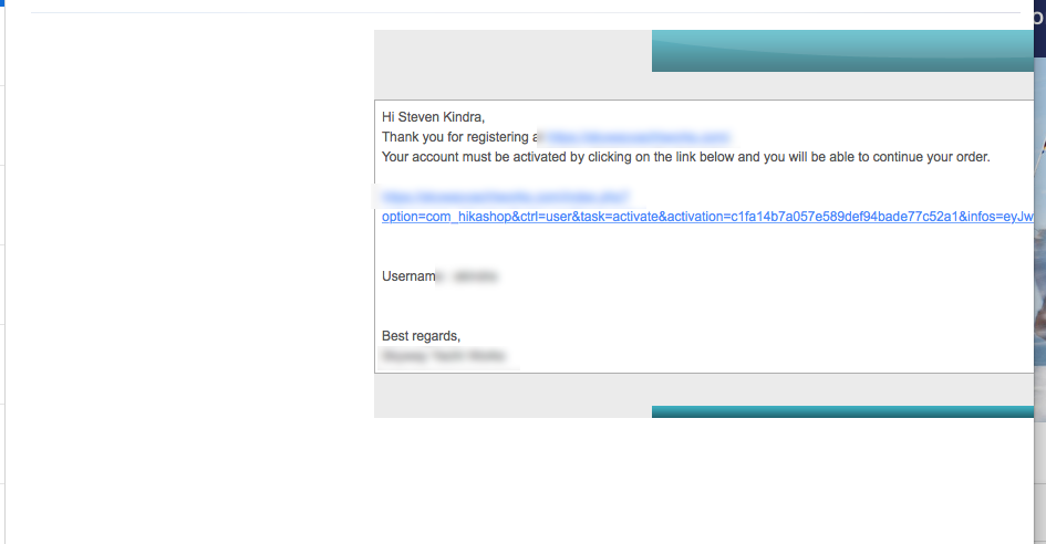

When a new customer 'registers' they are sent an activation email. However, they come in aligned to the far right and much of it is clipped off from view as shown int he attached.
How do I remedy this?

  • Posts: 109
6 years 4 months ago #317990
Using Mac Mail. In all my years we've never seen this occur before.

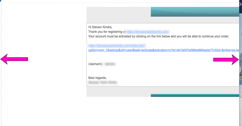

  • Posts: 109
6 years 4 months ago #318018
Two things:
1) I don't see a way to edit the email at System>Emails — we only see the list of possible emails, none refer to the activation email, and it doesn't appear we can edit them here—only turn them on or off.
2) However, my original issue was that the activation 'message' is positioned very far to the right in the email viewport, and no matter how far we expand the viewport to the right, the entire message cannot be read.
This seems to be isolated to the activation email. — See attached.

  • Posts: 86179
  • Thank you received: 14217
6 years 4 months ago #318020
1. Edition of the emails is only available with the Business edition.
Without it, you can do the modification in the file media/com_hikashop/mail/user_account.html.php but note that you'll loose the change when you update your HikaShop in the future.
2. I understand that, and I think it's because of the link. I don't see an alternative besides not displaying the link and instead having some text for the link (it will still be clickable but the user won't directly see the URL of the link).
3. There is an email "payment notification" which notifies the merchant when such event occurs so that he can deal with it manually and check what happens. Then, the merchant can change the status of the order and check the checkbox to notify the customer. In that case, it will use the normal "order status notification" email.
Note that in most cases, the payment is refused directly to the customer on the payment gateway page and thus no payment declined notification happens. This would only happen if the payment is first pending by the payment gateway so that it checks with the bank of the customer and then later approves or decline the payment. That's quite rare and it also depends on the payment gateway's way of functioning.

6 years 4 months ago #318126
2) My point is that we only have an alignment problem with the activation email—none of the other Hikashop emails.
3) What I'm saying is that the word 'cancelled' in this case is wrong—that is should say 'declined' when a transaction is declined. Also, the error message that appears on the website when an order is 'declined' is very vague. This might be an area for Hikashop to improve in future releases?
  • Posts: 86179
6 years 4 months ago #318150
2. Well yes. That's the only email with a URL printed in full in the email. That's why I told you to change the link to not print the URL in the link and only have it in the src attribute. That way, it should display fine too.
