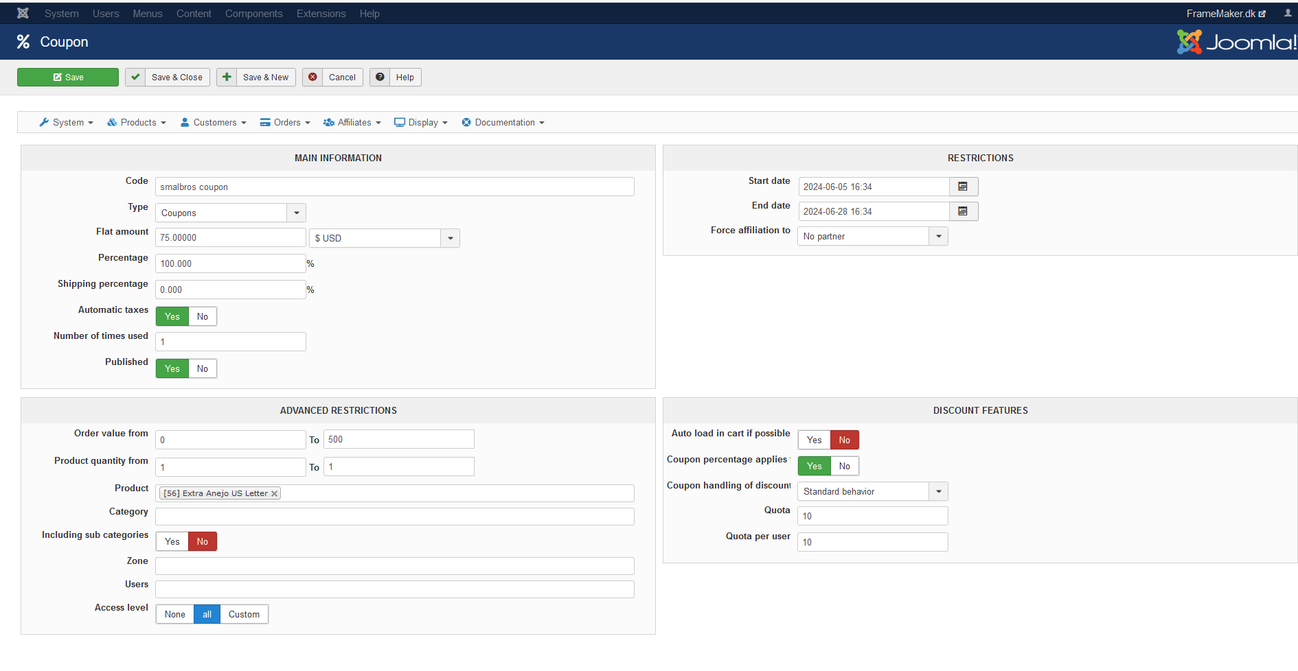

If you want to provide a one time coupon code to get a free product, you want to create a new coupon with its "quota" set to 1, it's percentage set to 100%, its "coupon percentage applies to product only" setting turned on, its "product quantity to" set to 1, and its "product" setting set to the product you want to offer with this coupon code.
Rinse and repeat for other products if you want to provide several coupon codes.
If you want to generate a big number of these, create a few ones via the interface, and then go in your PHPMyAdmin and export the hikashop_discount table as a CSV file. Then, open it with Excel or LibreOffice Calc and generate extra rows basing yourself on the rows for the coupon codes you already generated. Then, use PHPMyAdmin's import function to import back the new rows and you'll get your new coupon codes loaded into HikaShop.

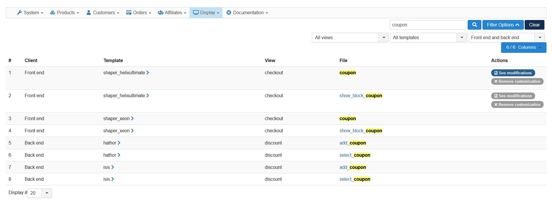

2 years 2 months ago #361579

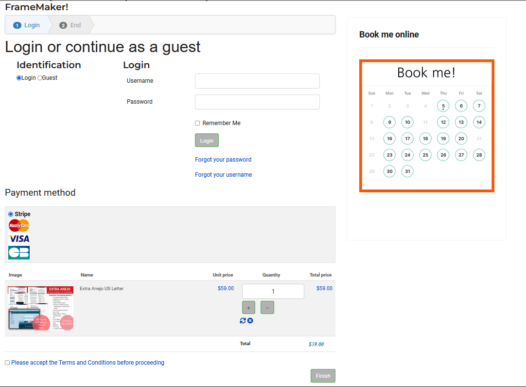

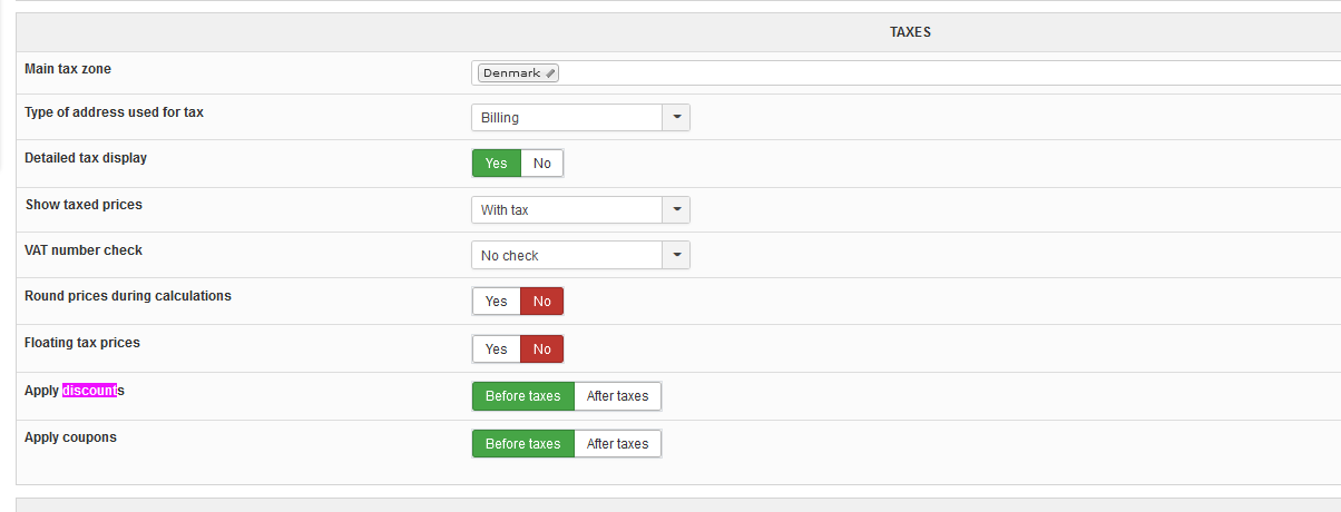

Thank you for your answer. I am still having problems, though. I am not able to make the coupon show in the checkout.

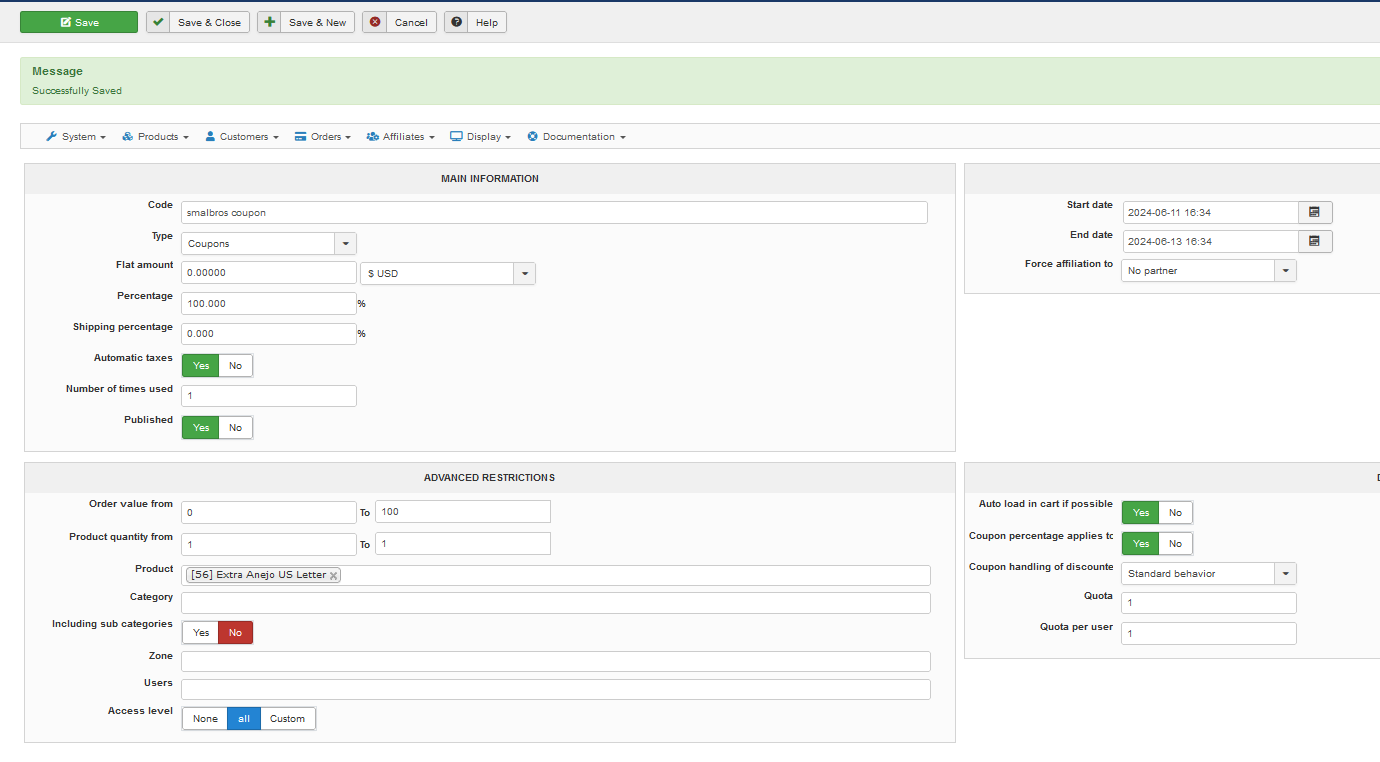

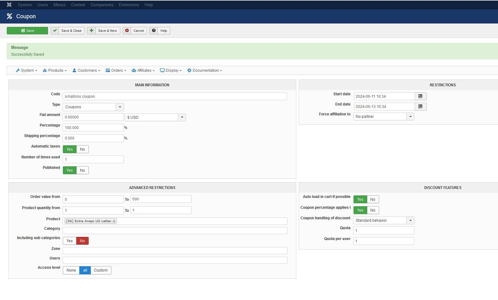

1: I have created a coupon and assigned it to a product (coupon setup.png)
2: In the configuration I have enabled coupons (apply discount.png)
3: In the "Display", coupons are enabled (display coupon.png)

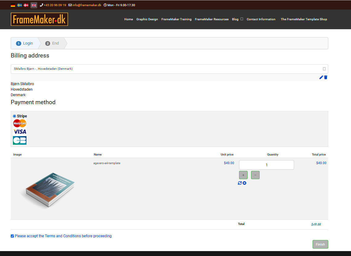

4: But no coupons in the checkout (checkout.png)
Something is not working and I am not clever enough to figure out why not. Can you possibly help me please?

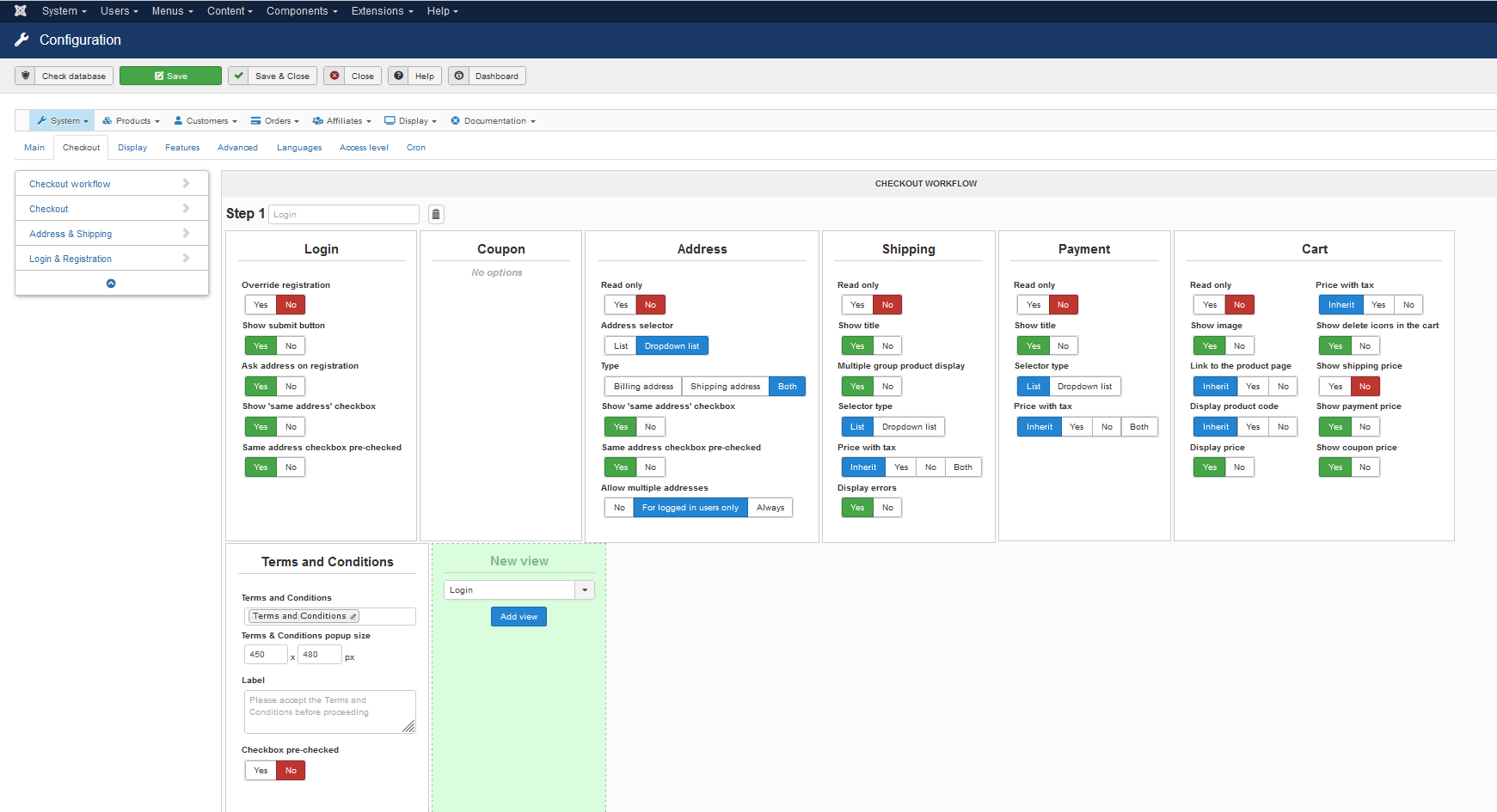

  • Posts: 86080
  • Thank you received: 14188
2 years 2 months ago #361581
As I said, you need to add back the coupon view in your checkout workflow, in the HikaShop configuration:
www.hikashop.com/support/documentation/4...eckout-workflow.html

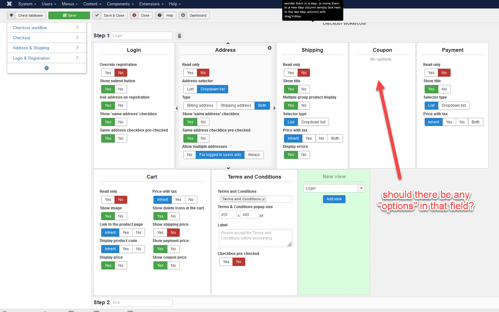

  • Posts: 25
2 years 2 months ago #361600
Thank you for your always quick answers!
I have inserted the Coupon field in the checkout workflow. But I am still not able to make it work. I would expect to have to add some sort of value to the "options" in the Coupon field? Am I overlooking something very obvious?
Best regards
Bjørn Smalbro

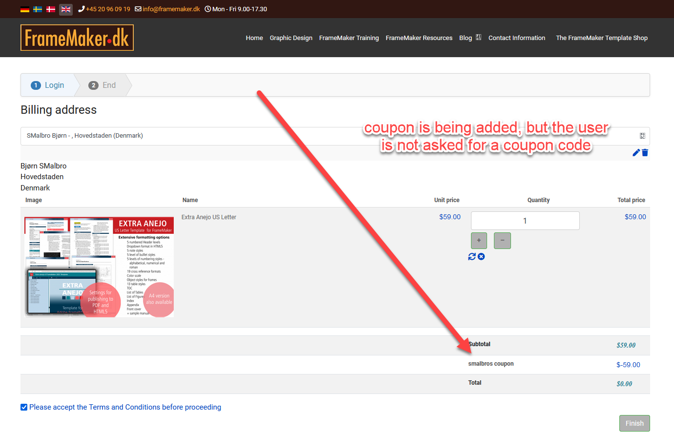

I have changed the coupon setup to not use autoloads. (Coupon setup no autoload)
On checkout the coupon IS subtracted from the checkout sum, but the user is not prompted for a coupon code.
I would expect the user to be prompted for a coupon code, which would release the discount.

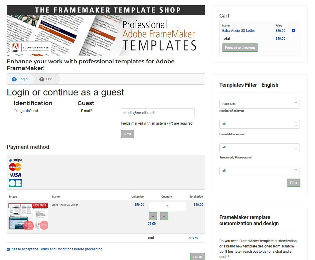

I am completely unable to make a coupon input field appear. I was expecting something like in the attached screenshot, but it is it even possible? Are my expectations just wrong? Is it not possible to have a permanent coupon code field visible?

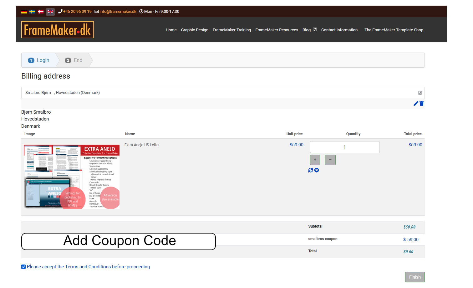

2 years 2 months ago #361737
If you have already your coupon block in your checkout, reproduce this settings screenshot (by adapting it here or there to your needs of course, dates, discount, category etc!).
As a result you should see this:
If everything is define as showed in my elements, your coupon should normally produce the same effects, IF the conditions/restrictions comply with the contexts, products, dates but also and above all the ACLs, because if your test account does not correspond to defined ACLs then the coupon will not appear.

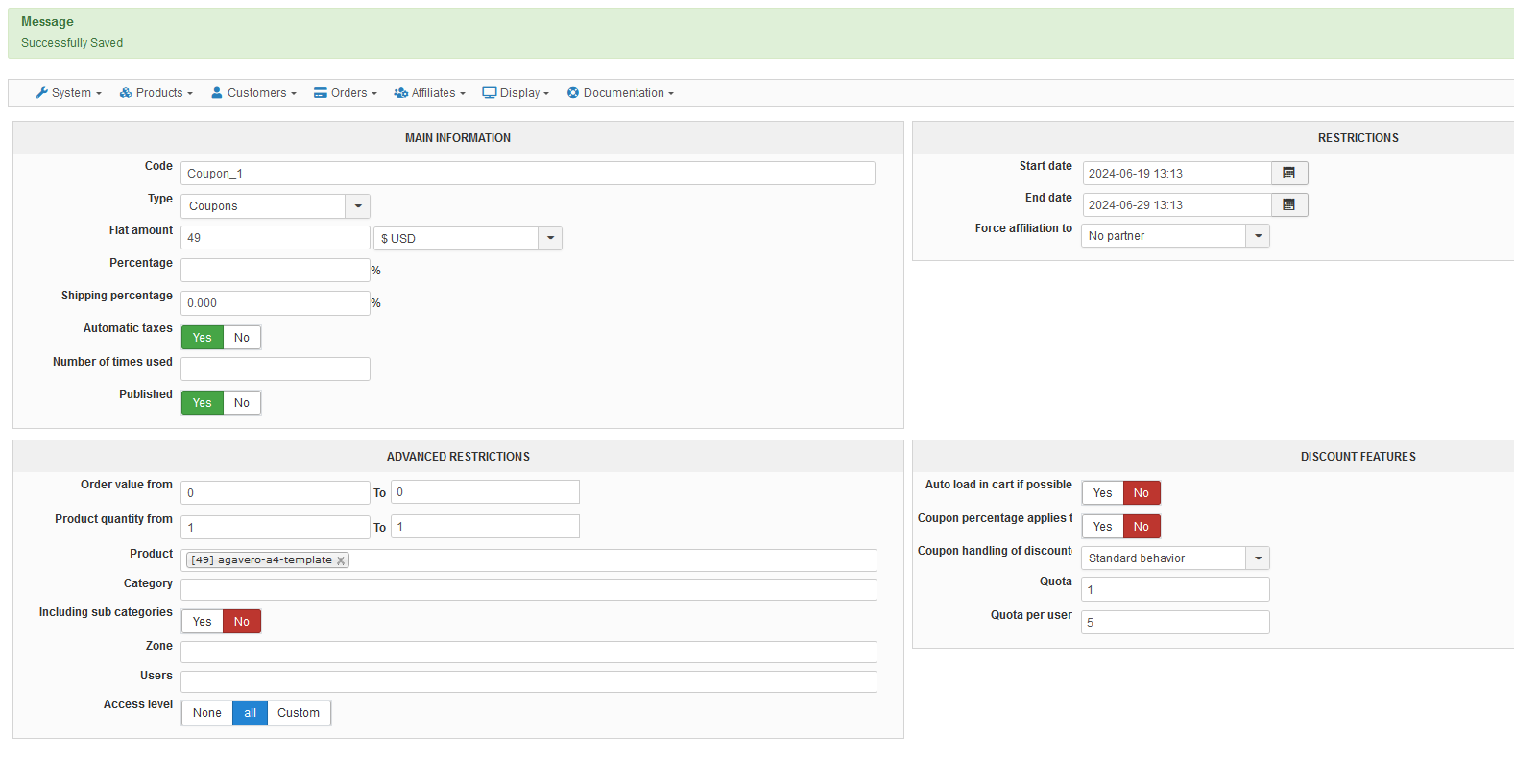

2 years 2 months ago #361746
Thank you for your answer. My main issue here is not getting the coupon field in the cart.
In the screen dump you have sent me, there is a coupon field. I am unable to make that coupon field show. I have added screendump of the checkout configuration, the coupon code configuration and the cart.
Best regards
Bjørn Smalbro
  • Posts: 86080
2 years 2 months ago #361750
There is nothing wrong with your setup.
The problem is that you've added custom CSS code in order to hide the coupon view area on your frontend:
i.imgur.com/CIbw64Y.png
So you need to remove that display:none; CSS command from your HikaShop frontend_custom CSS file:
i.imgur.com/IOKpkGO.png
The following user(s) said Thank You: framemaker
